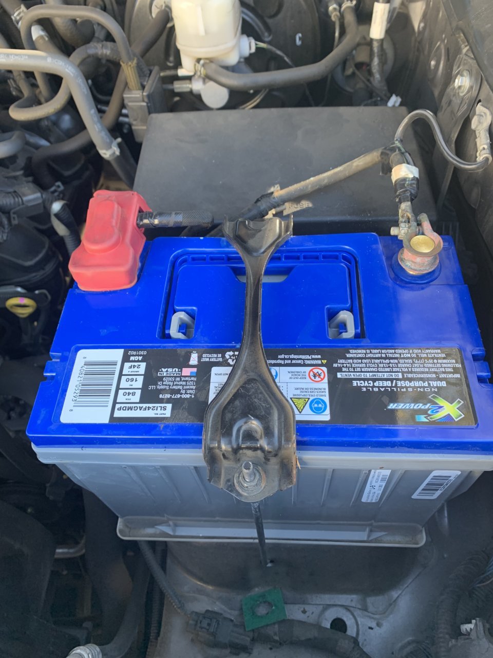

    No worries. May have to get some different battery Tie downs as it was a tight fit putting that back on.

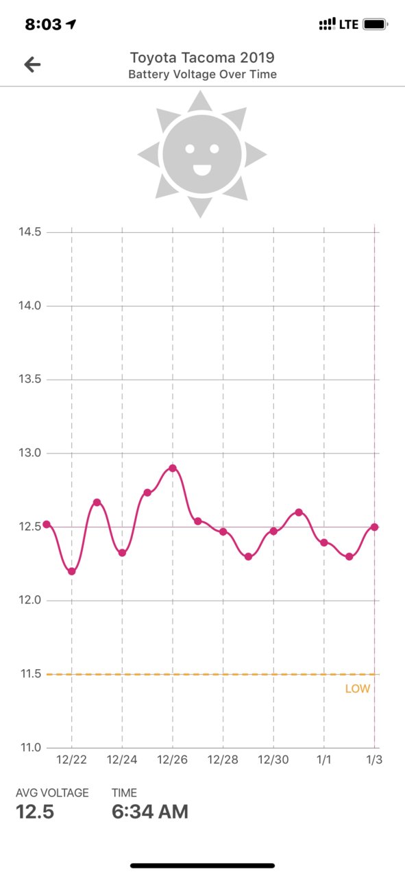

    My truck (and the stock battery that came with it) is only a year old, but I run a dash cam with parking mode that will drain it down to warning level if I don't drive it for a few days. I am reading threads and sorting through options, but any suggestions would be appreciated.

    I am starting to think that buying a charger is my best first step. I can keep all the family's vehicles' batteries tip top. Maybe with a regular topping off my OEM battery will last a long time. If my OEM battery gives out, I can replace it with an AGM battery, and will already have the charger.
    I will do some searching, but while I am posting, what are the good chargers? I see one specific charger recommended so far in this thread.
