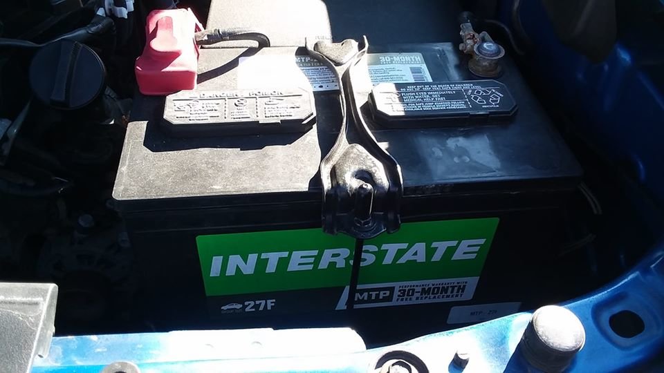

    Sorry to resurrect an old thread but is there any reason why everyone is using a $55 factory tray to use a group 27F battery instead of buying a regular aftermarket 27F battery tray for like $8-15? I mean like I like factory parts but I’d like to save that money if I can. Any info would be greatly appreciated.
    shakerhood likes this.
  14. Jan 7, 2021 at 12:54 PM
    #94
    shakerhood
    shakerhood Well-Known Member
    Aug 9, 2015
    #161370
    37,040
    Southern Ohio
    2017 MGM DCSB Off Road, 6 Speed MT, P&T
    I would assume because the factory one is a direct bolt in with no modifications. Guessing the generic aftermarket one would most likely need work to make it fit.

    Old thread I know, but after 4 years on the OEM 24F I bought the OEM 27F 2nd gen battery tray for $28 a few months ago as I knew my battery would soon be 4 years old and on borrowed time. So yesterday I checked my 24F and its was 100%. My luck it would die soon so off to the dealership and bought a 27F Truestart with a 2 year/ 84 prorated warranty. I got the battery for $130 and put it in this morning. Went in just perfect, lots of room, no issues and I can say it starts so much easier and seems to start quicker than my 24F. I know it may be in my head but maybe the orginal battery was on its last leg, didn't want to chance it as I know the time would come it wouldn't start, nice piece of mind now!
