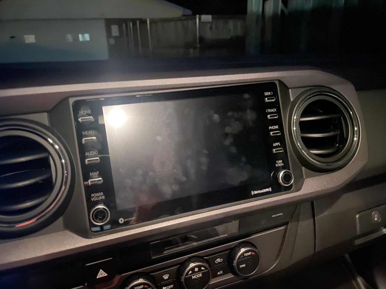

    Pic of my radio if that will help identify what I have and the dash kit needed to replace it:

    Not sure what you mean exactly. Bought the truck used 9 months & 4K miles. For verifying what radio I have I measured the screen and verified it on a Toyota VIN checker but it gives me no real information.
    Not sure what invoice you are referring to but I don’t have a window sticker or any other info really telling me much.

    That’s correct, I know for sure I don’t have JBL. But I have a screen that looks identical to that. I was under the impression the higher end models had CD players but maybe that’s a change Toyota made that I was unaware of.
    I’m mainly trying to figure out what dash kit I need to fill the large void in the end (if one exists), and then if anyone had any hiccups using the maestro kits I listed above to adapt everything.

    2020+ radios do not have a CD player, no matter what spec the radio is. I have a 2021 TRD OR with the 8” Premium (non-JBL) and it looks identical to yours with no CD slot.
    Easy to tell generation of these radios (if they have physical buttons they’re from 2020 onward and won’t have CD but will have CarPlay/Android Auto). Older units have capacitive buttons, at least an option for a CD slot (not sure if all came with one) and no CarPlay).

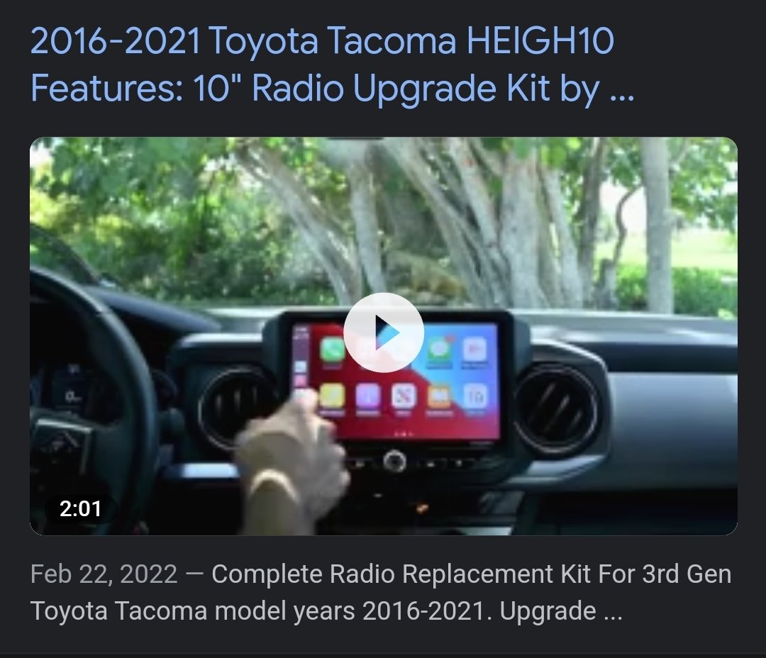

    Another option FWIW is the T10 (android unit) from Cartrimhome. There’s a bit of a Tacoma following on it. We put a T10 in our Sienna and it works well with CarPlay. Thinking about putting one in my 17 Tacoma…. But dang the gas prices and inflation are eating into the ‘fun fund’ ….
