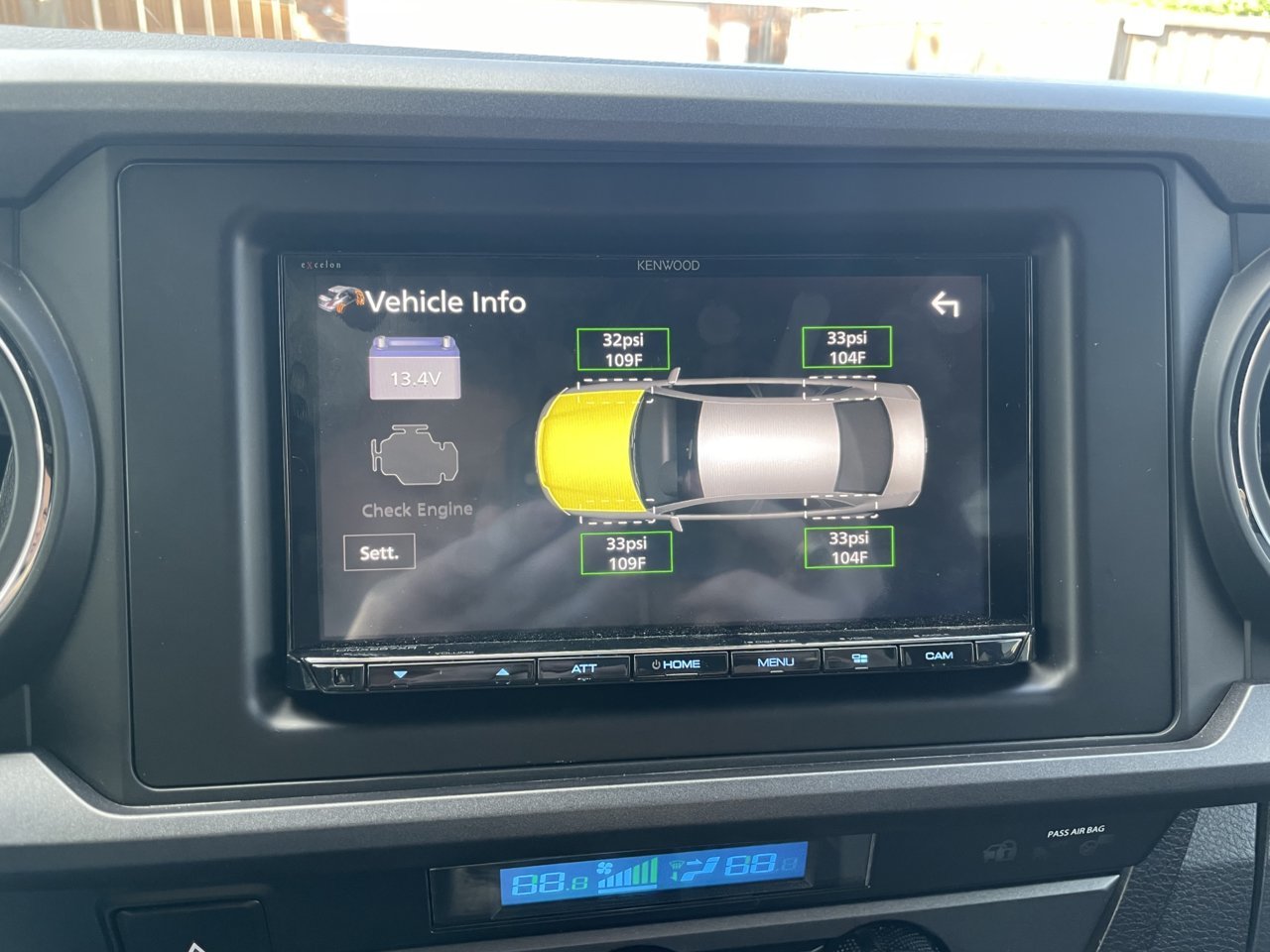

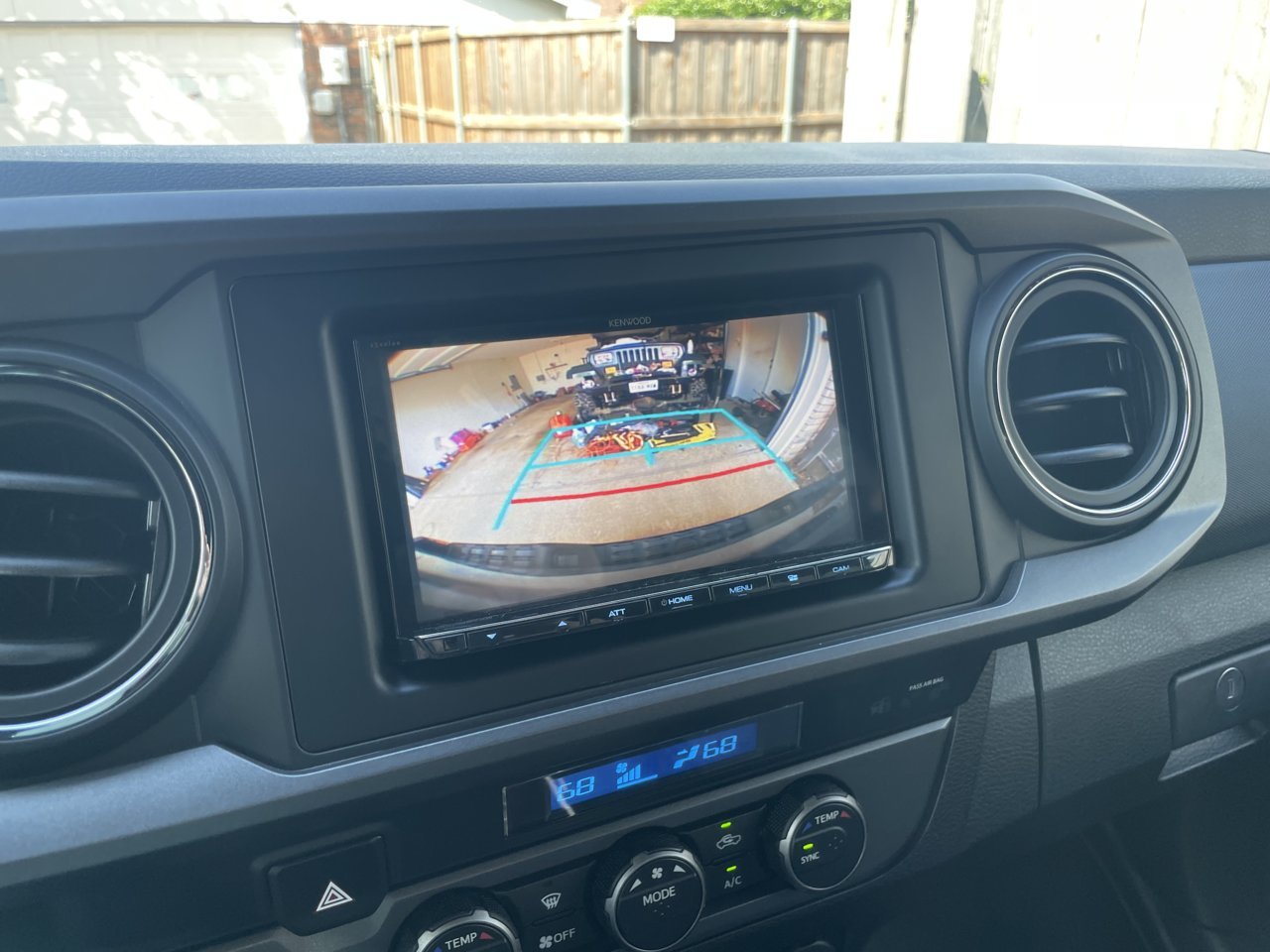

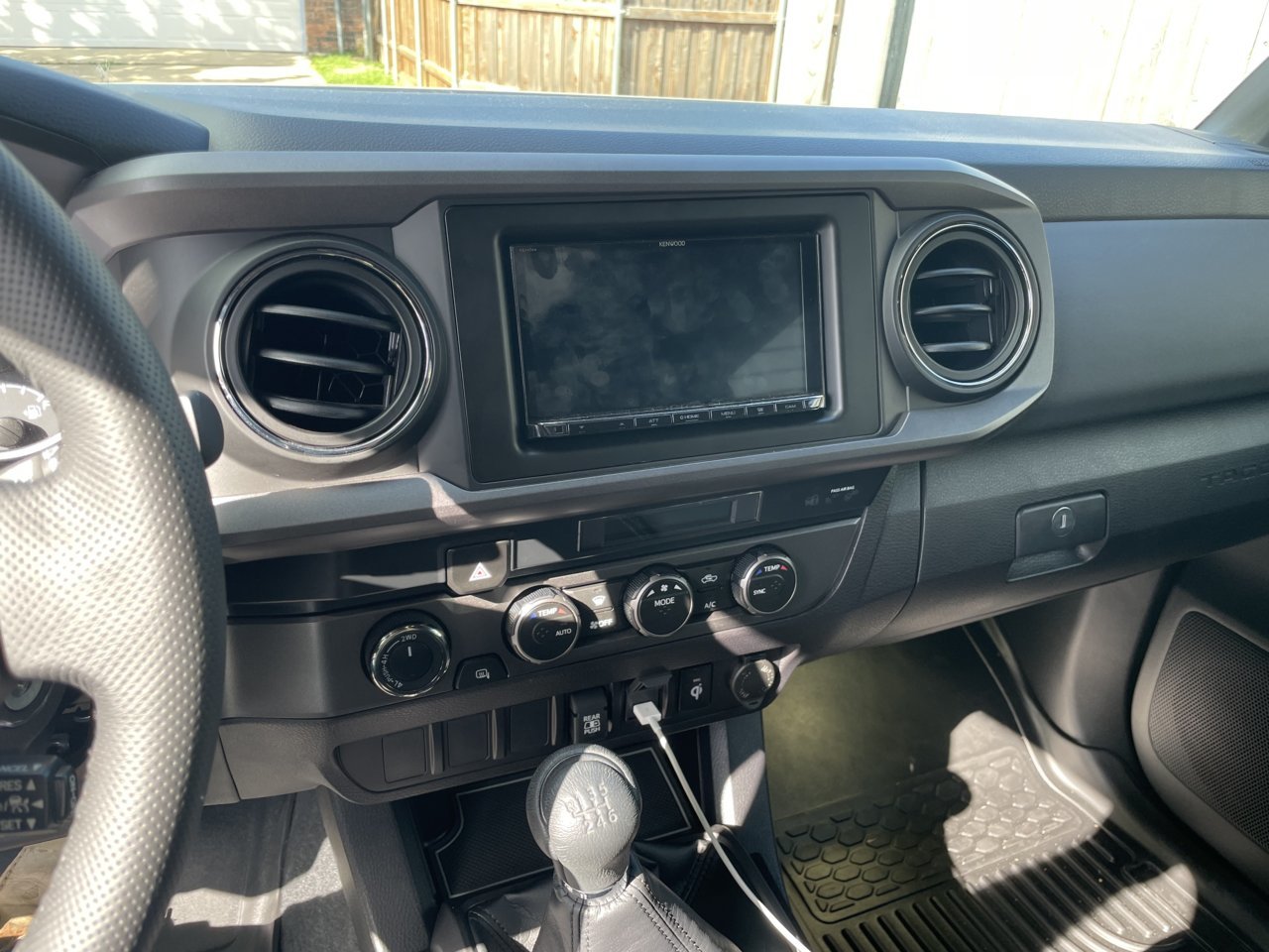

    All done! Honestly looks pretty factory for an aftermarket radio. I adjusted the button colors to try to get them to match the dash as close as I can, so they are a cool blue. Not perfect but close enough. The results turned out great and I’m glad I decided to dive in. Now I know the ins and outs and can clarify what’s necessary for others with the same years. I think it’s awesome that I still have full control of vehicle settings and it will still tell me what doors and hood and such are open as well.

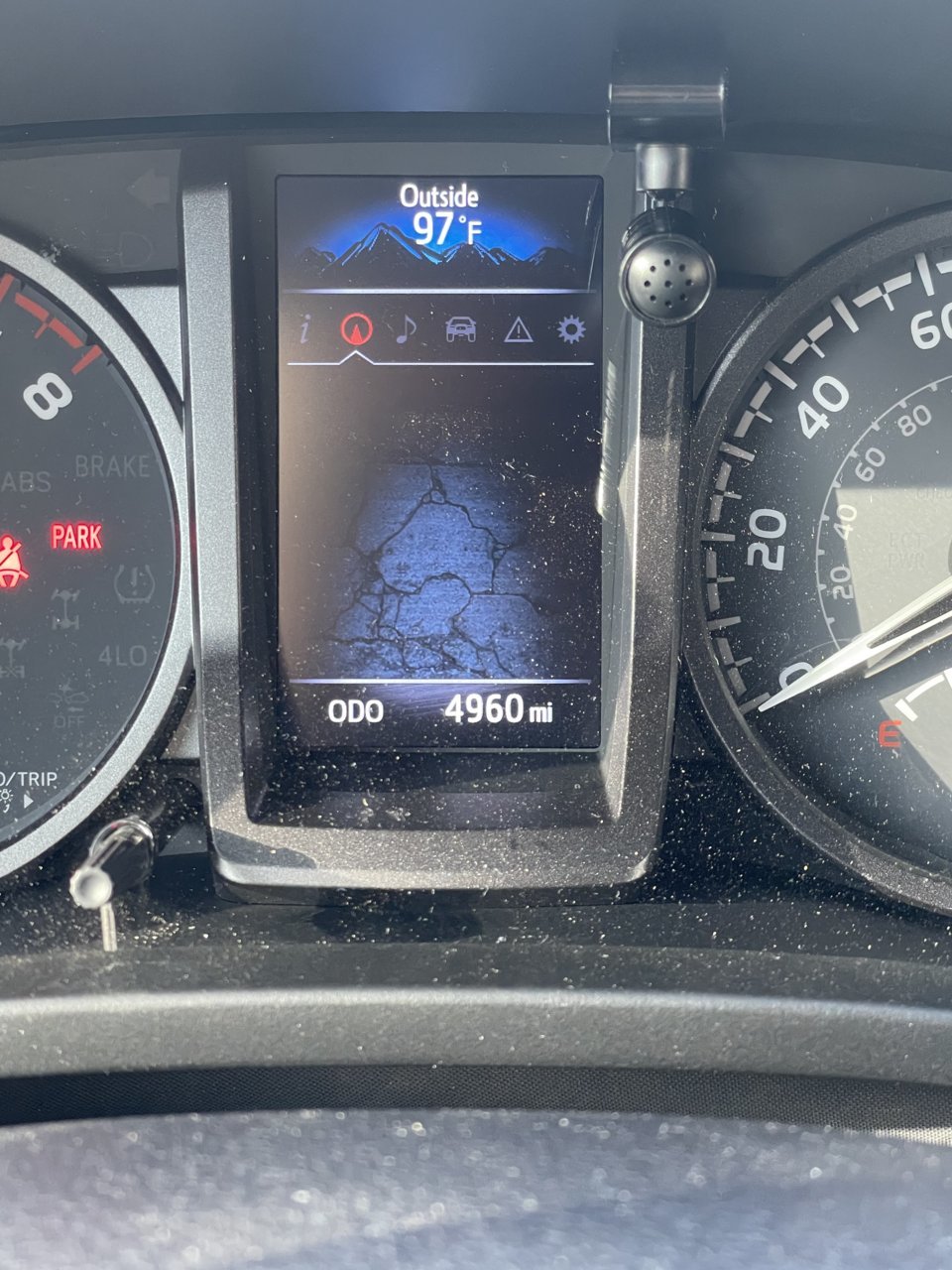

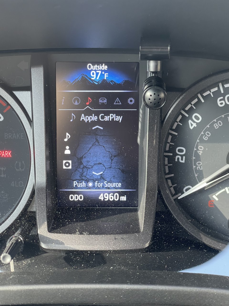

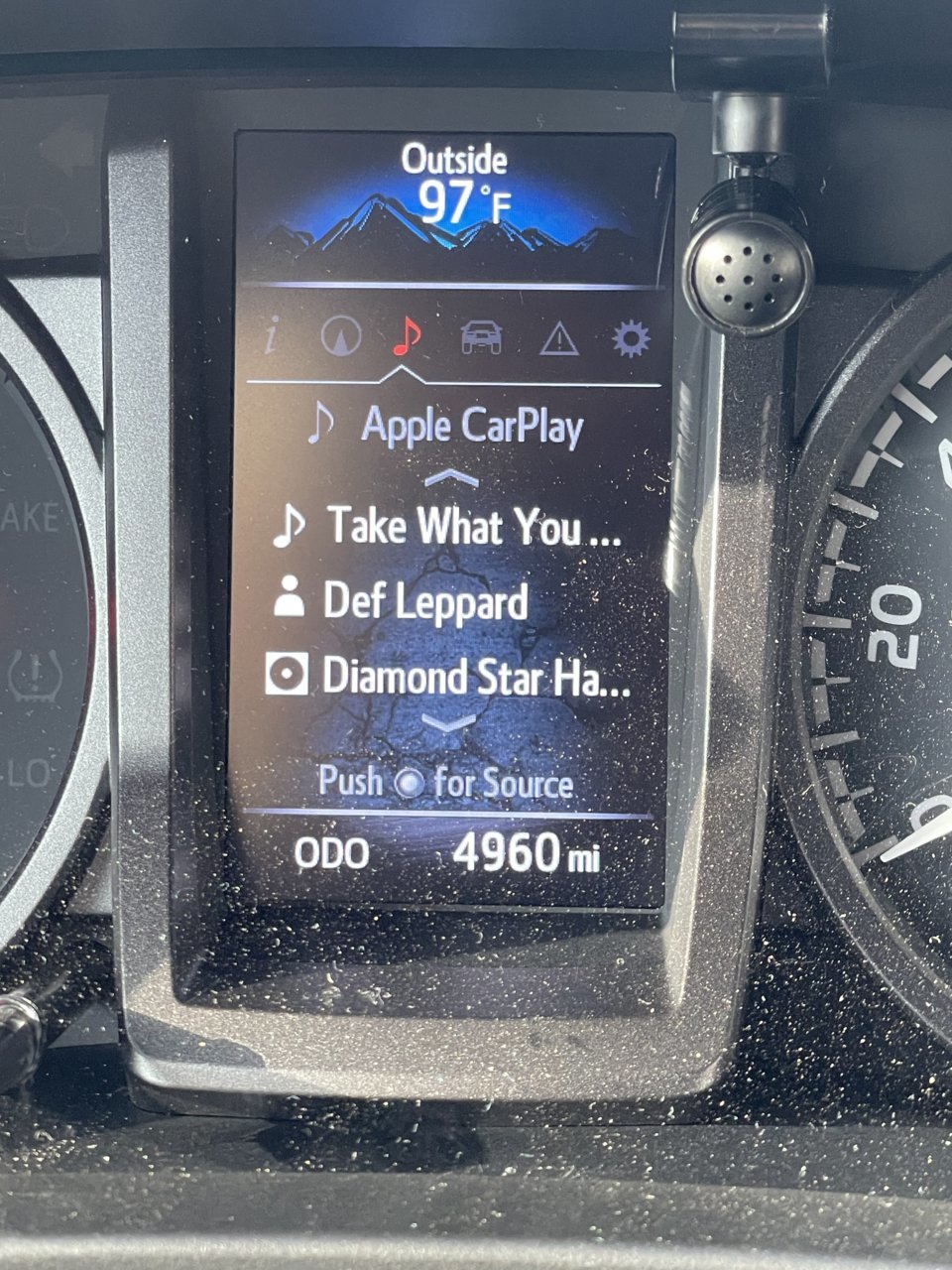

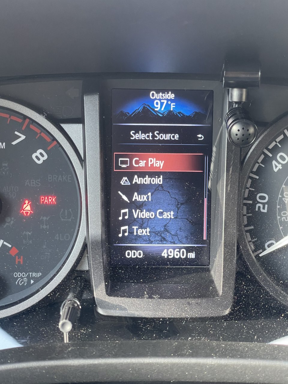

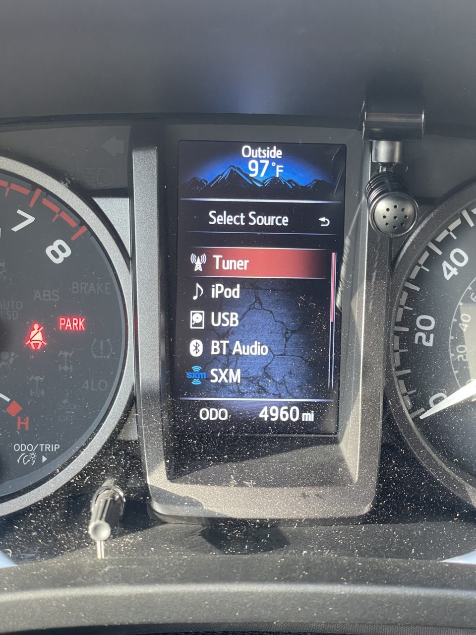

    Here’s some more info on the music screen on the cluster. It lets me choose a source to control/view, so I selected CarPlay since that’s what I use.
    1C1741E4-17E5-405A-95BF-183F993F6F79.jpg 111C3132-9D27-4E50-93EF-6329F266B26F.jpg CC2D9798-23E5-4AB2-983C-81647F69AD6A.jpg
    When a song is on, I can see the song, artist and album. They are a bit cut off and don’t scroll, but whatever. When I am in this view with the song showing, clicking up or down (on the right side directional pad, not the left volume/seek pad) will change songs. Up will go to next song, down will restart the song and go to the previous song with an additional click. Probably won’t use that much since I have SWC on the left side of the wheel, but cool regardless.
    The Nav screen is still on my cluster, but still useless/blank. No big deal, it’s no different than it was stock with no Nav anyways.

    From the factory, I have the Nav and music screens on the dash. Neither of them showed anything. My radio had the Nav app but no Nav would work when I’d open it. It kept telling me to go into the Toyota owners app and add the feature to my truck, which I definitely could not figure out.
    when I swapped my radio from stock to Kenwood, along with the Maestro RR to adapt everything, my music section in the dash started working. The Nav is still an empty section on my dash. So I have 6 sections on the dash, now 5 of them work instead of the 4 that worked before.

    Music started working on mine when I went to the aftermarket radio. I’m guessing the maestro is sending that info to the dash whereas the stock radio wasn’t. I imagine from the factory that only works depending on what radio you got. Aftermarket the maestro is probably set to do that for all of them.

    It is very likely transmitted over CANBUS. That is how radios and tcase modules and the cluster and all that type of stuff usually talk to each other. My guess is some stock radios output that information on the CANBUS circuit and others do not. You and I got ones that don’t, but the maestro I upgraded to does so that it can provide the feature in other models that had it stock, which naturally adds the functionality to my truck which didn’t have it originally.
    Just my guess anyways.
