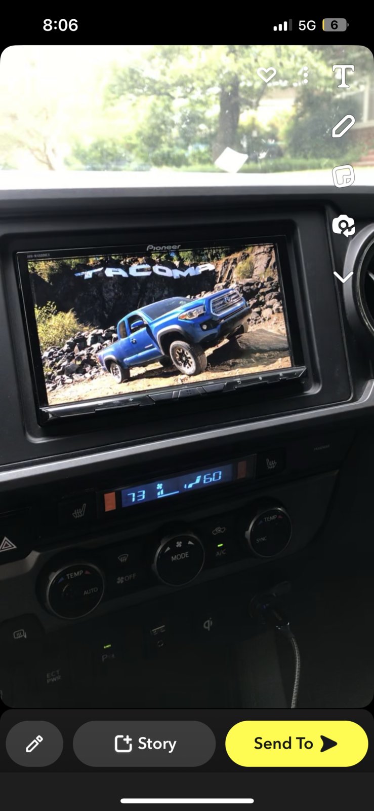

    If I could go back in time and find this thread (and you felt like spending $$), I’d recommend the DMH-WC6600NEX. Cleanest looking install in my opinion. I had a 4600NEX, but the rattling drove me crazy.
    this:
    To this

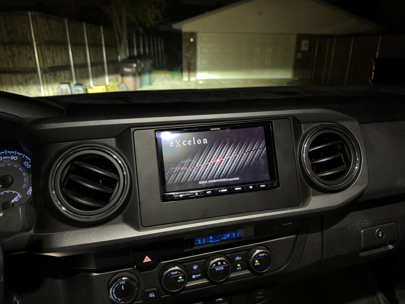

    I brought over the DMX957XR from the Frontiers. Which it fit really well in those. So I used it initially in the Tacoma and then eventually when I upgraded to the DMX958XR (mostly for faster 3A USB charging which vast majority of radios don’t support), I decided to stick to what I knew. So what’s why I went with the 958, including the charging spec.
    I’ve seen the Pioneer and it does look nice but I’m not unhappy with the looks of what I’ve got either. I don’t know what it’s worth but the audio shop I bought the 957 from originally really pushed Kenwood over Pioneer, JVC and Sony. I’ve used Pioneer with no issues in my Jeep so I personally have no complaints with them, but when I mentioned Kenwood to the audio shop they really seemed to think KW is the best so that helped secure what I was going with.
