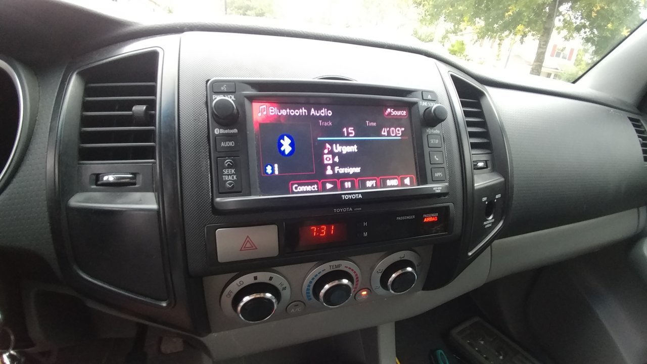

    Scion Radio Interior LED Chromed Vent Knobs Chrome Shift Knob Temperature Dials

    What radio did you use? What extras did you need? Did you hook up backup camera to yours? Looking to do my 2011 base and utilize my stock camera that has no monitor

    This radio came from a yaris. I took an original black radio, cut the face out and stuck the radio instead. Power and speaker connector fitted right in.
    https://www.ebay.com/ulk/itm/123201980074
    Used this microphone and mounted it by steering wheel.
    https://www.ebay.com/ulk/itm/122657624964
    I am still hunting for camera and harness but it has connector in the back.
    For usb thumbdrive I used this cable
    https://www.ebay.com/ulk/itm/231614229161
    Also needed this connector for 28pin input in the back.
    https://www.ebay.com/ulk/itm/292533812872
    You need this one for power steering controls and microphone.
    Finally this one for antenna
    https://www.ebay.com/ulk/itm/192476347389
    Since mine is a 2007 it didnt come with camera but looking for one so I can retrofit.

    Would you post up a final when you get a back up camera installed etc... please? I have a 2006, still with a stock radio and CD-player.... Ha!
    I'm starting to research what it will take to modernize, and i'd like a back up camera and modern connectivity...
    Thanks~

    That stereo looks exactly like the one in my FR-S. Are you sure you can get video out of it?

    Ill find out soon.. It has the connector, this one came from a yaris and I think it also comes with the IQ but I believe its the same as your frs.. I am confident it will get video.. I ordered the connector already and have a regular camera to test with.. Will post findings.. Only problem is that the connector id coming from china.. Meaning it will take a few weeks to find out

    :facepalm: Seriously.. you spent all that money on doing everything but couldnt splurge for the $25 or less dash kit....

    I actually have 2 dash kits I cant use. The dimensions of the hole dont match with the OEM radio. If you compare a toyota OEM radio vs an aftermarket you'll be able to see why I cant use it. Thats why I had to use the face of an original radio and cut is as close to fit as possible. This radio is slight wider and shorter compared to an aftermarket.
