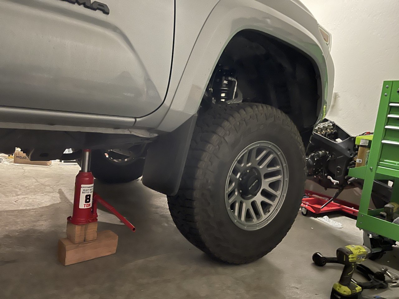

    New uca seem to have really helped down travel. I’ll get a better pic later. But one side is done!!
    I asked a local fb group what people used for jacks and they called me a moron. Still not sure what the right way to do it is. I refuse to go under the lca. And a jack under 2 pieces of 4x4 is barely enough

    Thought about this instead

    That definitely would work too. The only reason I linked the one I did is that one is considered heavy duty and says it is built for 5000 plus lift cycles which I figured should last me forever or at least a real long time.

    I guess I just need to measure the height I need with my setup and go with the highest rated that gets the wheels off the ground

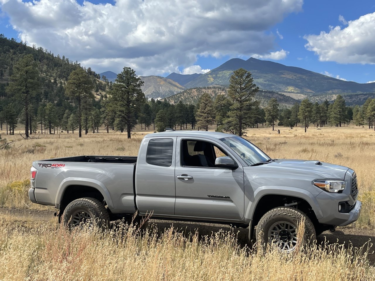

    Great success. Exactly what I hoped for. Much better ride off road. Still fine on road with no sway bar on click 3 (there are 8 clicks #1 being softest) again I have nothing to compare to outside of the stock sport suspension but this is definitely better.
    I did have to re tighten the uca bolt. It came loose. I started to hear like a bell sound on the trail lol. The washer was acting like one. Luckily I brought some wrenches with me so no problem. Checked the torque on everything else after I got home and nothing else got loose. I’ll attribute it to install error :rofl:
    I’ll try to get an alignment week after next. I’ll throw the numbers up so we can see how these UCAs do.
    overall I’m very impressed with these rough country parts esp for the price.
