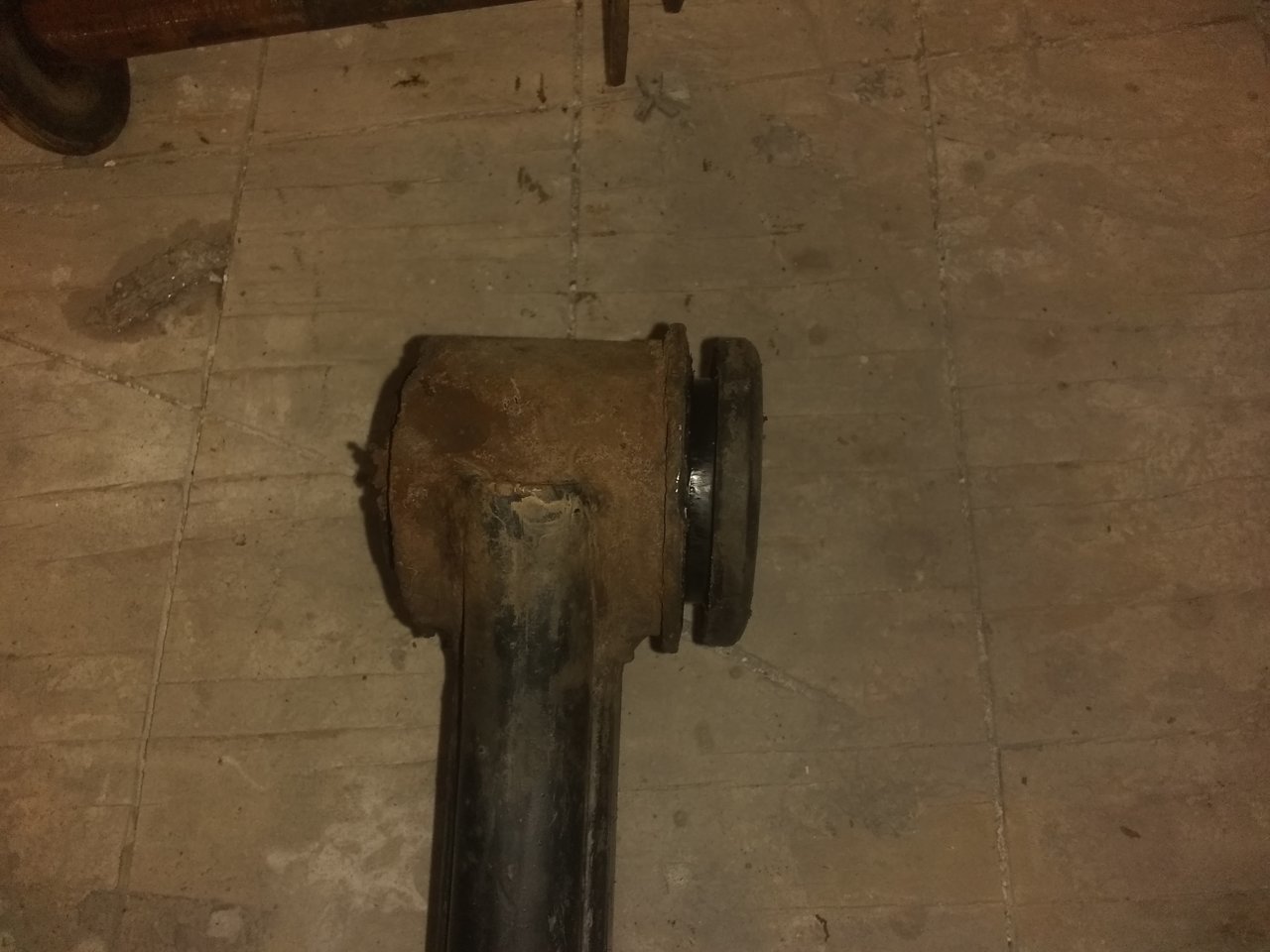

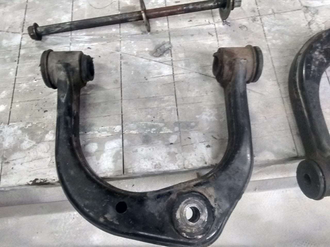

    I have to replace the upper and lower control arm bushings on my 1998 Toyota Tacoma sr5 v6 4x4. I bought and replaced the LCA's about six months ago and the bushings have already gone bad. This is why you do not buy chinese parts. For the upper control arm bushings I am going with the Energy Suspension polyurethane bushings and I will reuse the outer metal shell that is on the existing bushing. For the lowers, I am going with the whiteline bushings and will completely press them out with a bottlejack.

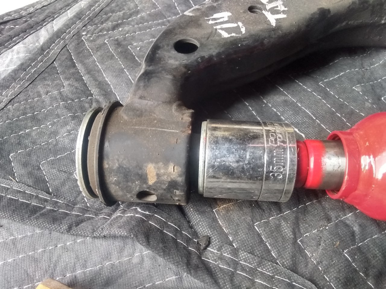

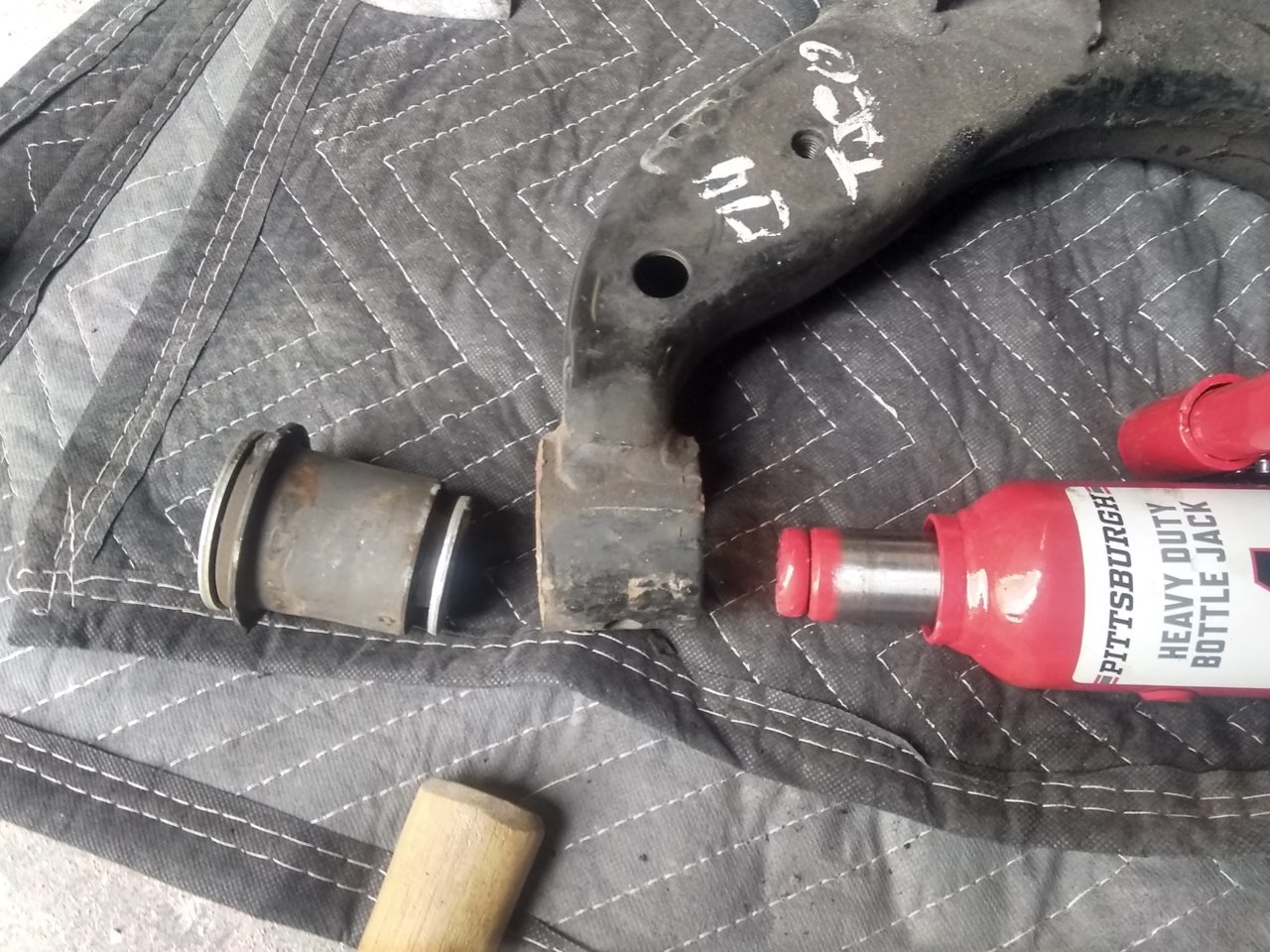

    To start: I had the LCAs off of the truck already, so I went to harbor freight and bought a bottlejack for $15. I combined that with a 35mm socket and preloaded the jack. I then tapped the lca with a hammer until the bushing popped out. IMG_20201217_144834574_HDR.jpg IMG_20201217_144857238_HDR.jpg IMG_20201217_145016692_HDR.jpg

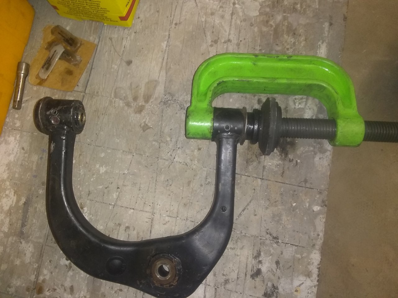

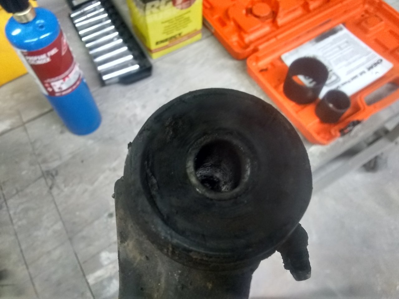

    For the UCA bushings, I removed the UCAs from the truck and used a ball joint press and a torch to press out the old bushings.
    IMG_20210117_144021625_HDR.jpg IMG_20210117_144101966_HDR.jpg IMG_20210117_144144287.jpg IMG_20210117_164915618.jpg
