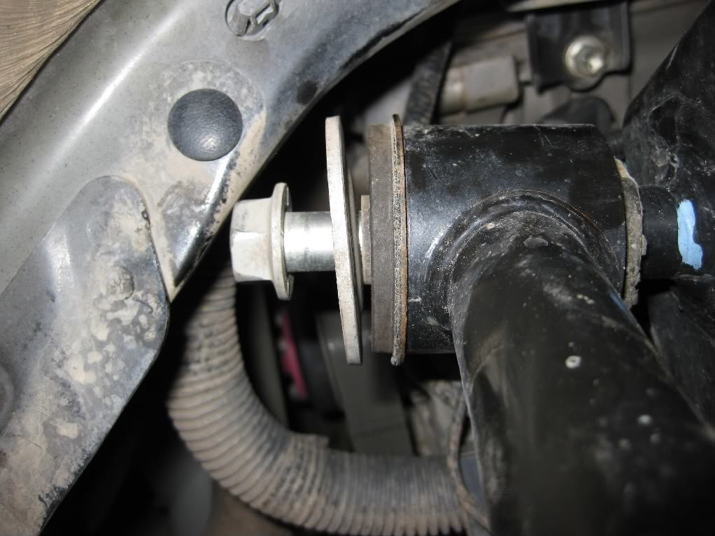

    Does anyone know what upper arm bushings should be torqued to? I think i over tightened mine and now the shifts on my truck seem a lot ruffer, or atleast i notice them a lot more. So what torque, or how do i know if they are too lose or too tight?

    No just the nut that runs accross the UCA, it is the nut you would need to remove if you want to replace the stock UCA if that makes sense.
    Here's a pic

    Just got the pic, I'm checking
    If it is the UCA to frame bolt/nut then it's 85 ft-lbs for a prerunner

    No i dont think it's the UCA to frame bolt.

    85 ft.lbs

    Yup, 85 ft-lbs or 115 Nm is what the Haynes repair manual has for a prerunner. Hope that fixes your problem.
