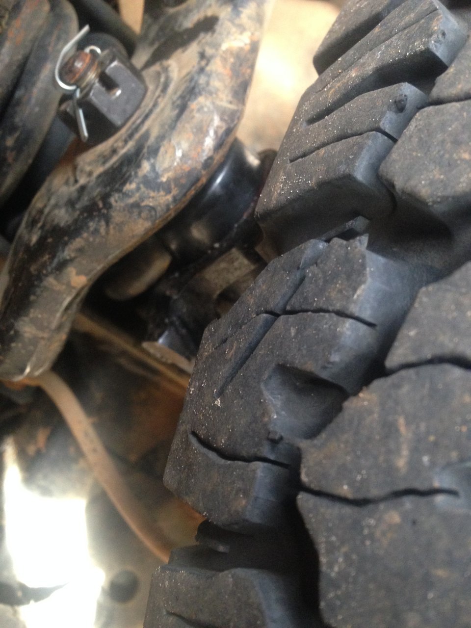

    I damaged an upper ball joint boot on my 2001 Tacoma. Does anyone make a universal slip over boot? The joints are less than 1 year old and in good condition.

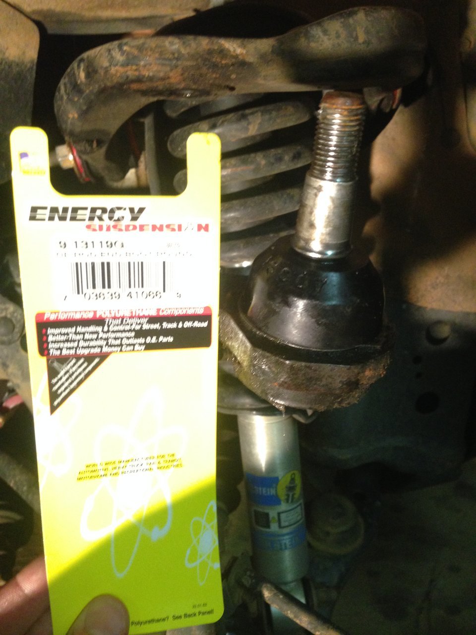

    Just for reference. I went and measured an upper ball joint today with a digital caliper. I got ~17.5 mm at the largest point of the stud and ~43.3 on the body of the joint where it goes through the spindle.
    I ordered energy suspension 9.13119 part number and we will see how this goes...

    For those wondering, it did work! Took me about 15 min to get it done.

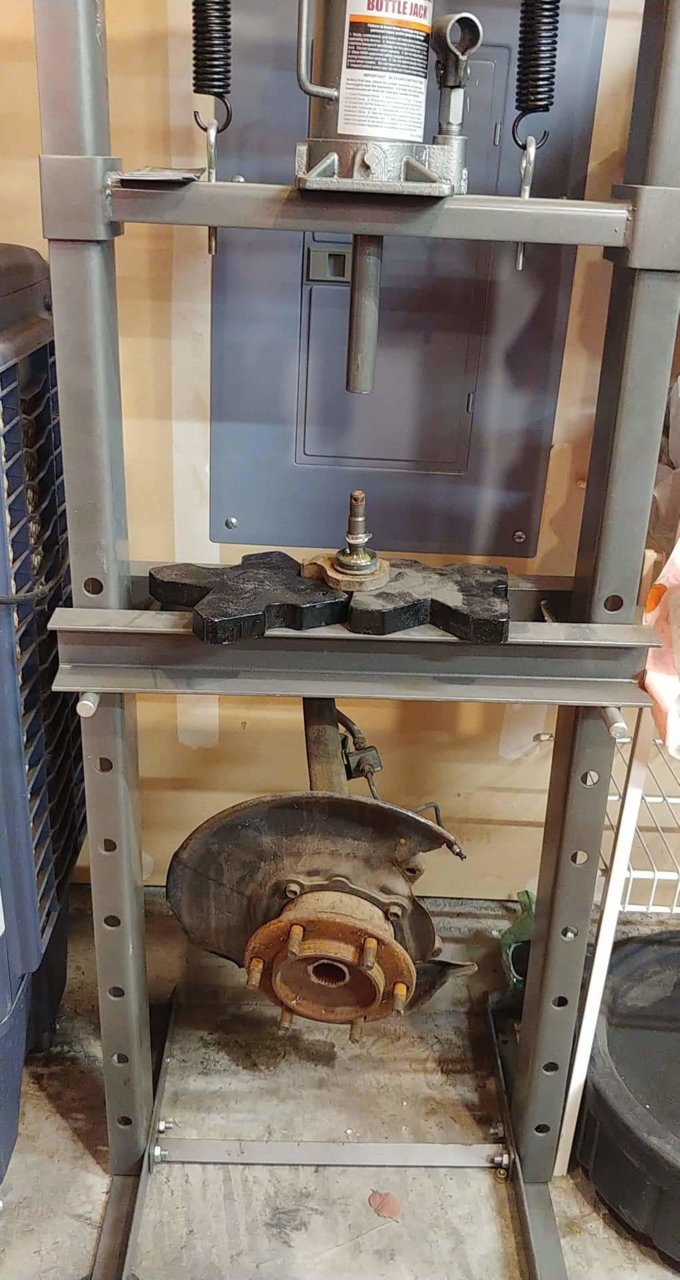

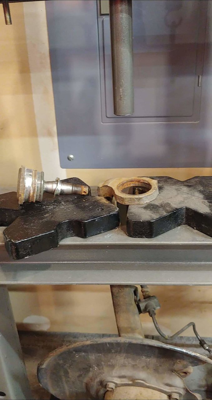

    3435 E Trent Ave, Spokane, WA 99202
    It's less Tacoma and more mod
    I just send it in the vertical press. Couple pumps and they fly right out
