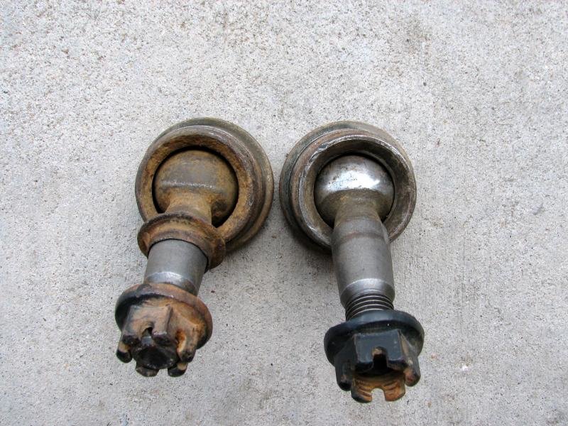

    Watch for torn boots on those UBJs & LBJs especially in a deep mud/high water environment such as I routinely operate in. The factory grease washes out VERY quickly once the boot tears or even leaks. My TACO stays coated with thick mud for 8-9 months of the year. By the time I noticed the UBJ boots were torn/leaking, the factory grease had washed out & both OEM UBJs were worn to the verge of failure (below). I started using a marine EP grease on both the UBJs and the LBJs so the grease will not wash out nearly as fast when the boot leaks/tears. AFAIK, Toyota does not offer a LBJ boot kit, just the boot kit for the UBJs. But on multiple occasions, I have successfully fixed small holes in LBJ boots with Permatex Ultra Black. Just degrease the boot around the puncture then apply the Ultra Black. Ultra Black repairs on the 555 greaseable LBJ boots lasted several years. The boots on the 555 greaseable LBJs were not nearly as thick/durable as the boots on the OEM Toyota LBJs. For that reason and others, I went back with OEM Toyota LBJs on my '97 TACO 4X4 just last month. .02
