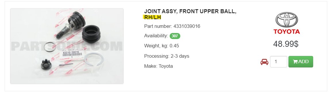

    quick question, I just wanted to know if the Upper Ball Joints for my 98 Tacoma are side specific?
    I mistakenly ordered two front/right's instead of a Left & a Right. got them through Toyota, they both look the same but I figure I should consult the internet before proceeding here.
    Thanks

    I don't believe they are side specific (uppers). LBJs, absolutely.

    UBJ’s not side Specific
    LBJ’s are side specific

    Dating back all the way to 95 to 2004, it's the same ball joint across the board. They are not side specific and are used on multiple models.
    https://partsouq.com is your friend - not just for parts but part reference.
