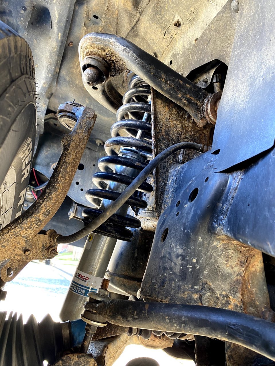

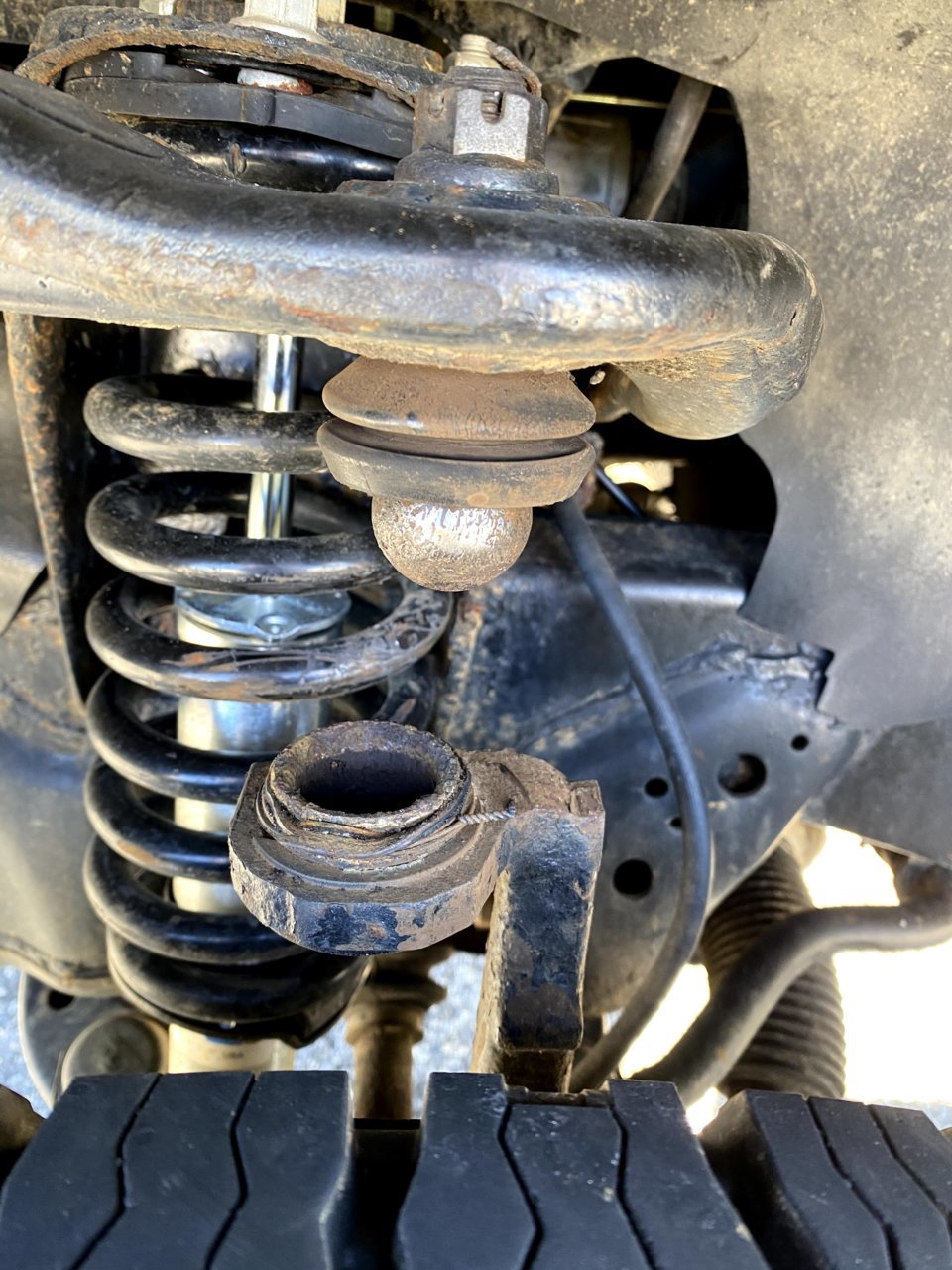

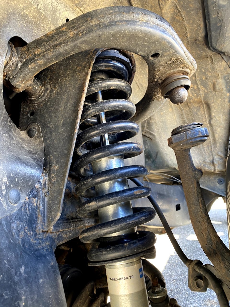

    Last night, I was driving the truck and the UBJ popped out after I hit a massive bump in the road... The ball itself popped out of the joint, It did not come out of the UCA. I do not know where to go from here because it is going to be nearly impossible to get the knuckle out of the upper control arm... Can't just use a hammer to tap it out because there is no tension pulling on it.

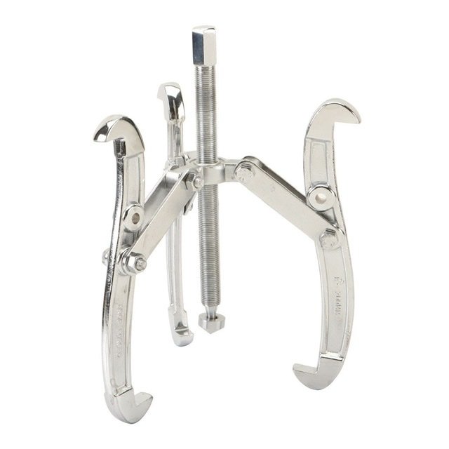

    This is all you need:

    I don’t think it would work out here with rust, but indeed.. interesting

    I think a 2 jaw will be better and easier.

    That third jaw might be beneficial as it would go in front of behind the control arm bend and the other two to the outsides, better stability to drive that sucker out. Again, cool concept, but how strong will it hold to the arm with those tiny “teeth” on the puller

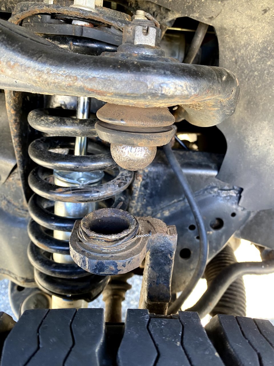

    That ball joint is worn bad . All those pitts in the joint didnt happen overnight
    Judging by the condition of the ball joint in the picture , I think it would be safe to say you should consider changing all 4 at this point . They are probably in the same condition . I would hate to see you get back in the drivers seat and have another one let go while you are rolling down the interstate

    worked for me, just need a stout pry bar between the new ball joint and the puller for installation
