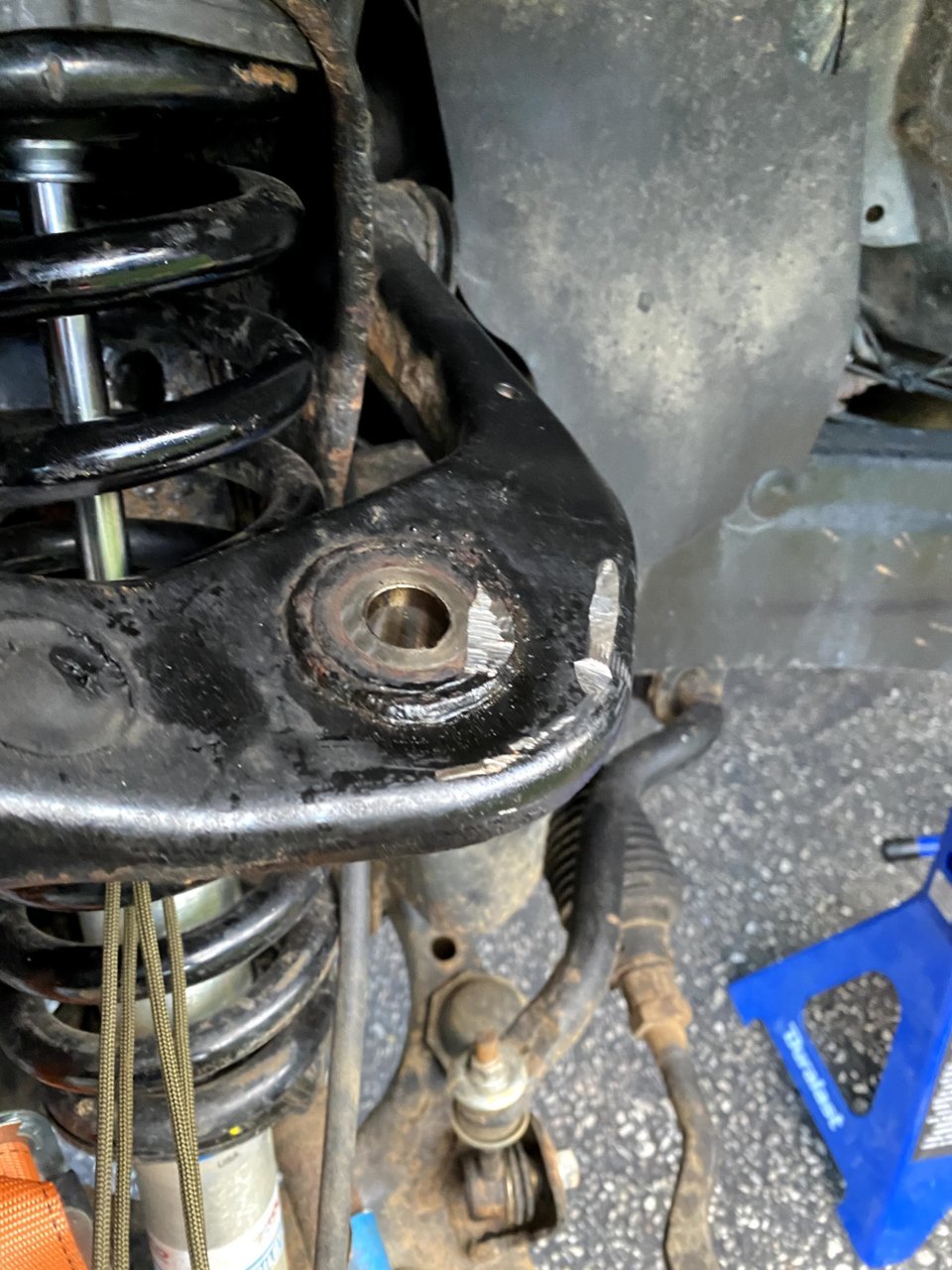

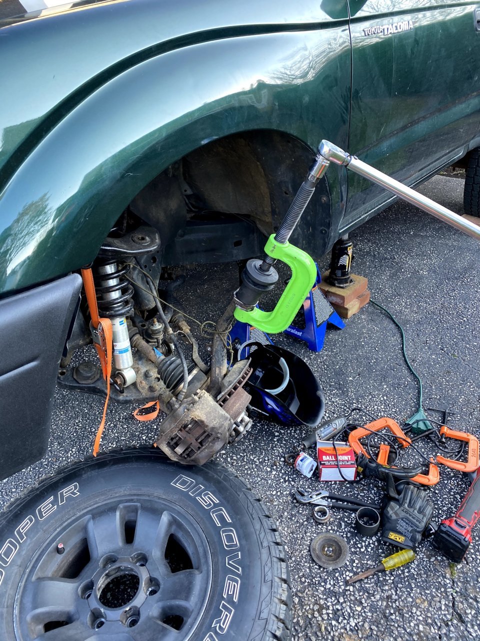

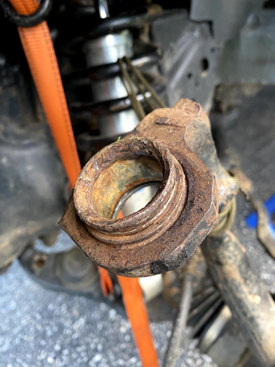

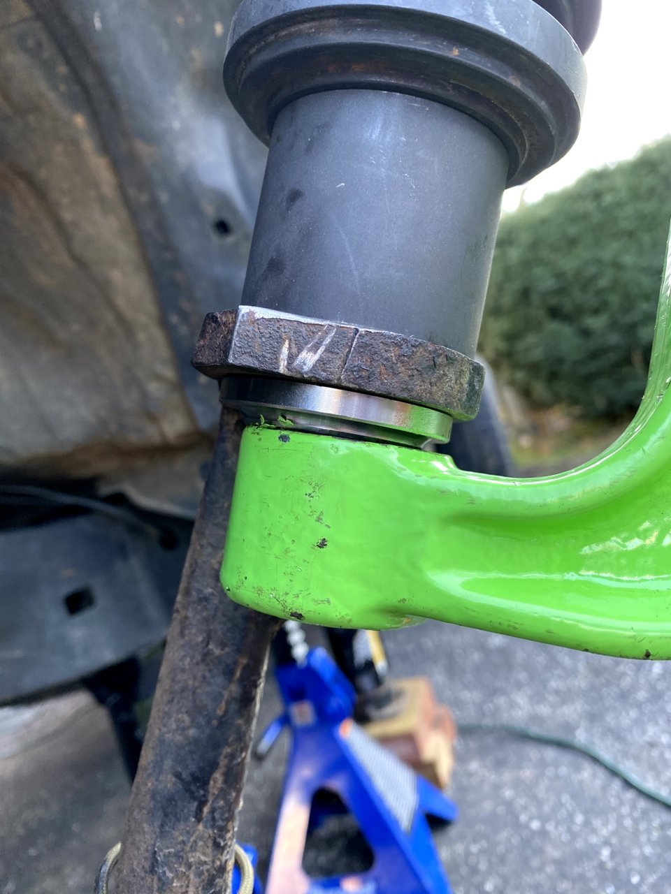

    She's all done. Ended up having to cut off the top of the old ball joint AND the lower cup that houses the ball. I attempted to press the lower section out (connected to the knuckle) and ended up putting a hole straight through it. Decided to say f*ck it and cut a nice notch in it with the dremel, then tapped it out real easily.

    I actually tried using a three arm puller. Didn't work for sh*t. Returned it and got a traditional c clamp ball joint press which worked perfectly. Now time to do the other three ball joints... when I find some free time
