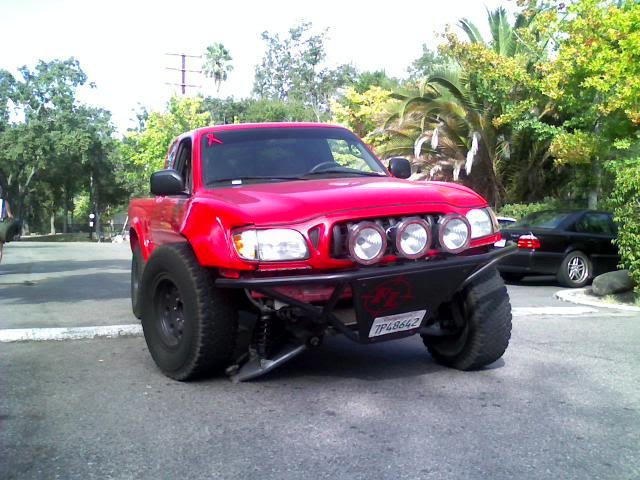

    ah yes... parking lot carnage. i had my old truck fall apart on me

    What broke there?
