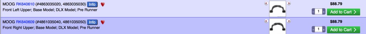

    I've replaced the upper ball joints with 555 from low range. The moogs I'm looking at are the UCAs only, no ball joint.

  7. Apr 26, 2021 at 5:20 PM

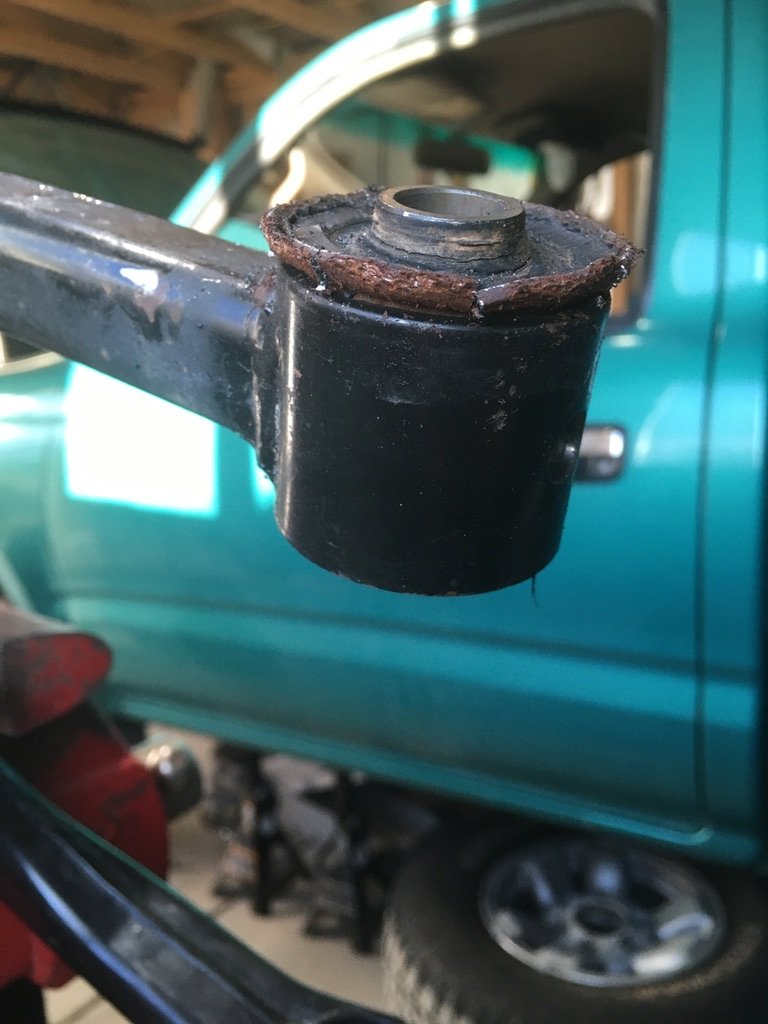

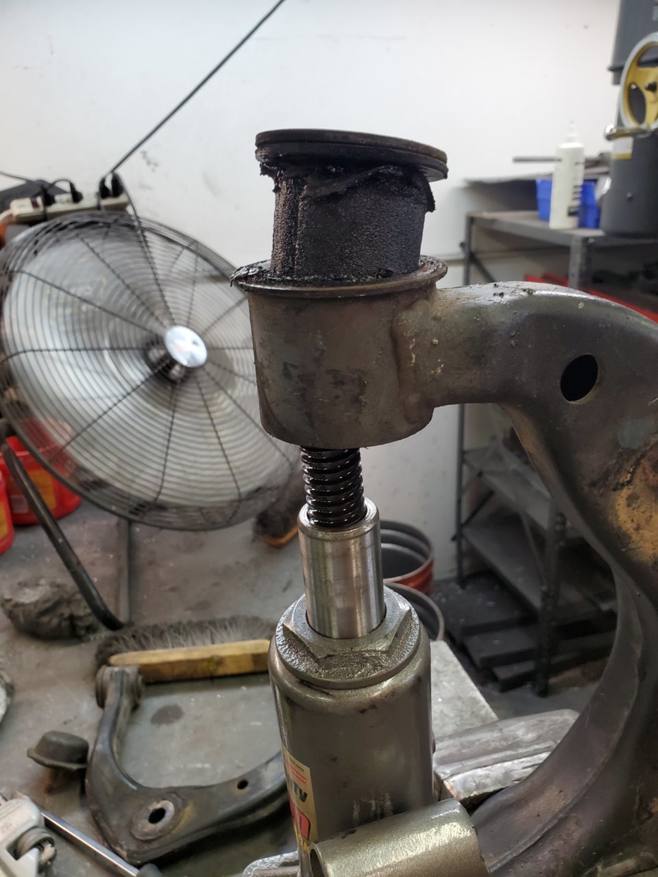

    I'm in the middle of doing my UCA bushings. I ordered the 4runner bushings (48632-35080).
    My original plan was to extract the old ones using the bottle jack method, but I ended up taking them to a shop after the realizing my bottle jack was too tall to fit between the sides of the arm. I wasn't happy with the shop's work (read about that here), so now I'm re-doing it myself using Timmah's bearing splitter method (here).
    Based on my experience:
    • The 4runner bushings ought to work fine. I don't have them on my truck yet, but they look identical to the originals and I've seen several other reports of people using them.
    • The Moog arms will probably be just fine, but the Moog bushings installed in them might not be as good as Toyota OE. Lots of opinions and not much evidence on whether Moog is good. I subscribe to the "my factory parts lasted 200k, why mess with success?" line of thinking.
    • Make sure you trust the shop to do good work. These arms are tricky to set up in a press because the bushings have to press outward and there isn't much surface area to press against. If I went to a shop again, I'd bring the arms in for the tech to look at and talk to them about the press setup before committing to the work.
    • The press method in Timmah's video has not been as easy for me as he made it look. I had a hard time bending the flange on the old bushing to get the bearing splitter seated.
    Between OE bushings, OE ball joints, re-work, and tools, I'm probably around $400 into this project. If I did it all again, I'd strongly consider aftermarket UCAs. For about $450 (less taxes and shipping) you could get JBA arms (although, they're high caster arms designed for listed trucks). For about $620 you could get SPC/Light Racing (adjustable, so you can keep factory alignment if not lifted). For maybe $400-450 (the price changes occasionally) you could get the Mevotech adjustable arms from RockAuto, which seem to be rebranded SPC (make sure you look for the adjustable arms; RockAuto also sells an OE-style Mevotech arm that's probably comparable to Moog). JBA, SPC, and Mevotech adjustable arms all include new ball joints.

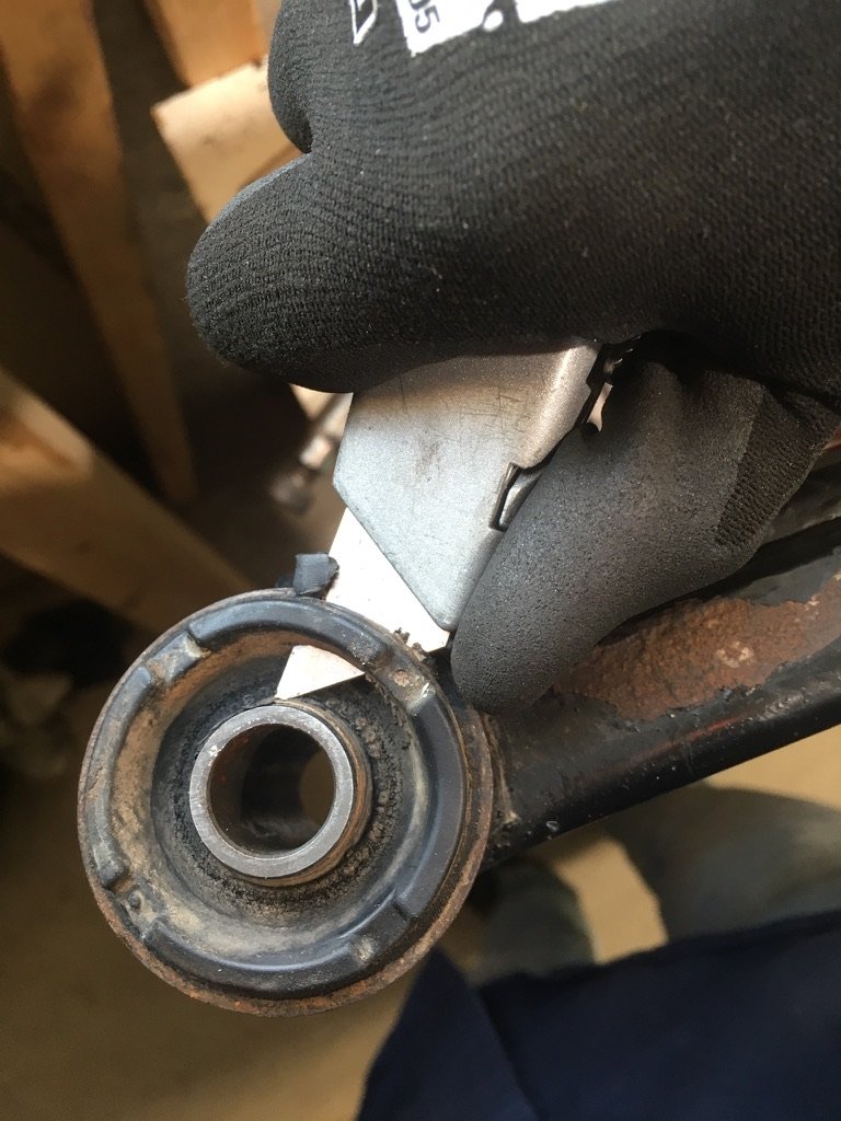

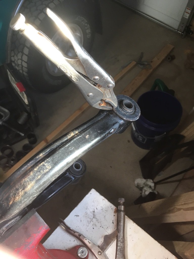

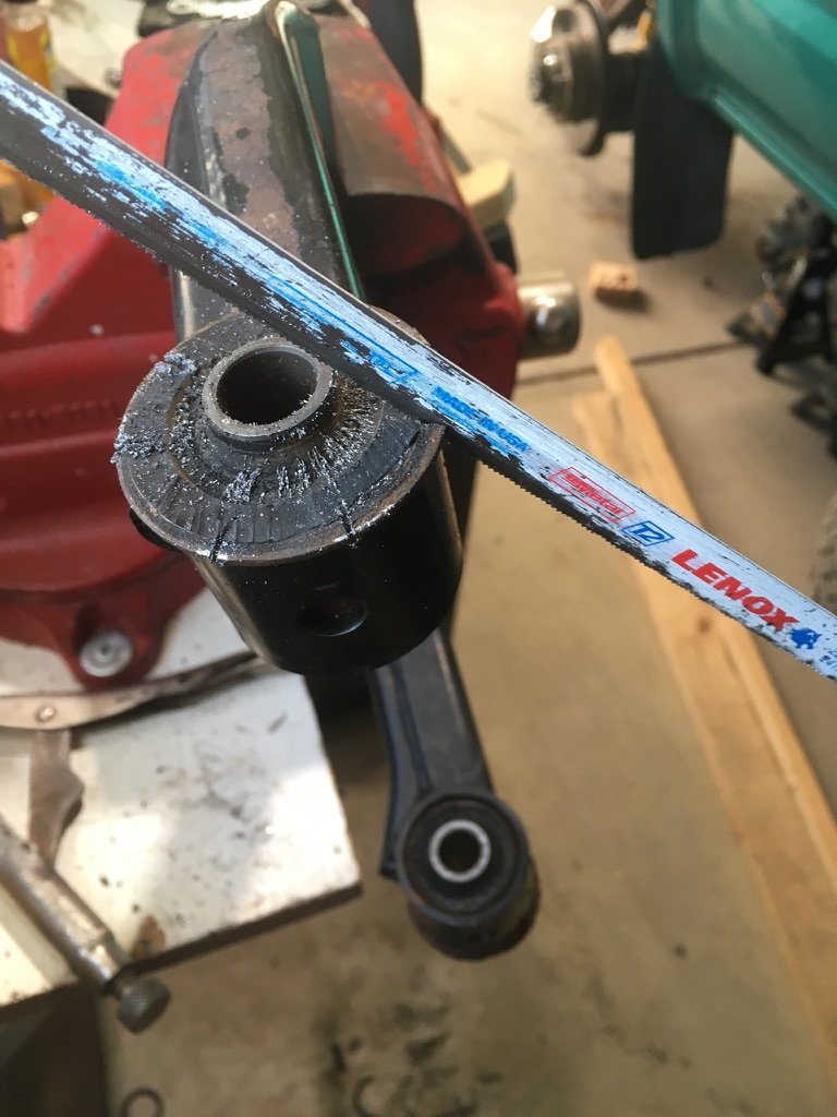

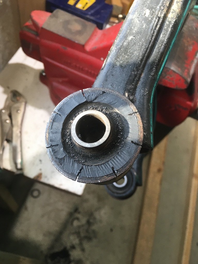

    I just finished removing my old bushings tonight. The first one (which I did yesterday) was a huge pain because I hadn't figured out the technique yet. The remaining three went smoothly with the knowledge gained from the first.
    I followed Timmah's method, with a slight modification: https://www.youtube.com/watch?v=_lZbAd1_EUM
    His suggestion of chiseling the flange on the old bushing (to make space for the bearing splitter) didn't work for me. I think the problem was that my vise didn't hold the arm securely enough, so the hammering energy dissipated as movement rather than bending the flange.
    My solution was to notch the flange with a hacksaw and bend it with vise grips. I used a box cutter to get some of the rubber out of the way first. It only took ~10 minutes of sawing and bending per bushing. Just be mindful of your cut--you don't want to cut into the arm itself. If you have really good vise grips (with a sharp edge on the tip of the jaws), you might be able to bend the flange without even making the relief notches.
    As long as you've got access to a shop press and bearing splitter, the rest of the removal is pretty easy. I haven't pressed the new ones in yet, but I expect that to be pretty straightforward.
    If you don't have a press... just buy new arms :)

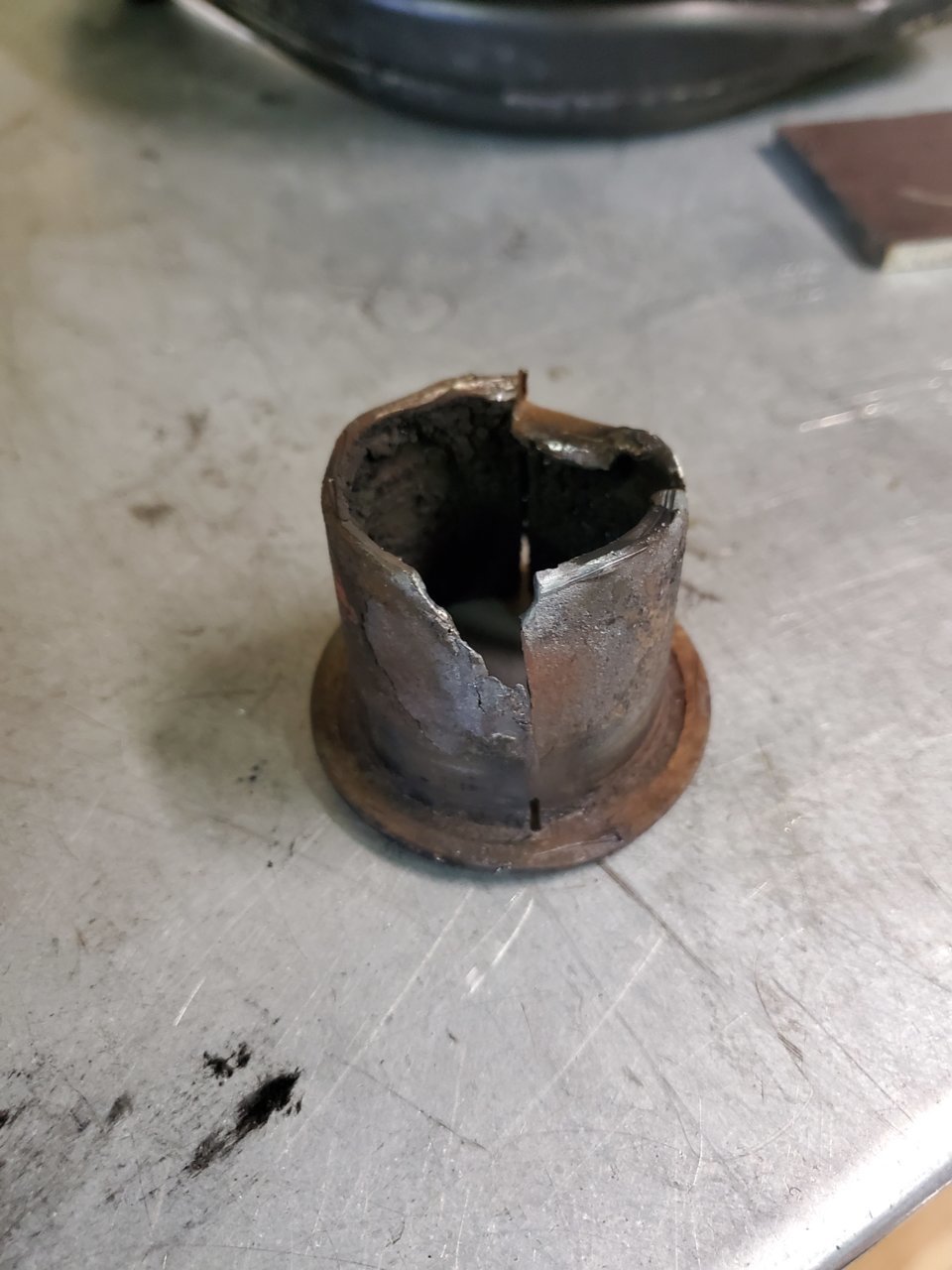

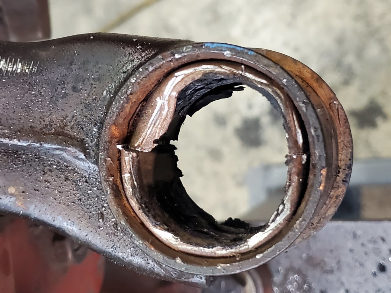

    I bought upper and lower control arms to rebuild from members here and the bushings were so frozen in the arms the bottle jack method was going to bend them out of shape (even when they were secured with a strap)
    Timmah's video didn't work even when I applied the little hack saw trick described above. All of these ideas are great and legit things to try (they've worked for me in the past on other rigs) there's always a chance it might not work and you've got to get creative.
    I ended up using a hole saw to cut out the rubber, then an torch to burn out the sleeve. I had already bought Sonoran bushings so I was committed to followed through with rebuilding stock arms!
