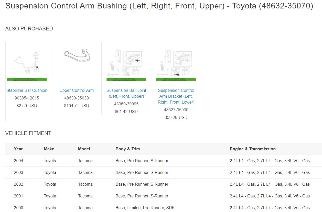

    I am trying to get a set of OEM upper control arm bushings for my upper control arms. I believe this is part number 48632-35070. I put in an order with McGeorge and they said these are not available and won't fit my upper control arms. That Toyota doesn't sell them. However, this seems to be the correct bushing so I don't understand what is going on. Could someone advise me on how to go about getting OEM replacements for the control arms?

    ztwatson [OP] Well-Known Member

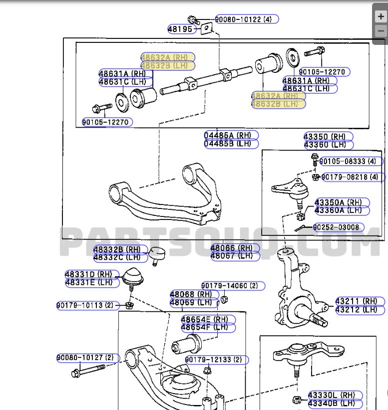

    That part# is for the 5 lug. If you want OEM then you'll need to replace the entire UCA. RH side 4861035050, LH side 4863035030.

    The 4Runner might work... 20 bucks a pop @ partsouq. Might order a pair up and give em a try (?). I would just nuke em' though.

    The McGeorge Toyota Website shows it as compatible for Base and 3.4L. Yet when I tried to buy from them they told me it was only for 2WD. Hence why I made this thread to try to figure out what is going on and if anyone else has used 48632-35070 as a UCA bushing replacement for a TRD. Similarly, the TRDshop also confirms it is comaptibile with my VIN. I'm so confused.

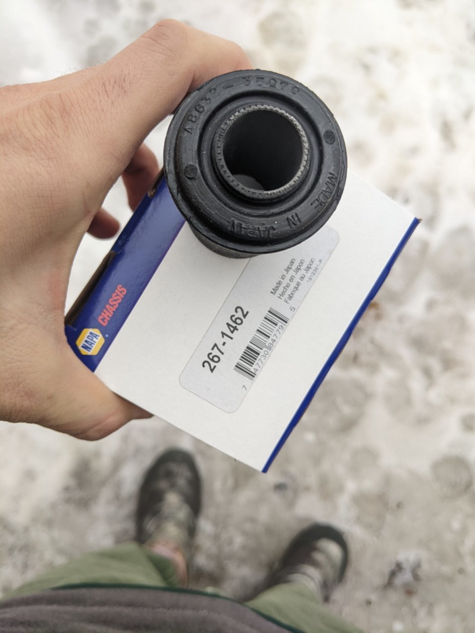

    Ended up buying Napa bushings. They said these fit a 4WD 3.4L. The bushings have the 48632-35070 part number stamped on them and are not the right bushings. Too wide on the inside of the bushing and different appearance on the outside.
