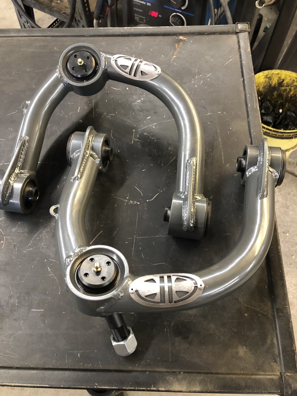

    JD Fabrications... uses OEM bushings and greaseable uniball

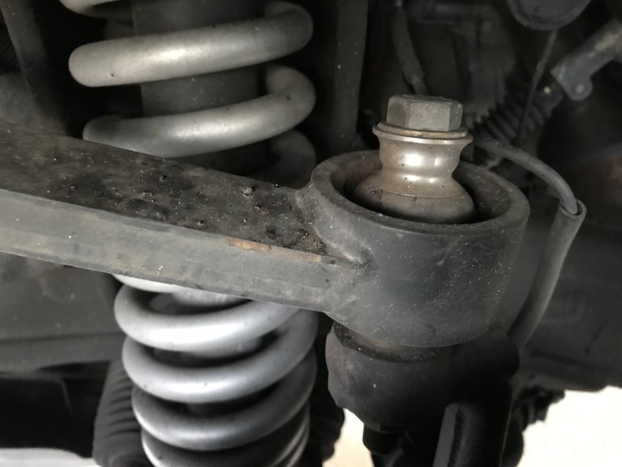

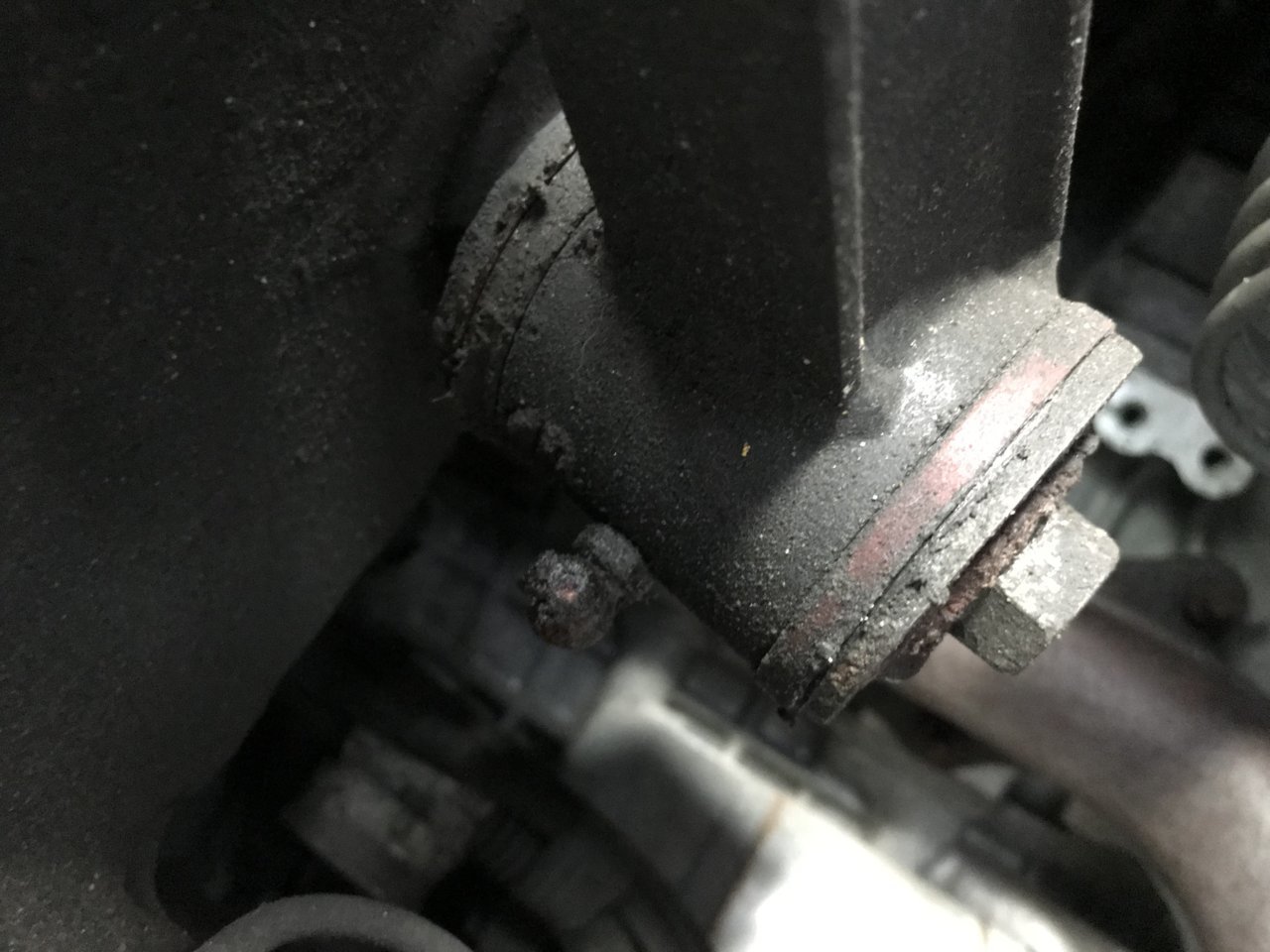

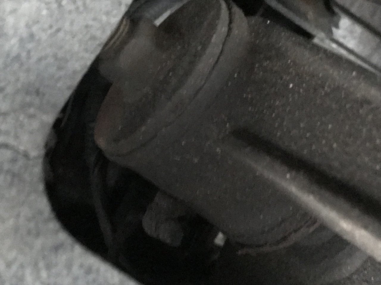

    The upper ball joint on these is a uniball design and that’s no problem to maintain. It’s the frame side of the control arm where that super long bolt goes through. There is a zerk on each side on the bottom but no place for the grease to push through from what I can tell. Unless I’m doing it wrong!
    Pics for reference. Kinda dark this am but you get the idea.

    This is why I have the setup I do...no bushings to every lube and the arms never make noise!

    Loosen the main long bolt before greasing to allow for room for grease to flow.

    Yea, I did that once or twice initially but really a pain in the ass design, no? I'm sure theres gotta be better ways.

    Bolt the JD fab arms on and you are done, there is zero maintenance and zero adjustment needed

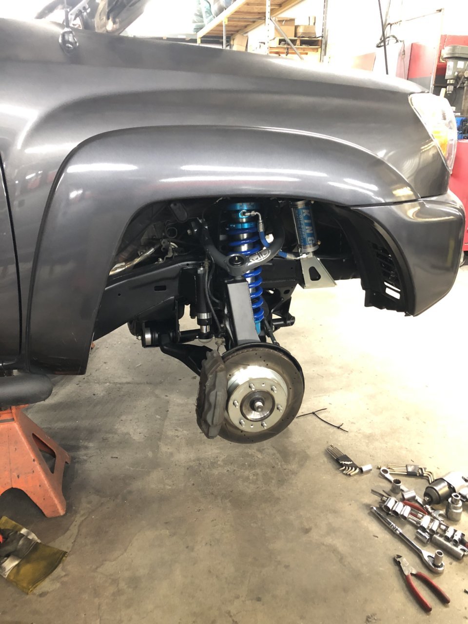

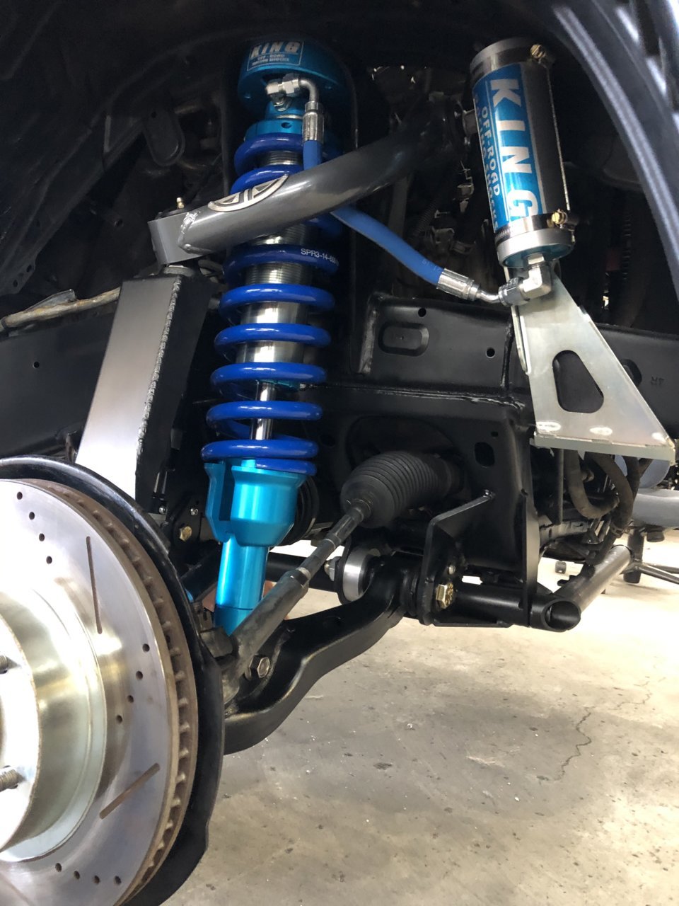

    Yes, this is their upper arm on my second gen

    Ah, there. I thought you were referring to the ball joint.
    Loosen the long bolt to get some gap between the end washers, then give a few symbolic pumps with the grease gun. If you put grease in during initial installation, the inboard bushings don't need frequent repeat greasing. I had All-Pro UCAs in my old truck. Didn't grease the inboard bushings for 5 years - no noise from there (though the uniball squeaked a lot). The urethane aftermarket sway bar bushings in my Subaru are still running quietly on the original grease packet with no maintenance over the past 6 years. The Mevotech-packaged UCAs don't even have zerks for the inboard bushings
