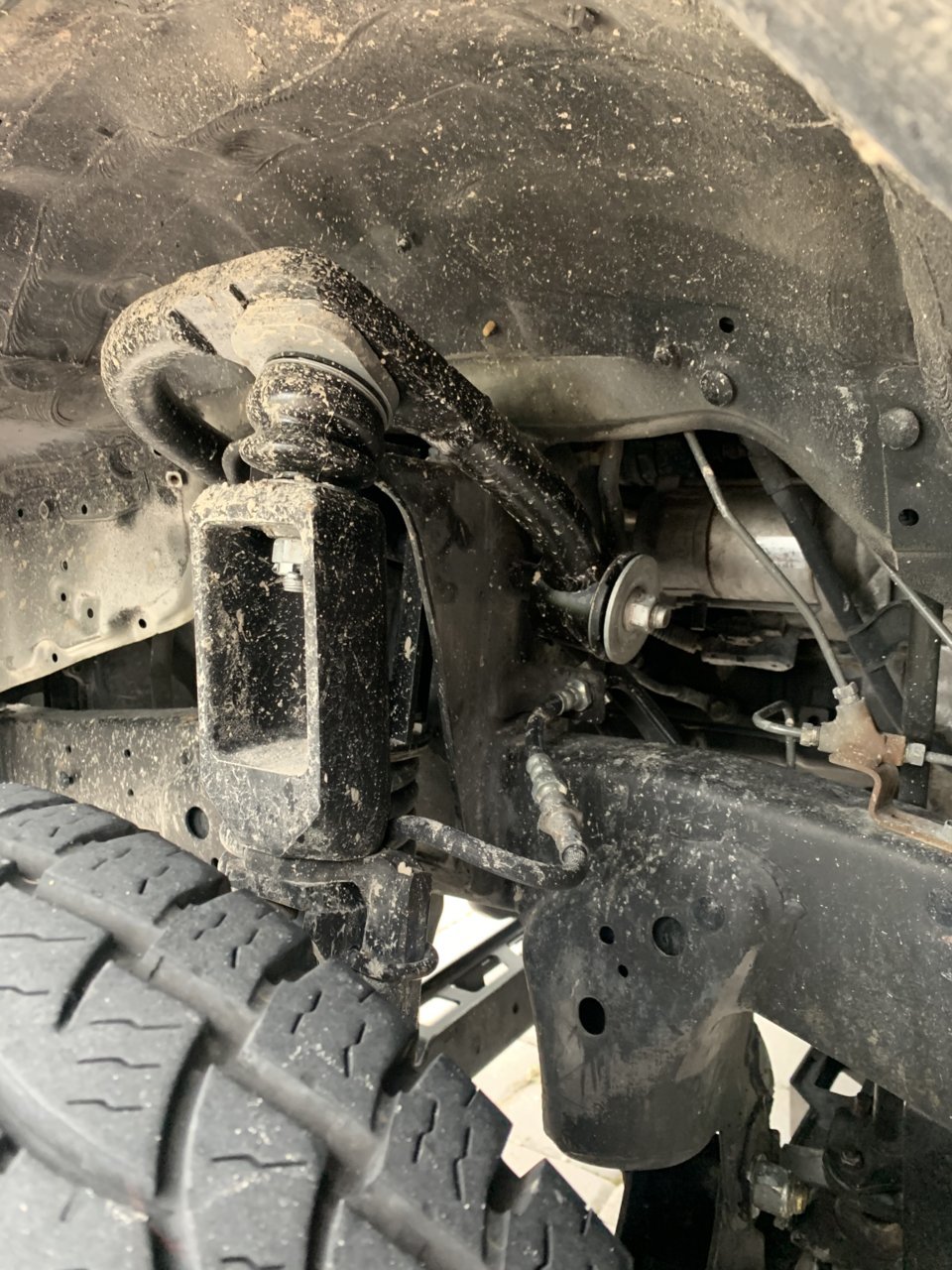

    What’s going on .... I’m new to the forum was wondering if anyone can help me out . It’s a 2001 Tacoma prerunner 2 WD I put a 6” lift kit and upper control arm .. but the I’ve noticed they are to high up . What’s the solution. Thanks

    Get that kit off!
    Ball joint spacers are the worst.

    Holy smokes
    Yeah I'd take that kit off pronto, much better ways to achieve 6" lifts
    But even still... The ball joint spacer kits I've seen dont end up looking like that

    Wait is that a huge spacer on top of the shock assembly too?
    I think you've got way too much spacer action going on here

    Ok, here's the problem. When you do a 6 in lift you probably shouldnt use spacers, you need to swap out just a little more suspension.
    Spacers max out at a reasonable lift of about 3 in on most tacomas.
    I've never seen a lift quite like that one before, holy heck.
    Sooooo.....
    The only thing I can think to fix it is to take it off. 1500+ is what a proper lift will probably run ya.

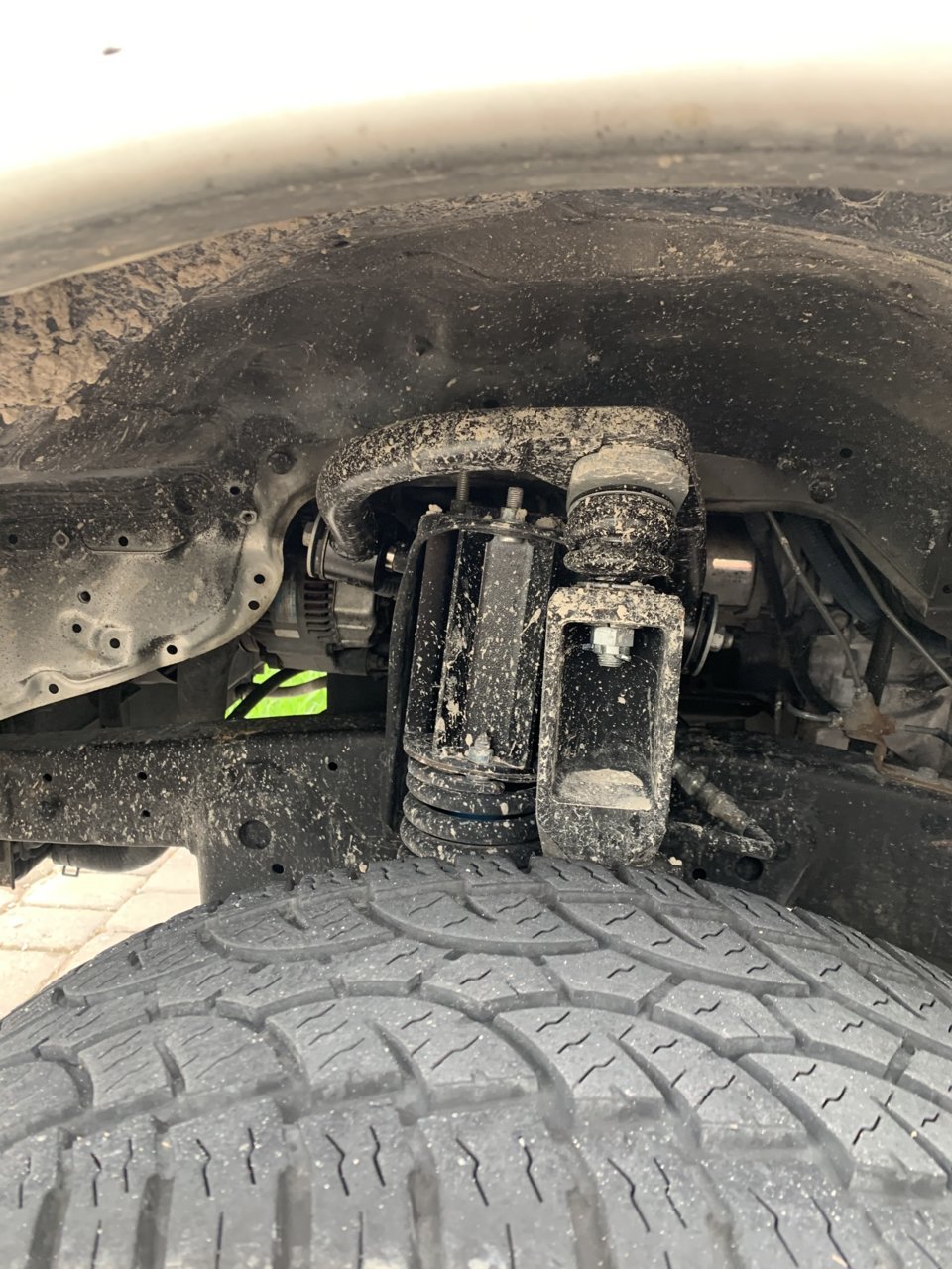

    Something is definitely not right there. It looks like your coil springs are compressed all the way down. Show some pictures from the front of the truck.

    OP, if this is a DB kit and after you finished the install and look like this, more likely your coils are dead.

    Is it possible he didn’t do the new lower bracket and put the 6 on top of the original lower control arm location of the frame? I’m not sure how these deal with 2wd but I’m taking a shot in the dark.

    I was wondering if it even came with a drop bracket or if the concept was simply to combine spacer lifts, which of course is never a good idea.

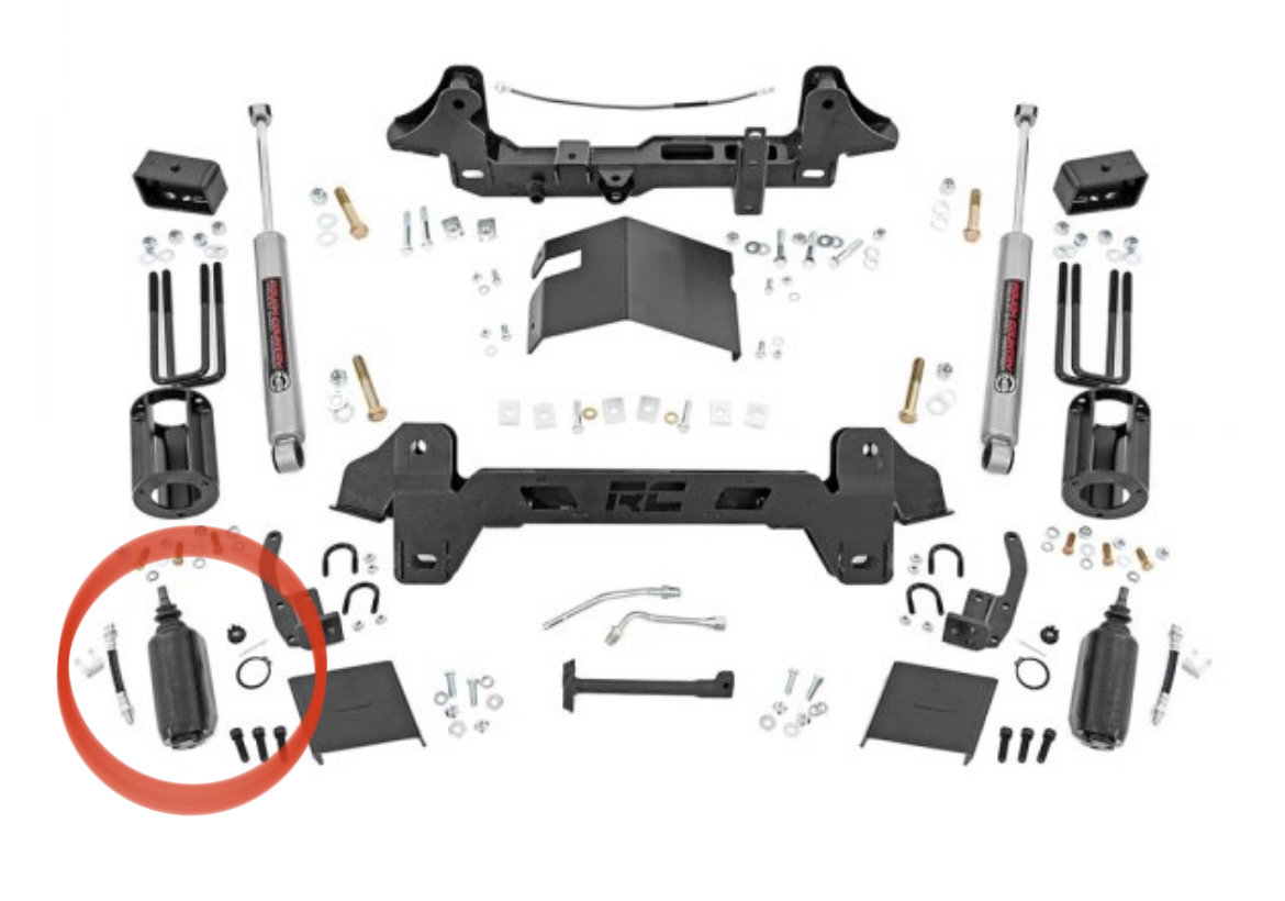

    This kit looks like it's supposed to have a drop bracket, (never seen a 6" lift that didn't use one on an IFS front) and it looks like you don't have the drop bracket installed.
    Like you forgot to put in these pieces:
    Also these types of lifts have a horrible reputation on this forum and generally are considered a less safe and/or desirable option. I would return it to stock and go with a tried and true 5100 3-in lift, or save your money for a serious lift kit.
    Either way this doesn't look safe to be driving on in it's current configuration.
    What they heck is this kit anyway? Did you buy it new or used? Are you certain it's actually for your truck or is this a "universal" kit?

    Don't need more pics. The solution is to remove that ridiculous, dangerous kit and do it correctly.

    I would start by removing the ubj spacer and seeing where those ucas and strut spacer puts you seems like that alone would be close enough

    What brand lift? Need more pics. However based on what I see, it appears those are SPC arms and they don’t look compatible with that ball joint/knuckle spacer. Our 1st Gen trucks use an inverted ball joint mounted on the spindle/knuckle. Rough Country uses a similar spacer on their 6” kit with a built in ball joint designed for the stock upper control arm.
    Most drop bracket kits also include an entire replacement knuckle with the extension built into them. These types of ball joint extension spacers are down right scary. The Pro Comp 4” drop bracket lift had similar ‘grenade’ spacers and owners were installing knuckles from the Tuff Country drop bracket kit. Also, the coils looked collapsed in the photos..
