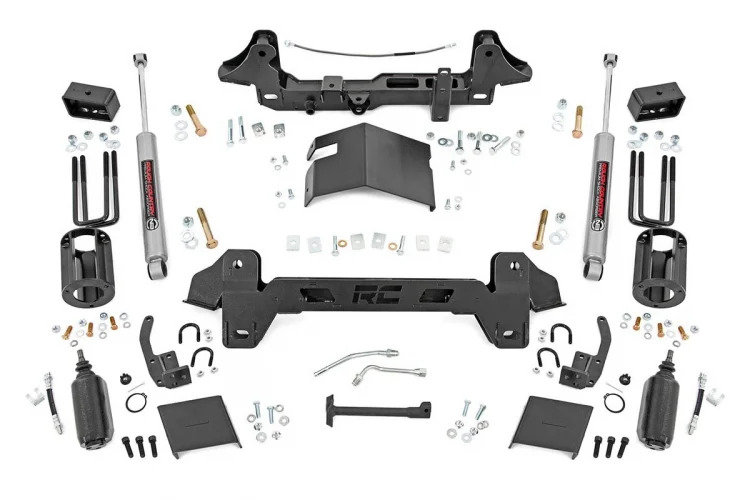

    Almost wondering if those ball joint spacers were on beforehand and not part of the 6" drop bracket kit

    It’s a rough country 6” lift kit . Then I got the upper control arms . Inner , outer tie rod , lower control arm bushings and lower ball joint .

    That is the kit he has, except it has the TRD Bilstein 4600 shocks which are still stock length shocks with spacers on top.
    My question is, I wonder if he can easily unbolt it as I'm unfamiliar with install of said kit.
    I've heard some DB kits notch the subframe, but wasn't sure if that was all 6 lugs or just 4x4 models.

    Yes .. my Tacoma is 2 WD

    The shocks it com’s with are for the back .

    Doesn't the whole front cross member get cut out and replaced? I don't know much about them either just what I've heard on here when people are looking to undo them, they have to find an original cross member to weld in. Might depend on the kit too I guess

    Yes it’s true

    I wouldn’t think you’d have to cut anything unless you’re lowering a diff at the same time, don’t know though
