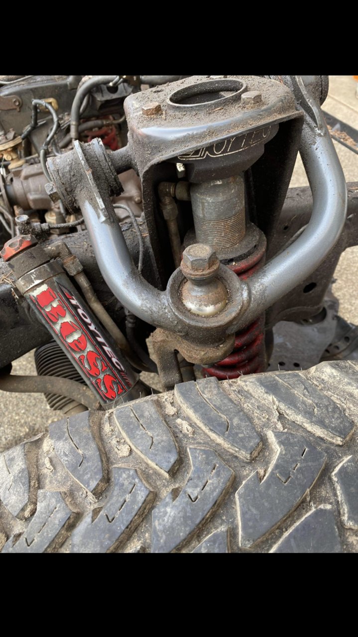

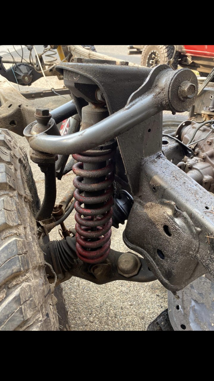

    I’m thinking about purchasing these control arms and the guy that’s selling them says there spc but to me they look like total chaos, can someone help me? And would anyone know what approximate year these coilovers are from?upload_2022-10-18_13-20-45.jpgupload_2022-10-18_13-19-55.jpg

    They look more like Camburg to me and it all looks pretty rough. Hope you're not spending much more than a couple hundred bucks

    It's less Tacoma and more mod
    I wouldn't spend a penny on the coilovers, they're a low tier coilover that aren't worth the price to rebuild... and they definitely need a rebuild.

    those definitely aren't SPCs. SPC uses a ball joint style arm, those are uniball. Probably Total Chaos are Camburg like mentioned above. Or they might be cheap knockoffs. If you buy them then be prepared to replace the Uniballs

    Can see the engraved marking on top near the coil bucket.

    yeah those are Toytec Boss coilovers with the reservoirs, but it's an older style of them. Probably 5+ years old at least? I don't remember if Toytec are rebuildable or not. If not then I would definitely not consider that older used set that looks like it's been through the ringer.

    That link is to the newer Aluma series which are rebuildable and manufactured by Elka.
    Not sure if the older model are rebuildable but agree they look in rough shape

    I would stay away

    i dont think they're even rebuild able
