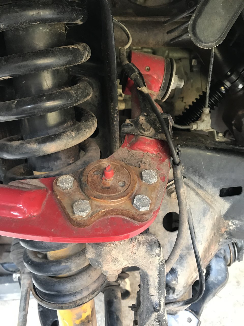

    Thanks boo. I knew he started machining his own, didnt know the black were the GM ones. Have you mentioned to Marlin about the rust issues? Can't be more than $1 per piece to have them powder coated.

    Just to clarify the rust is only cosmetic right?

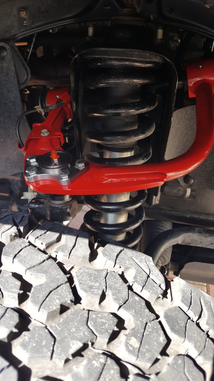

    SPC failures were on their original design and failed do to improper install by the end user.... their original design used a similar to stock bonded rubber bushing of which you had to tighten the main bolt at ride height.... the people that had theirs break did not do this which caused the stress breaks.
    Second gen had their specride bushings which were free floating and the main bolt could be tightened at any uca position without issue.... these bushings did good but do squeak (mine do)
    3rd gen spc arms have their new xAxis bushings, essentially a sealed uniball on each of the mounting spots to the frame, no lubing is needed (or so they claim)!
    I went with SPC because at the time JBA's just came out and had some of the aforementioned bending issues (no bueno) and the extra adjustability was a plus for me on the spc arms.
    Now, i would still choose the SPC arms as MY GOD THEY MAKE ALIGNMENT SOOOOOO EASY!
