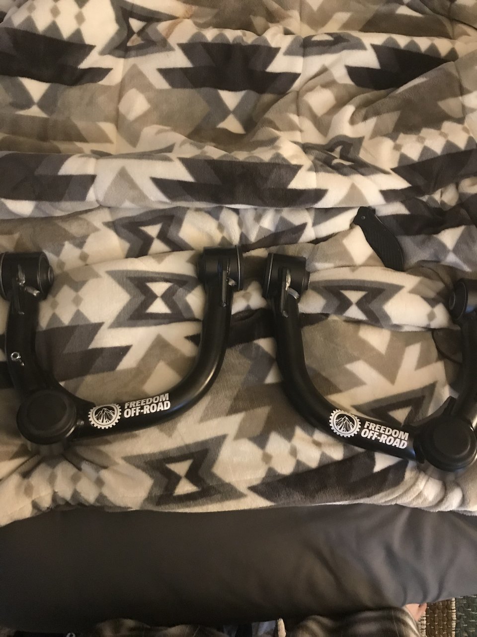

    Got freedom offroad ucas to try, not lots of info but what ive read there pretty dang good for the money

    If they work they work. Some people on here are so afraid to try new things, but they have no issue to joke on others that do try new stuff. Never has made since to me! Plus 600+ $ for some ucas is NUTS

    15 FoST
    The jokes wasn’t directed at you :cheers:.
    That being said you trying them and reporting back over time is critical for learning. At that low a price though for Uniballs one has to wonder where and who made them. Best of luck.

    Ah. I couldn't tell from his pic.

    It says they are replaceable. I wonder what that means. Are they hard to find or a common part?

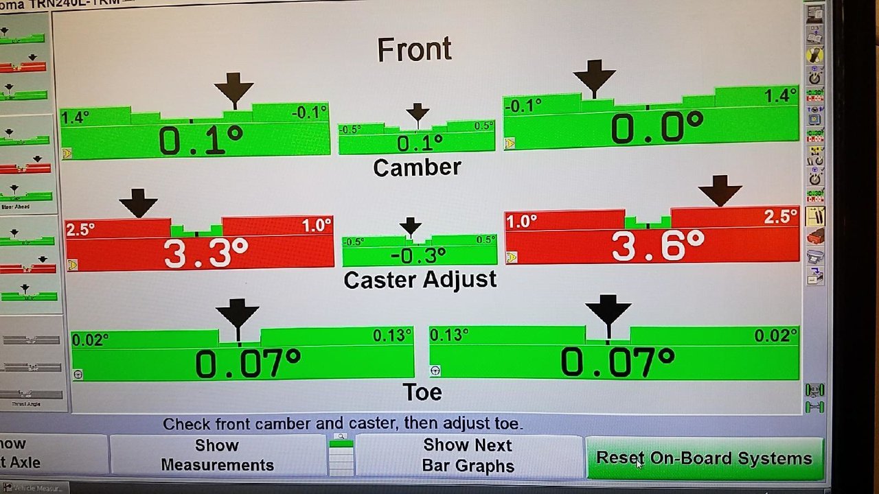

    I say JBA, because it's fixed high caster. Any half decent alignment shop will be able to get you above 3 degrees of caster, because they just give you an alignment like they would any other tacoma.

    You can get the balljoints from them for 35$ each. They told me they were made by moog for them? (Dont know if I believe that) but they do seem good quality. As for specs they said that the arms are made to relieve ball joint angle and alow the truck to be set to OEM alignment specs with a small lift on the truck.

    ICI Magnum front bumer Rigid LED lighting OME lift 285/70 Nitto Exos 17" Fuel Hostage TRD Exhaust TonnauPro Cover Oil Catch Can Tint Pioneer Nav system Sound System LED lighting Euro headlights Paint
    Ill post it when it gets done, should be friday
