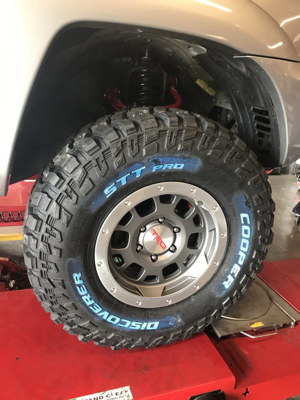

    I can confirm that JBAs with 285s on the TRD bead locks with not rub unless at max turn. With a .75 and up wheel spacer you will clear the UCA no problem. 03B95E28-A9E4-45BA-AC54-530E0126730A.jpgABD4DAA7-411D-47E2-A07F-29EB150B64EF.jpg
