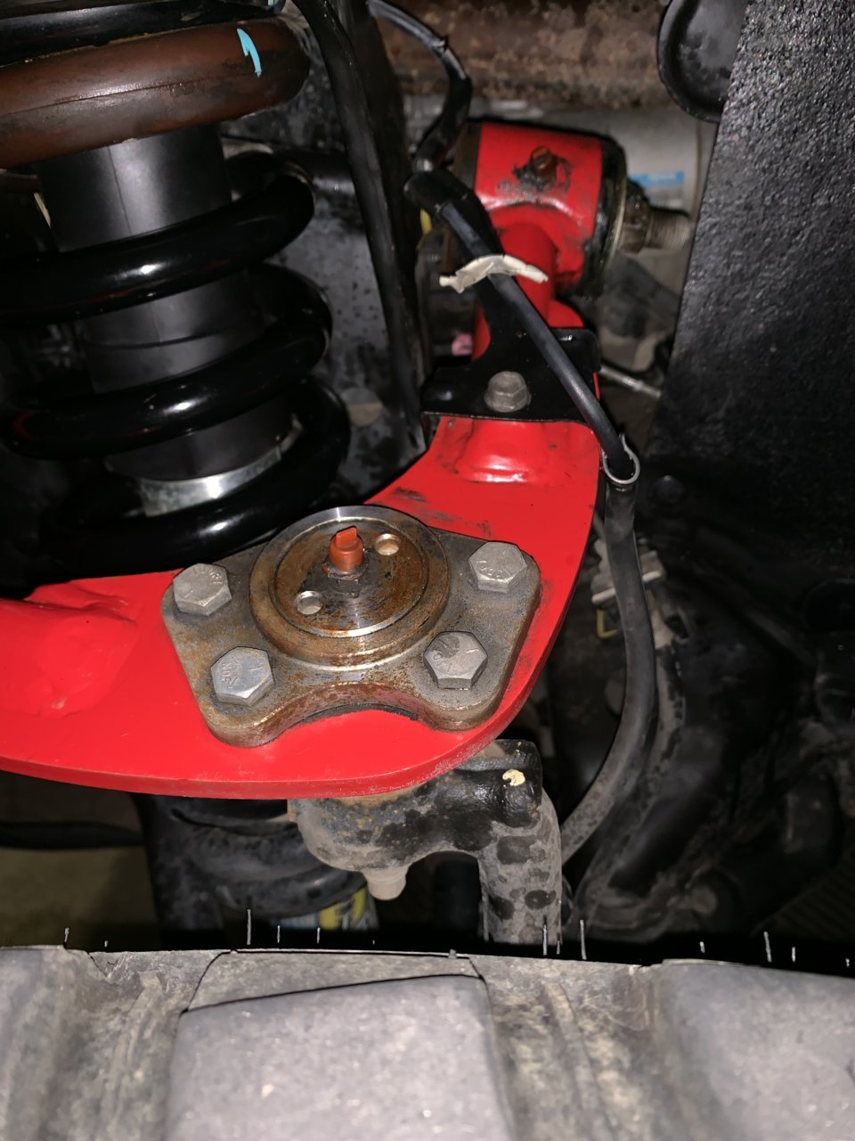

    Well, apparently mine were cerecoated to begin with. I couldn’t tell when I really looked at them when they were brand new, but regardless, I tried to wipe away this rust and it won’t clean off, it’s real rust, lol. Winter took its toll on mine unfortunately.

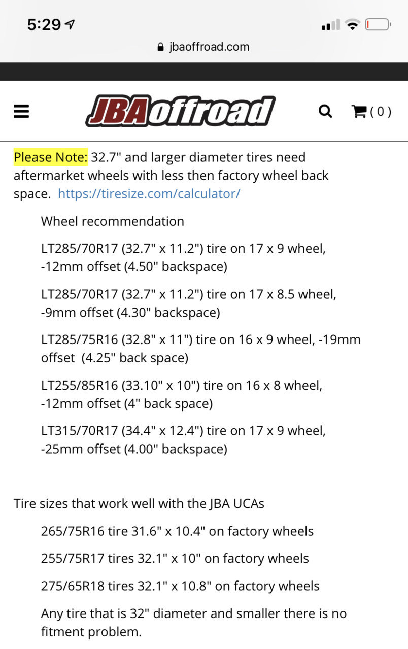

    I was going to order these now I'm wondering if a 285 on Five Star 17x8.5 -6 - FN Wheels (4.5 backspacing) will rub do not want wheel spacers.:facepalm:

    Hard to make an argument against SPCs for a slipping ball joint (which hasn't been an issue for me, even at 70mph in the desert) when people are having to run spacers to clear the JBAs.

    I’d rather run spacers than run the risk of the ball joint moving. I have spacers and wheel hard as hell, and no issues.

    I run 295s on JBAs without spacers :smokertransformer:
    Part of the issue is matching your rim to the tire width you're trying to run. Get the right clearance from the lugs and you're fine.

    So you can clear the JBA’s with stock wheels?

    My only piece of advice is to make sure you're wheels have enough offset/backspacing to run the JBAs. I too was going to run them until I found out they wouldn't clear 285's on my TRD Pro wheels, so I switched over to the Camburgs and have been very happy. If they had cleared I would be rocking the JBAs for sure.
