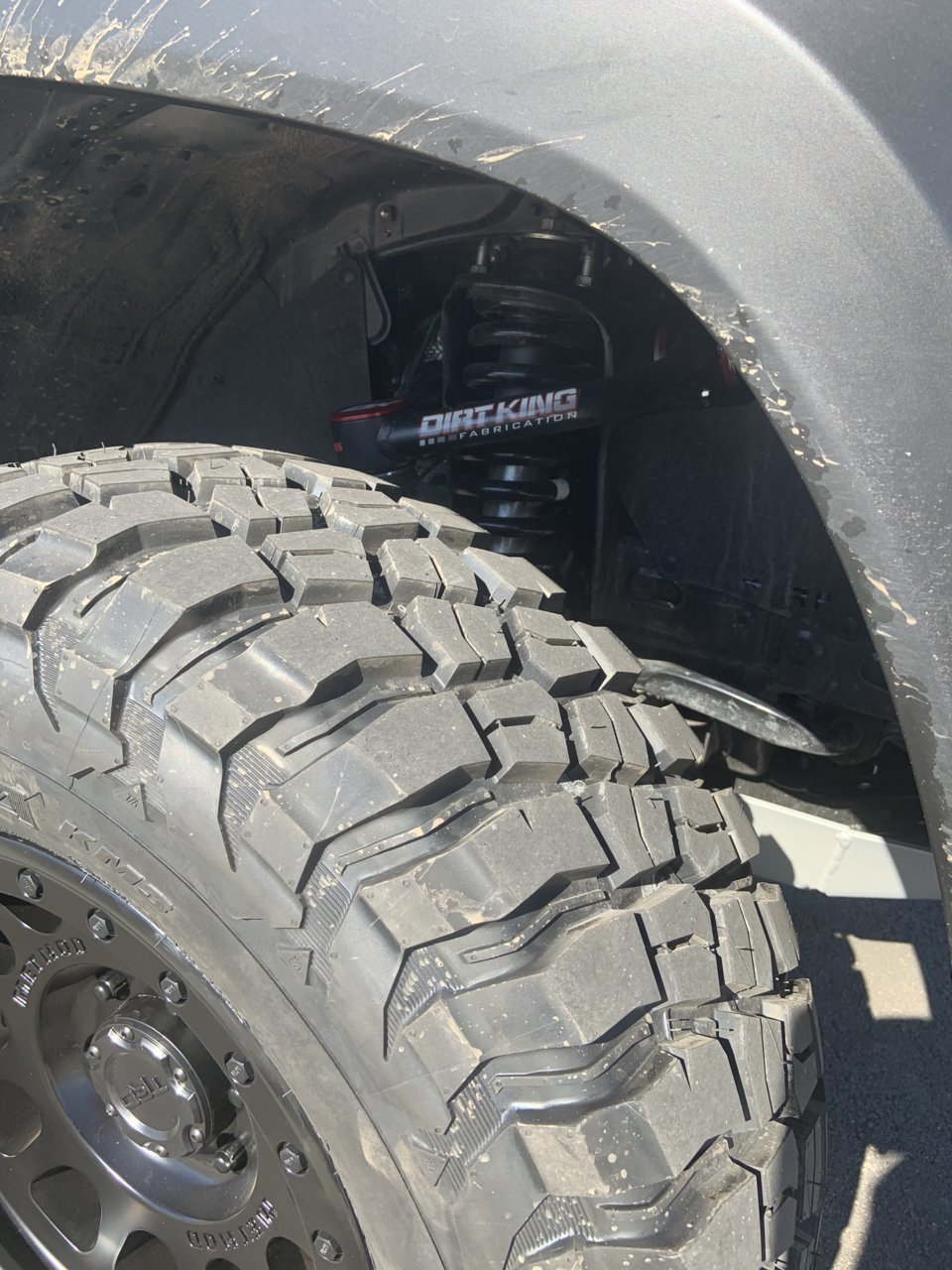

    Dirt king with a ball joint. Won't break the bank and replacement ball joints are easy to source. Stay away from JBA. Their ball joints don't last worth a shit either.
    https://dirtkingfabrication.com/collections/tacoma/products/ball-joint-upper-control-arms-dk-811901

    A.R.E. Topper with victory topper rack, blacked out exterior emblems, star armor side steps, TRD CAI, TRD Pro exhaust, Method MR305 NV 16in Rims, TRD PRO front grill, Meso coin holder, TRD Pro skid plate, Kings 2.5 coilovers with remote resis front and rear, OME HD Dakar’s, ECGS, LT285/75R16 KM3s, Dirt king UCAs, Meso gas cap holder, Meso blacked out interior kit, TRD start/stop red button, AVS low profile window guards, AVS low profile hood protector, Full LED upgrades inside and outside, decked bed storage system. And I’m sure there’s more I’m missing lol
    My vote is dirt king. Fantastic UCas!
