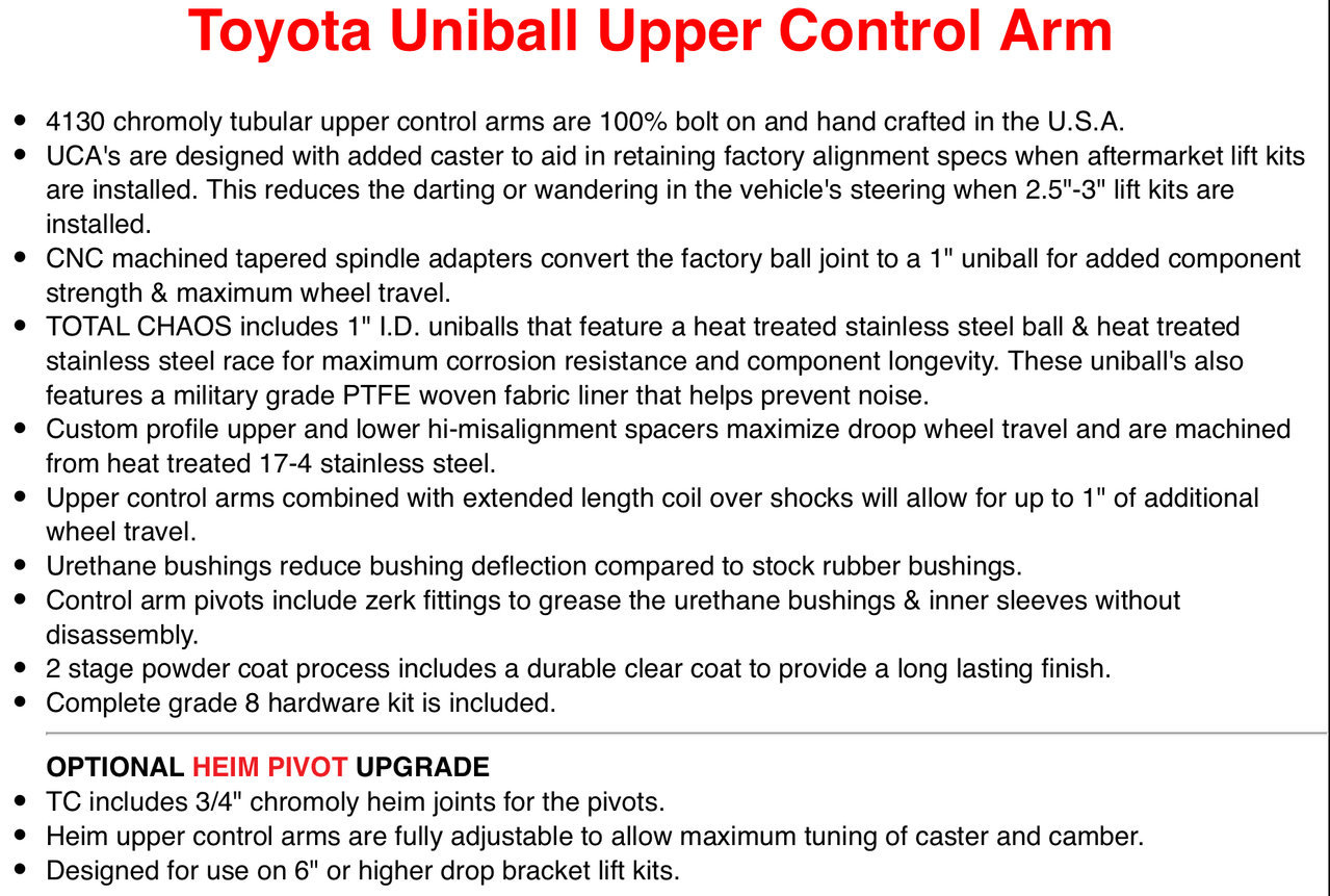

    Can anybody explaine what aftermarket uca do for a 3” lift ,are they longer ,do they move the pivot point forward,??

    Allow you to have proper alignment is the big thing here.

    Add caster angle. It says it on the second bullet of the picture i attached.
