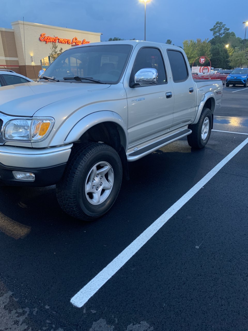

    Here’s a pic. They did 3” lift in the front and 1 1/2” in the back basically wanted it level but I mostly drive on the road maybe in the future I do plan to take it off road. I was deciding between camburg or total chaos.

    Sounds like you're looking at uniball UCAs then, nothing wrong with uniballs they are typically the strongest UCA you can get (usually more expensive too), but they require more maintenance than a ball joint style UCA. And if you live somewhere that gets rust, you're probably going to have to replace the uniball more frequently. They also tend to make a lot of noise if you offroad a lot.
    Ball joint UCAs are usually quieter and have better articulation than uniball. But uniball has more strength than a ball joint. Really just comes down to preference and budget.
