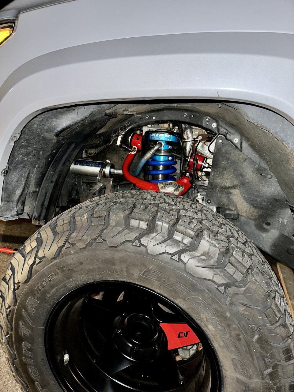

    King 2.5" and JBA UCA went in on the driver side. That UCA removal / install was brutal.... and apparently that isn't even the "hard side." Atleast it looks badazz :)

    The driver side was much more difficult on my truck, and I cut the bolts. There was zero chance of the bolt coming out with just bending; I would have been cutting the fender.

    That is good to know. It was a total PITA to get out. Bending definitely helped but the bolt did not just "slide" out. I had to beat the heck out of it with a long punch and mallet. Getting it back in wasn't very easy either. Had to stick a long rod through the grill in order to tap it in with a mallet. Might do the passenger side later today.... but I am dreading it.
