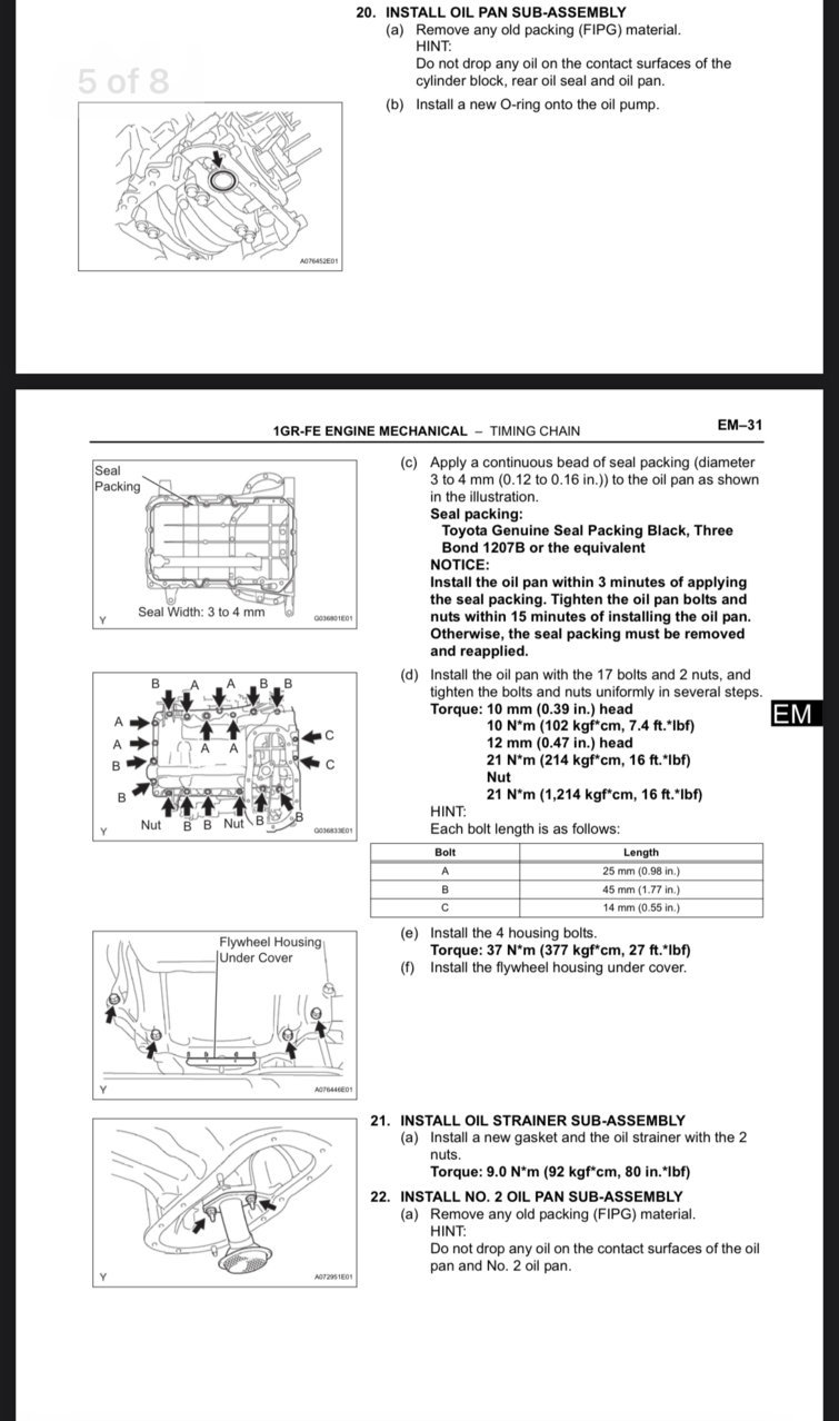

    08 tacoma upper oil pan removal and replacement i don't remember quick bolts go where i can't find bolt positioning help please
