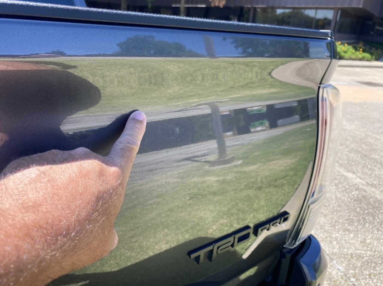

    4” strip of Xpel from the top. Stops at my finger. 24B5503F-EDFB-42EF-B203-883760E0B89D.jpg

    This was one of the first things I did to my truck in 2018. Closing the tailgate when its dirty will result in lots of scratches without the protection film.

    I originally did the 6 inch, but it goes down into the tailgate handle about a inch, so I had to cut around the handle and it looked pretty bad. So I switched to the 4 inch and it fits perfect.
