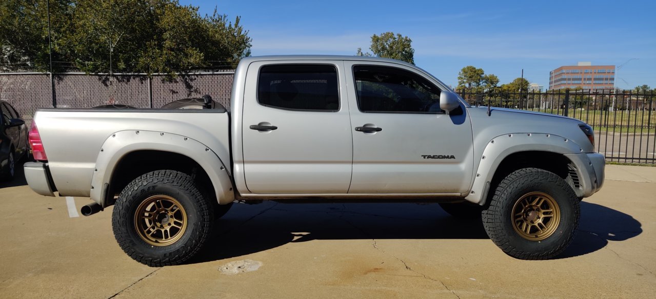

    Hi all
    So a buddy of mine picked up a 2019 TRD offroad (not pro, editing to fix) - put on some really nice wheels, I bought his takeoffs and they look fantastic. Really happy to replace my super chrome TRD sport 17"s, stacked in the back there. Even though he got a top of the line Tacoma - passenger rated tires on the new wheels. Not even truck tires! Amazing. This is fine by me, my old tires were about shot anyways so I'm due for new tires.
    Planning on going from the stock 265/70 to 285/75s. I'm planning on doing the cab chop, but anything else I should take into consideration for making that adjustment? The current "lift" is just bilstein 5100s in the front, 2" level block in the rear. Because my truck is an 09 I went through the whole got my fourth leaf spring from dealer, leveled out front with the 5100s @ 1.75"s, then had the whole rear leaf pack replaced on recall which were then recalibrated to stock ride height. So now the truck is leveled in both directions! But it sits at a great height so I am fine with it. I'm actually 3/4" higher in the rear but I can click up one more stop on the front 5100s, which will make it dead level. Trucks got about 96k on it, probably 80k of that on the front bilsteins.
    I'm hoping the upsize isn't too negative on power etc. Regearing sounds like a big job. Would that be a big consideration if I go up a full 2 inches on the tires? Any advice on speedo recalibration?
    Christmas is gonna be some wet okole seat covers as well as tires. Very excited about that! Have a great holiday everyone.
