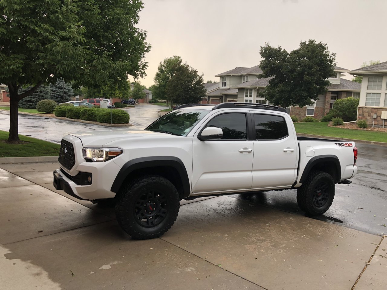

    2018 White DCSB TRD Off-road
    265/70r17s, stock suspension, have wheeled the crap out of it and zero rubbing issues... hand calc with gps based mileage and averaging 18.5mpg and that’s including all of the backroad driving and wheeling... And the truck feels much more controlled to me with the BFG C rated KO2s.

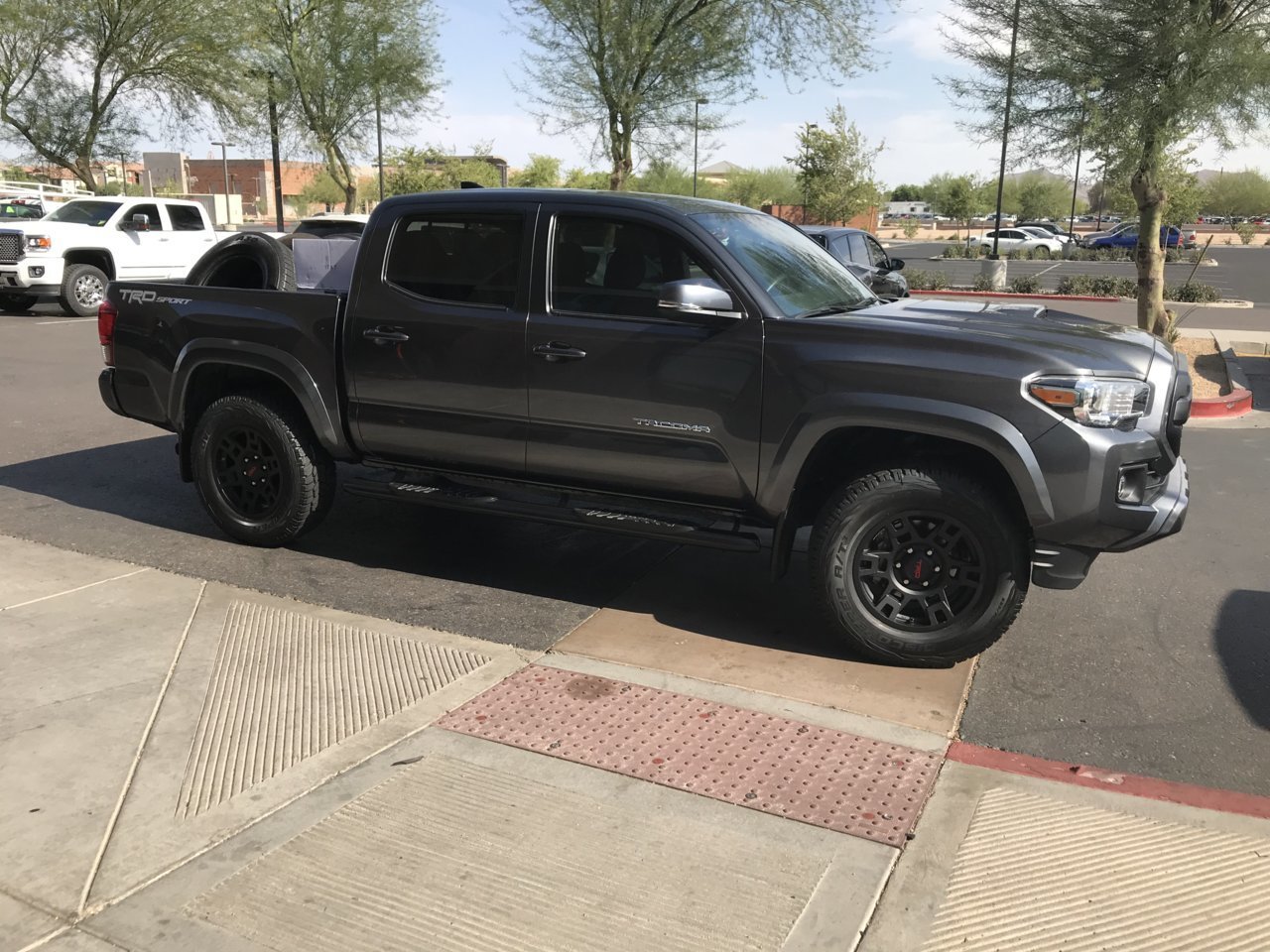

    I have a Gashole
    Running Cooper Discoverer AT3 in the SL rating stock suspension. They are 41 pound tires. The original Toyo's were 36 pounds. Ride very quiet and comfortable. Can't really say I notice any difference from stock Toyo's other than increased resistance in roll going to an off road tread.
    Lost about 1-1/2 mpg. Was averaging 20.5-21 combined. Now getting about 19.5
    Seems to have affected me more on the hwy than local.
    Not sure the difference in rim weight over the stock Sport rims.

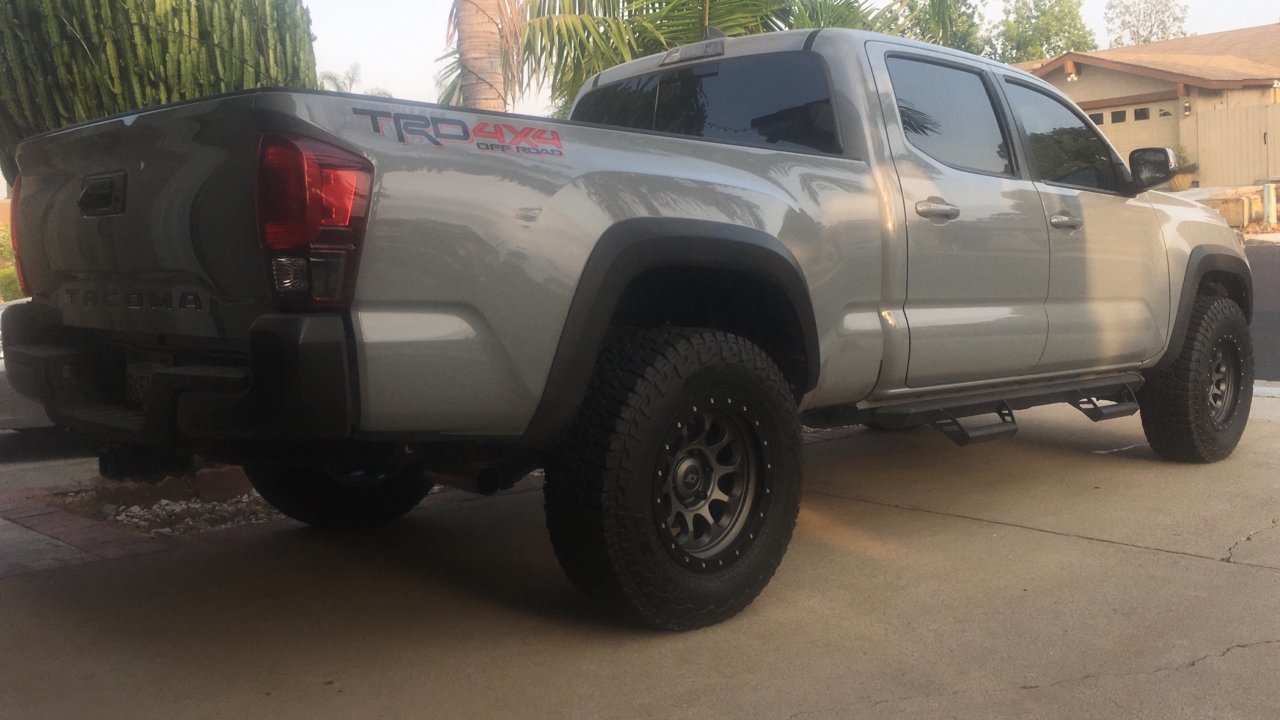

    I went to 265/75/16 e rated bfg ko2s (decently heavy tire) and only lost .5 mpg.
