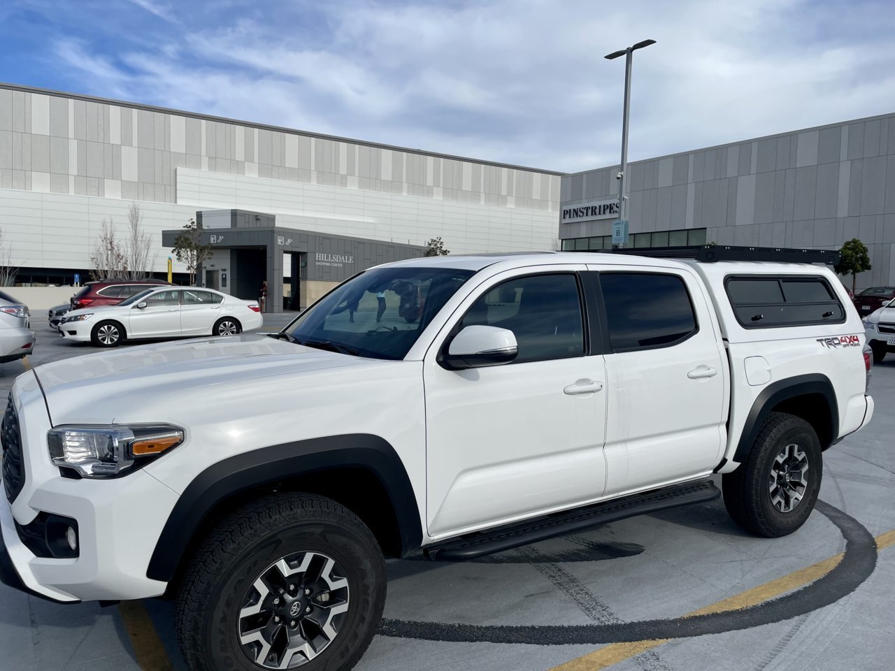

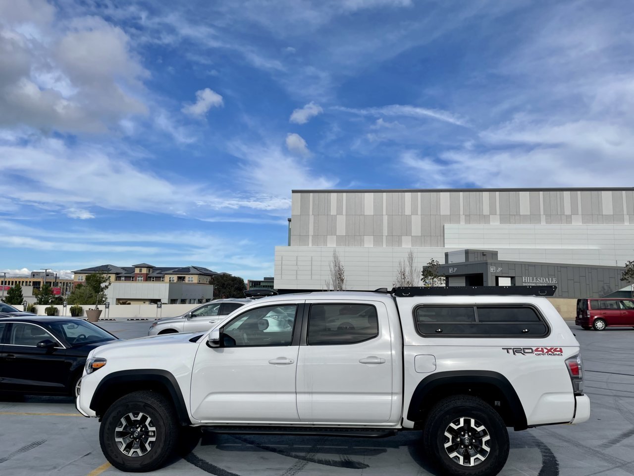

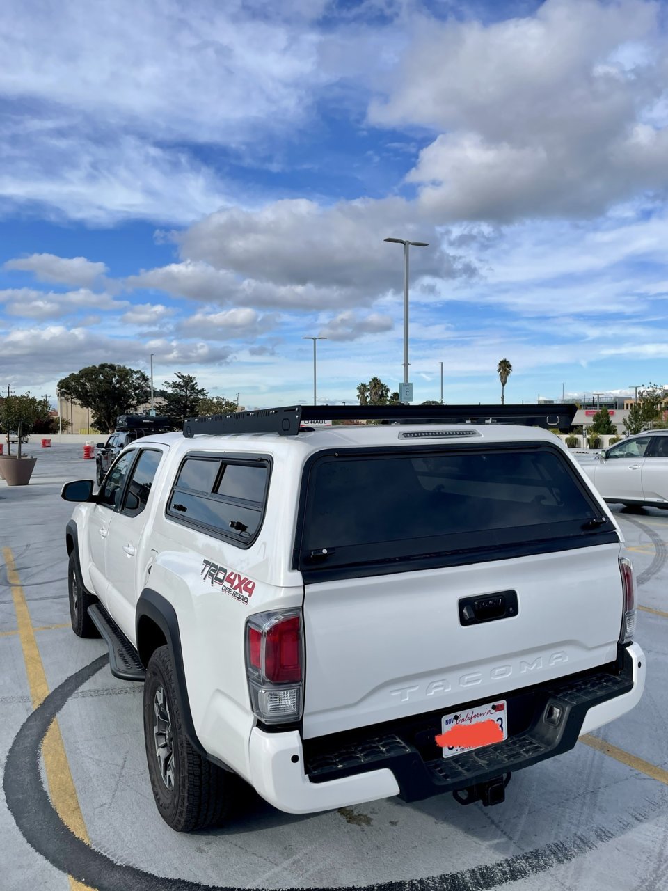

    Finished installing my Bravo Short Bed Top Rack.
    This thing is beefy. Then side plates profile is tall. Installation instruction was okay. It’s a universal instruction for the Alpha and Bravo rack so I had to sort through the sections that only pertains to the Bravo SB.
    Like a previous post, I too had concerns that I was sent the LB version. But checking with Micah(their engineer), I was reassured that it was the SB.
    The instructions also recommended to install the feet on the 2nd crossbars(front and back). With my Leer rails, it was a few inches too short and I had to put the rear feet on the 3rd bars. Micah assured me that with a even load, it shouldn’t be a problem. I would have like the feet to be mounted on 2nd bars to evenly distribute the weight. We exchanged emails and there’s nothing I can do.
    Another thing was that I had to use their feet mount spacers to raise up the rack. Like I mentioned the side plates are so tall that the rack is MM away from touching my cap without the spacers.
    I think if I had to do it again, I would go with the Prinsu.

    Thanks for sharing. Any update on how you've liked the rack? Does it interfere with opening the back of your camper shell? I was also wondering your thoughts on moving the rack forward (mount to the 3rd crossbar in the front and 2nd crossbar in the back) so that it doesn't hang off the back?
