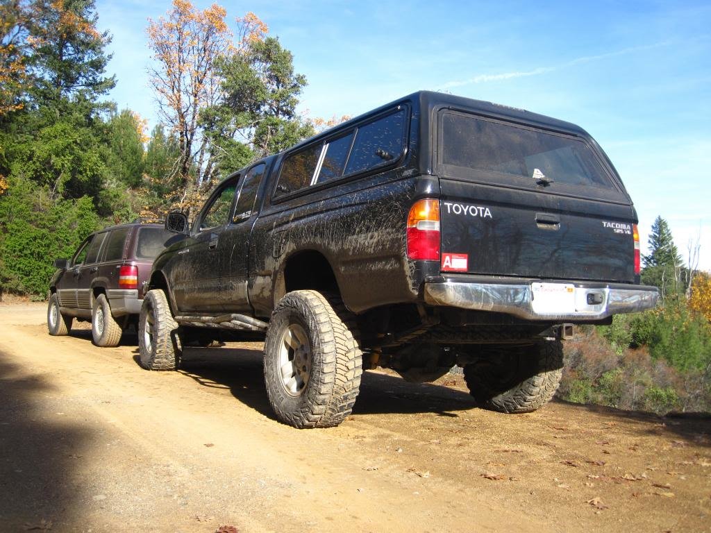

    Old pics iwht 15" wheels and 33x 10.5, and 32x11.5" MTRs
    older pics...
    69B965CD-49F9-4074-82B9-0C7E19FF60E9-102_dd611d8da0b2be482ed05c1717567facf3a7aeb9.jpg

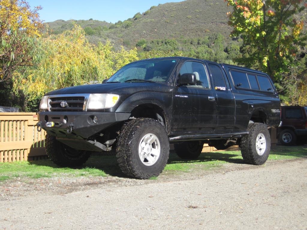

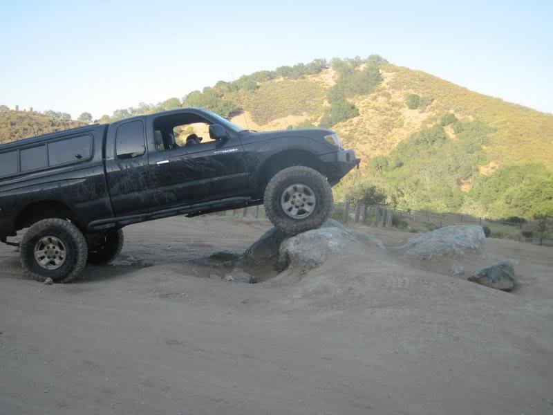

    I picked up this '00 Xtracab V6 TRD Auto in August of 2010. I never thought I'd get an automatic but I live in San Francisco on a steep ass hill where parallell parking between fancy expensive cars is a nightmare in a 5spd truck, plus bad Bay Area traffic, and now I'm glad I did. It had kind of high miles (160k or something), clapped out old suspension, teeny little street tires (probably to improve MPG) and a crappy camper shell, but was plenty clean for the use it was going to see-road tripping for camping, snowboarding and surfing and once I prepared it, wheeling and exploring beautiful America :). I have always wanted a Tacoma and been interested in 4wheeling but I was too busy with fast sports cars to have a truck in addition until then.
    I got it 2 weeks before I was supposed to go to Burning Man and I was bringing two friends, and I knew I would be hauling a LOT of weight for long distances for camping and snowboarding on a pretty regular basis so the old suspension had to go. So first thing I did was put on a set of OME 880s, OME shocks, Dakars, shackles, and 32x11.5 MTR Kevlars. This really transformed the truck into something more capable of hauling a weeks worth of gear and provisions for 3 people through sand, mud, and snow. I knew I was going to haul lots of weight from SF to the hot desert in Nevada and farther north to Tahoe, OR and down to LA, all in a few months so I shelled out big for preventative maintainance. New timing belt, radiator, water pump, gaskets, battery, ignition everything like that just for peace of mind.
    I got sick of my shitty FM transmitter for my iPod so I installed an Alpine DCA-105 head unit.
    The truck spent some time in the midwest and then by the beach in San Diego and the stock chrome rear bumper was eating itself alive with rust. I found a good deal on a Front Range Offroad plate rear bumper from a member here so I picked that up.
    The 32x11.5 MTRs rubbed the frame at full lock and after piling about 25k miles on it in about 18 months I found that I wanted to widen the track for handling, stability with the lift and weight loaded and of course to eliminate the rub so I slapped on Sidertrax 1.25" spacers and bashed on the pinch welds and cut the fender liners. The fender flares had taken a beating and looked haggard so I took them off. I liked the way it looked with them on and the tires stick out a lot more with the spacers and the flares off. Hope CHP doesn't mess with me about it. I got some fiberglass materials to fix them but I'm too busy upgrading more important stuff to mess with that right now.

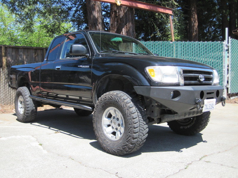

    Then I decided if I'm going to wheel it I want armor and eventually a winch. Coincidentally I found out I could get a Elite front bumper already built right away so I pulled the trigger on that. Also got some PIAA 510 fogs on it for the Bay fog and Tahoe blizzards.
    The added weight of the bumper is noticeable and it sags more so I stepped up to OME 882 coils. In the pics above I had just replaced the 880 coils with the 882 coils. I'm sure the 882s wil settle quite a bit like the 880s did. Here is a before and after comparison

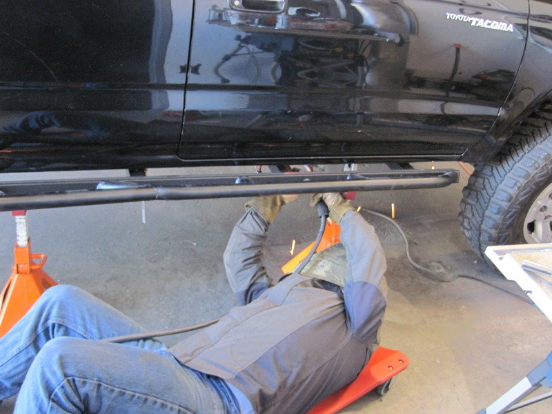

    Got set of BAMF sliders made, he just finished them this week so I'll be installing those as soon as I get a chance. Can't wait! This is the mod I wanted before I started really wheeling it.

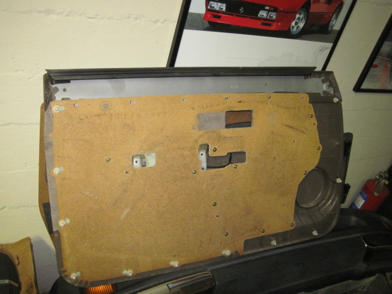

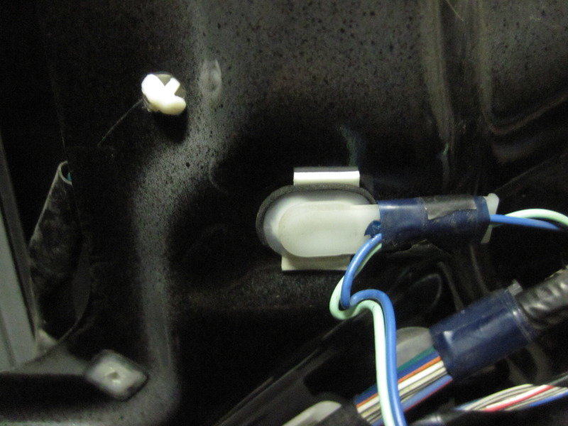

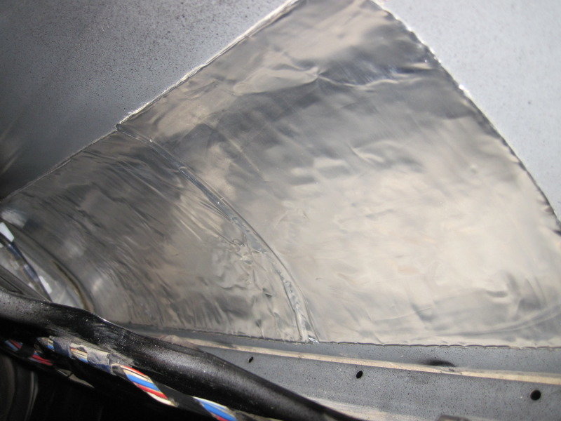

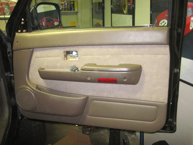

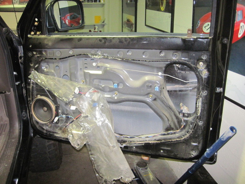

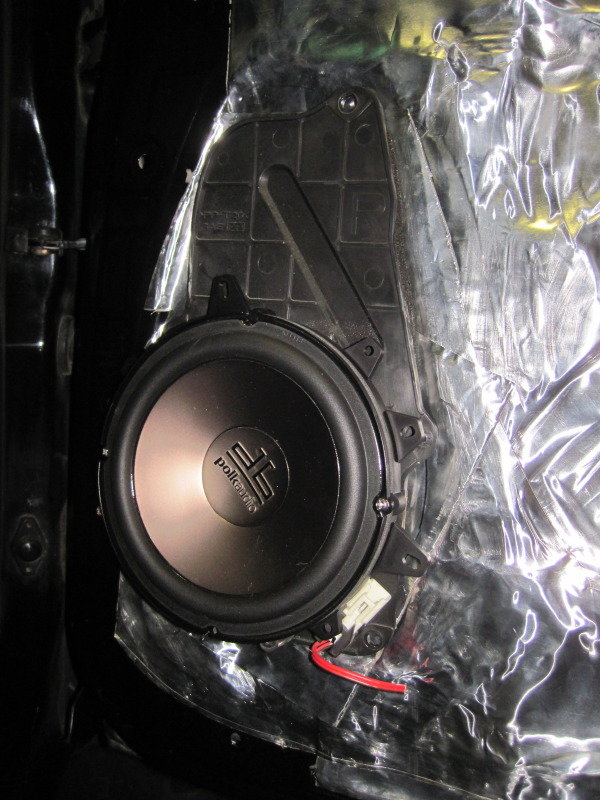

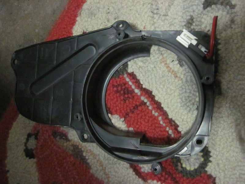

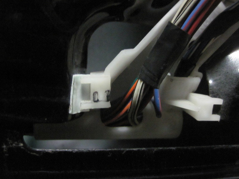

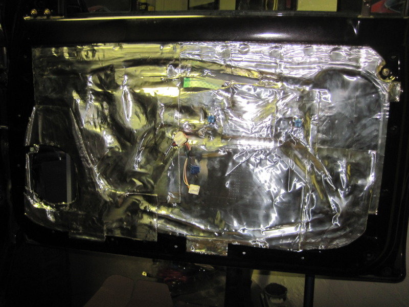

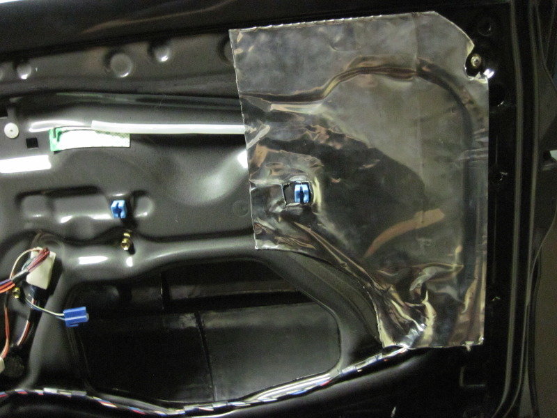

    Day 1 - Sound deaden doors

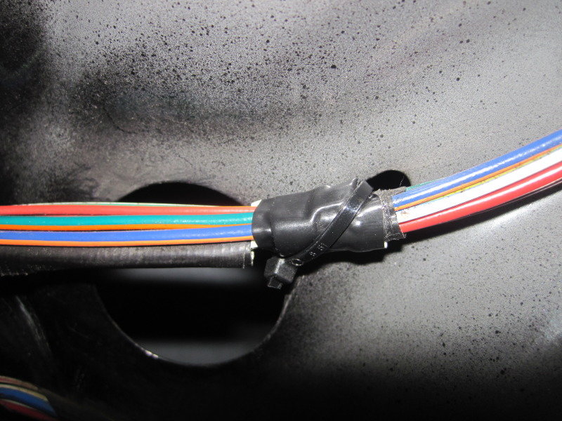

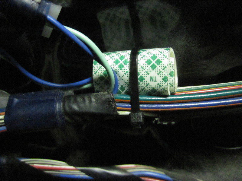

    I added foam tape at most mounting points between the wiring clips and door sheet metal to eliminate play and potential vibration. It made them nice and snug and insulated.

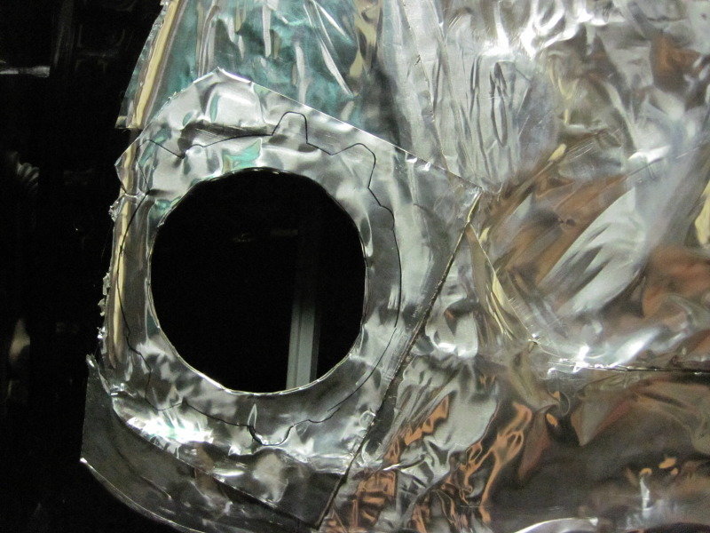

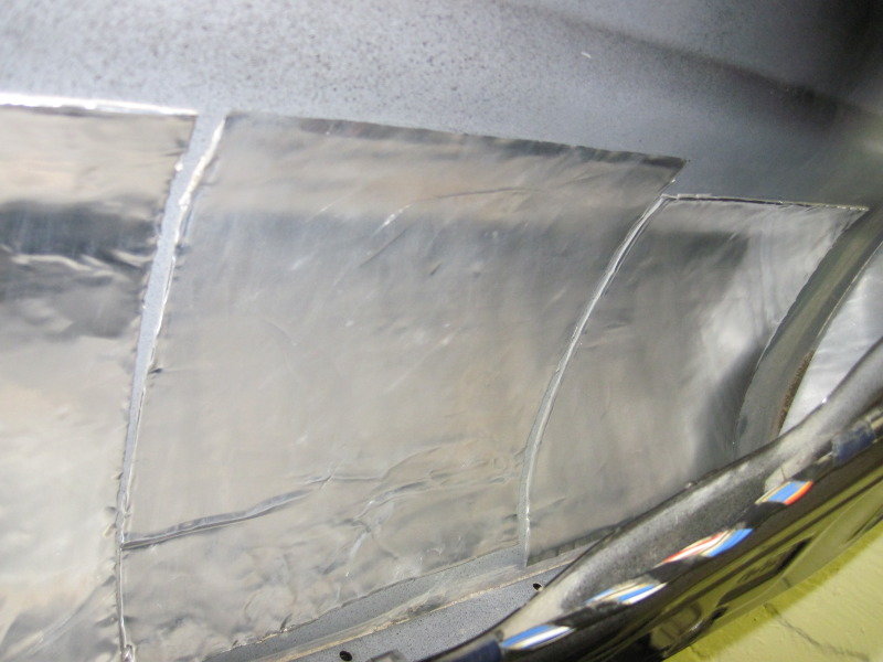

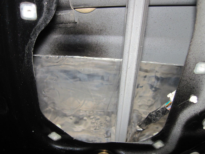

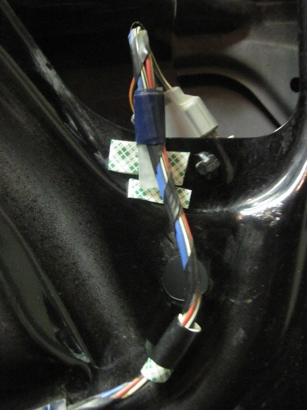

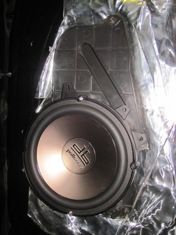

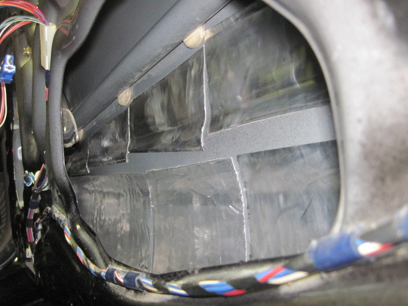

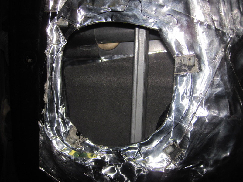

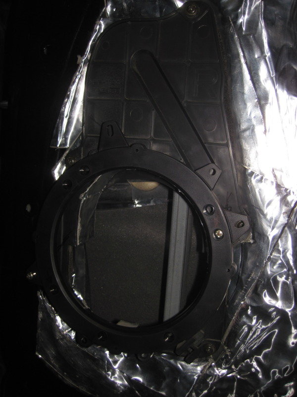

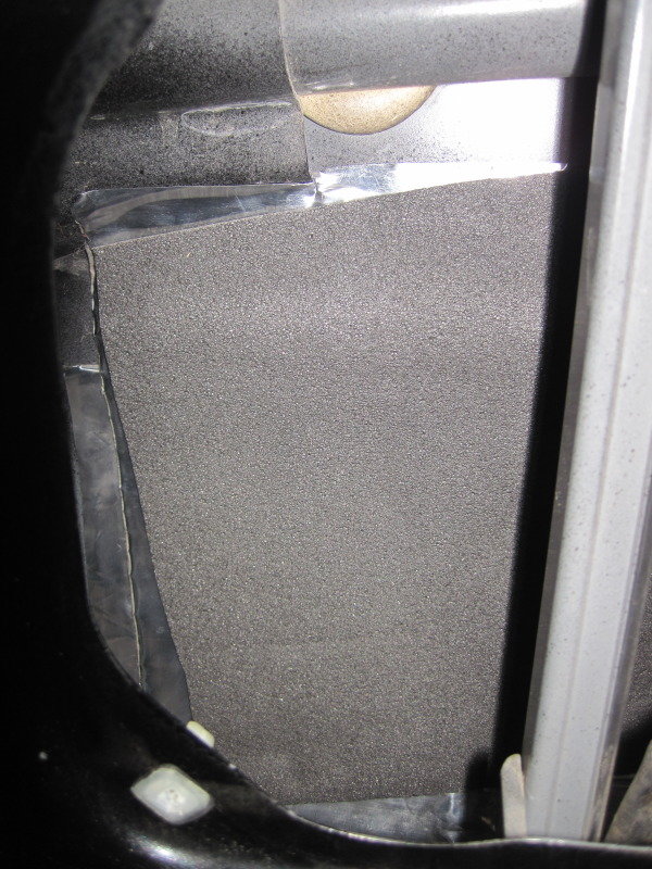

    Added ensolite behind speaker and sealed off the inside door surface with BXTII. In hindsight I would seal off the holes with mesh but I was sick of going to the store over and over so I just used several layers of BXT until it was decently rigid.
    You can see how the door hole for the stock plastic speaker mounting plate was as big as the whole mounting plate. I filled in the hole with BXT leaving only enough space for the actual speaker and then mounted the speaker mounting plate on top of it.

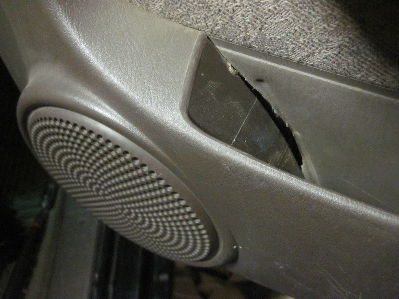

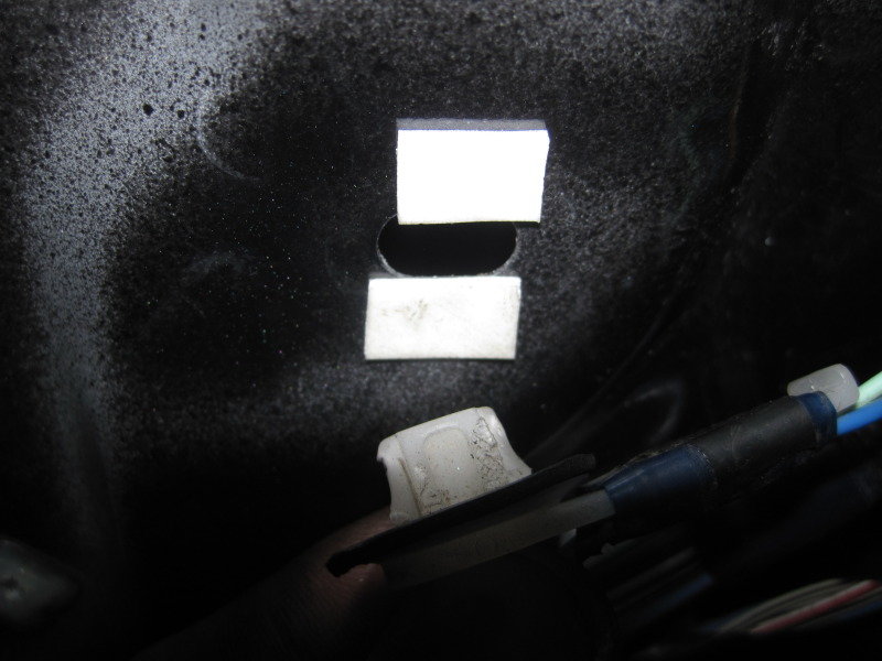

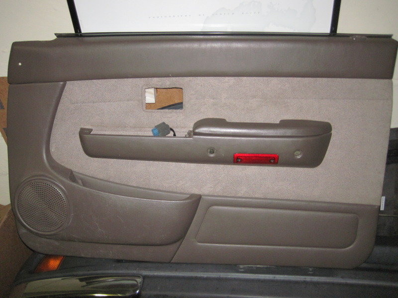

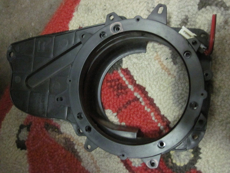

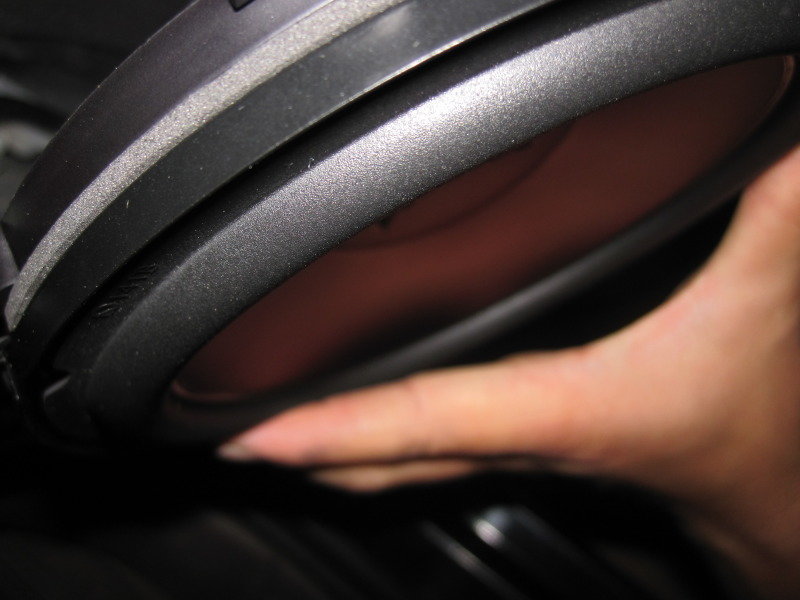

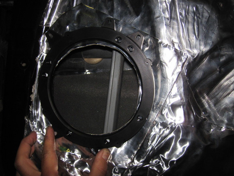

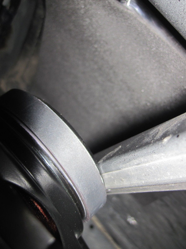

    the supplied speakers rings are pretty crappy and only a few of the holes actually line up in a useful manner. I'm pretty sure I'm going to switch this out for MDF rings really soon. I don't have access to or experience with a router so I'm just going to proceed for now to get the whole system together first. I think I'll learn to use a router to make my first set of sepaker rings after it's all together and working. I also used small scraps of BXT on some of the plastic surfaces.
    Here you can see where I added foam tape to insulate the latch rod and covered it in refrigerator water tubing to ensure there are no rattle and squeaks. ANY obvious potential interior rattle/noise sources were eliminated. Was it enough? Probably not...

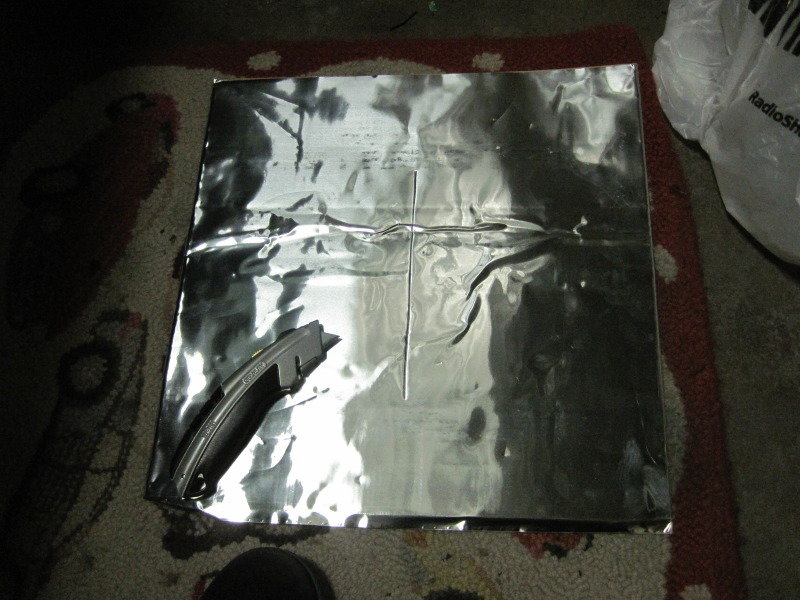

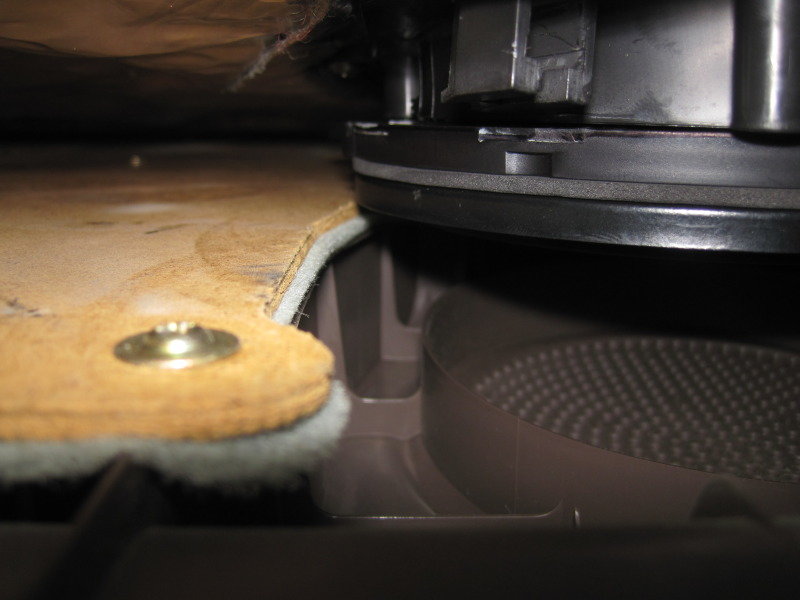

    the speaker didn't quite fit under the door panel so I dremeled some of the fiberboard to make room. I am an idiot because I didn;t pay attention to the door's construction and cut off a little too much and now you can see it from the interior. that's what I get for being a hasty noob at 3am!
    I used a total of 84 square feet of RAAmmat on the ONE door! I probably over did it, but the truck has LOUD offroad tires and I have plenty of material so I figure it couldn't hurt. Besides the crappy plastic mounting panel and cutting up the door panel like a fool, did I miss anything? I'm more and more convinced I need to get some MDF rings and I haven't even heard it yet. for the time being I'm going to sandwich Ensolite between the speaker rings and plastic speaker mount and hope it helps. A nagging voice in my head keeps saying the midbass response is going to suck the way it is now...

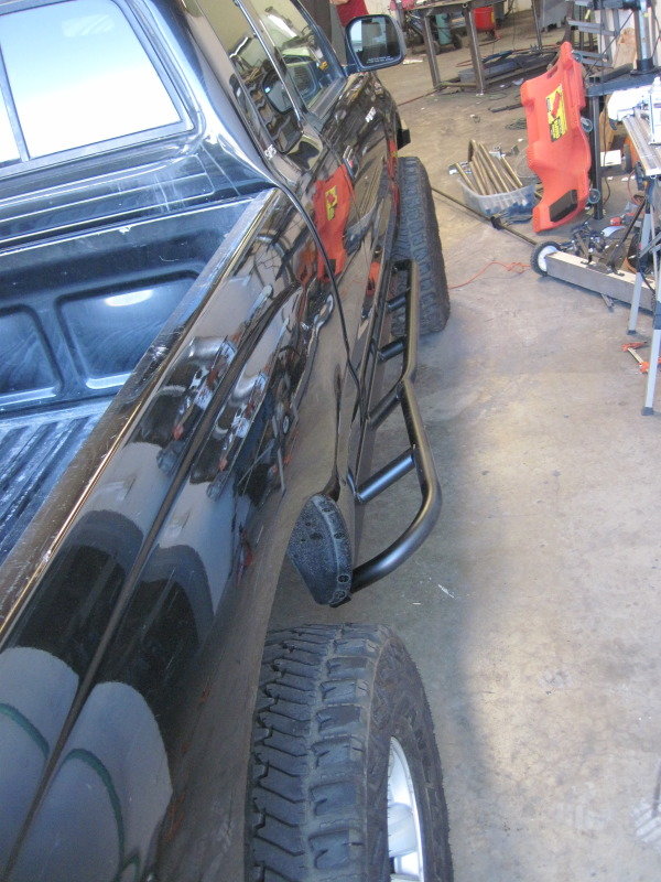

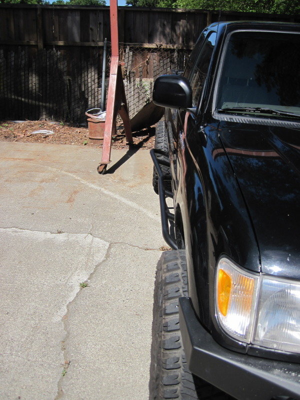

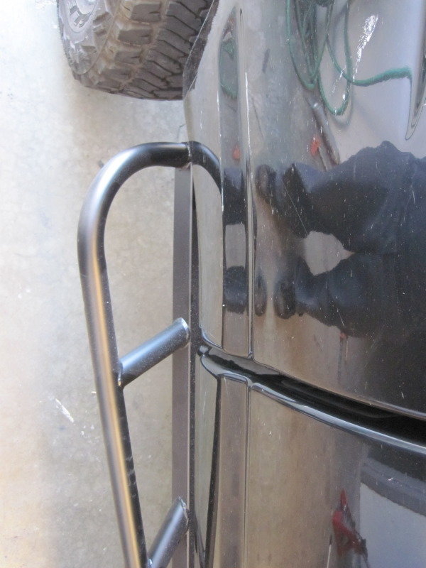

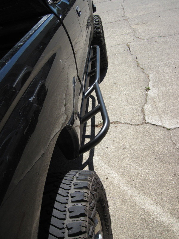

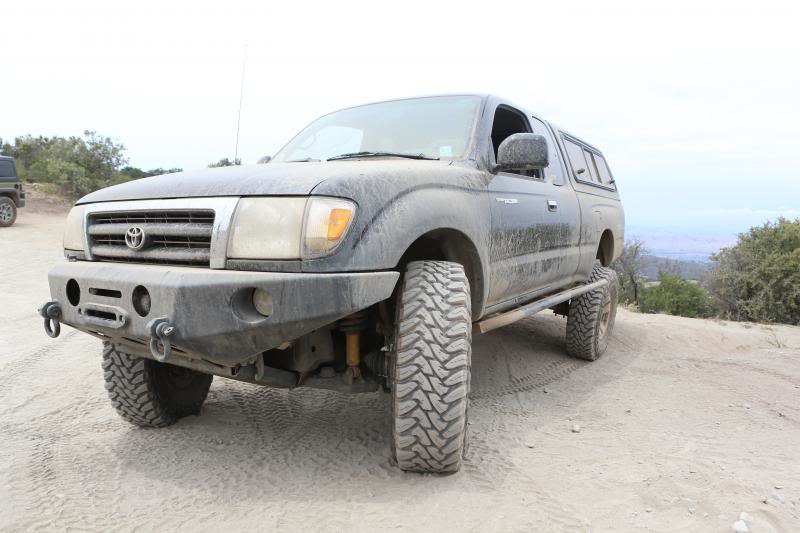

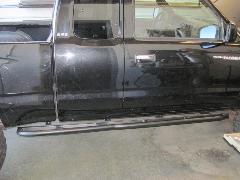

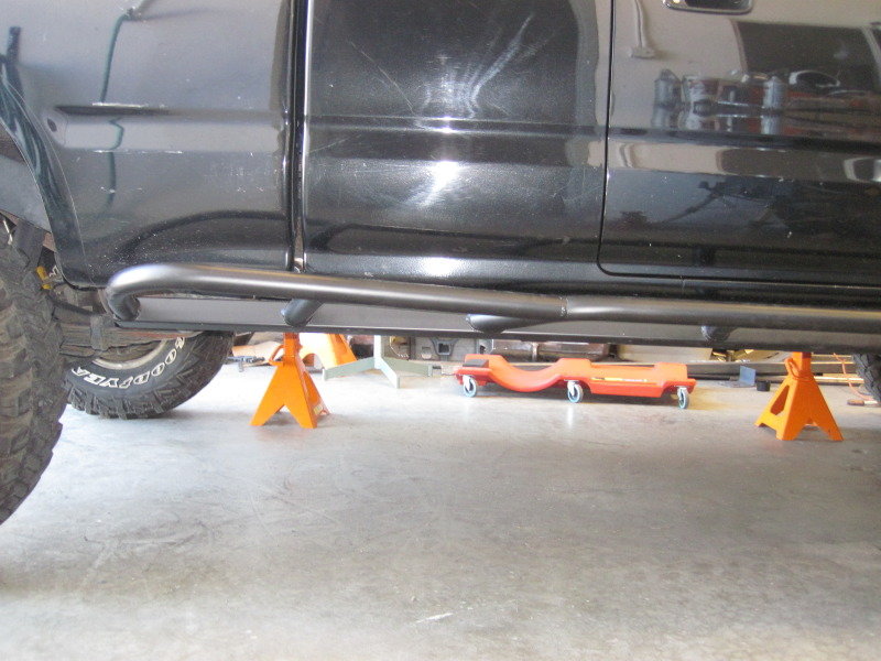

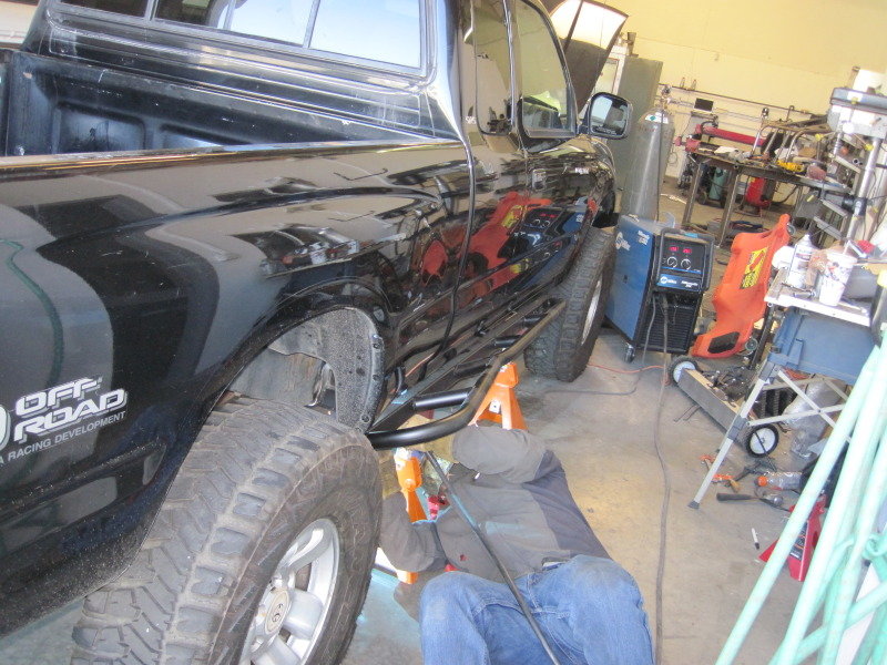

    Got some BAMF sliders welded on. Thanks JLee!

    02TACOMA4WD
    02TACOMA4WD Well-Known Member
    Jun 10, 2011
    #58073
    647
    02 Tacoma TRD 4x4
  9. Jul 31, 2012 at 3:22 PM
    02TACOMA4WD
    Jun 10, 2011
    #58073
    647
    02 Tacoma TRD 4x4

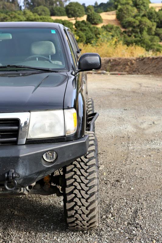

    What kind of front and rear bumpers are those?

    Cool! Someone gives a shit!
    The front is Elite, the rear is Front Range Offroad.

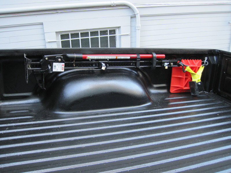

    I Herculined the bed and mounted my Hi Lift :)

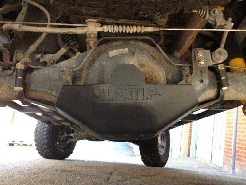

    Gave the rear end some love...
    BAMF diff skid, BPV relocate bracket (yeah I know I need to paint it, I just forgot about it while doing the skid), and Trailgear diff. breather thingy.

    You going to the burn this year?
    Are your BAMF sliders regular? They seem to stick it out a little far...
    Sick truck.

    Yes I am, busy week getting everything ready. They are kick out sliders. Thank you!

    I know they're kick-outs, but are the arms from the frame longer than normal? That's what I was asking...:bananadance::D
