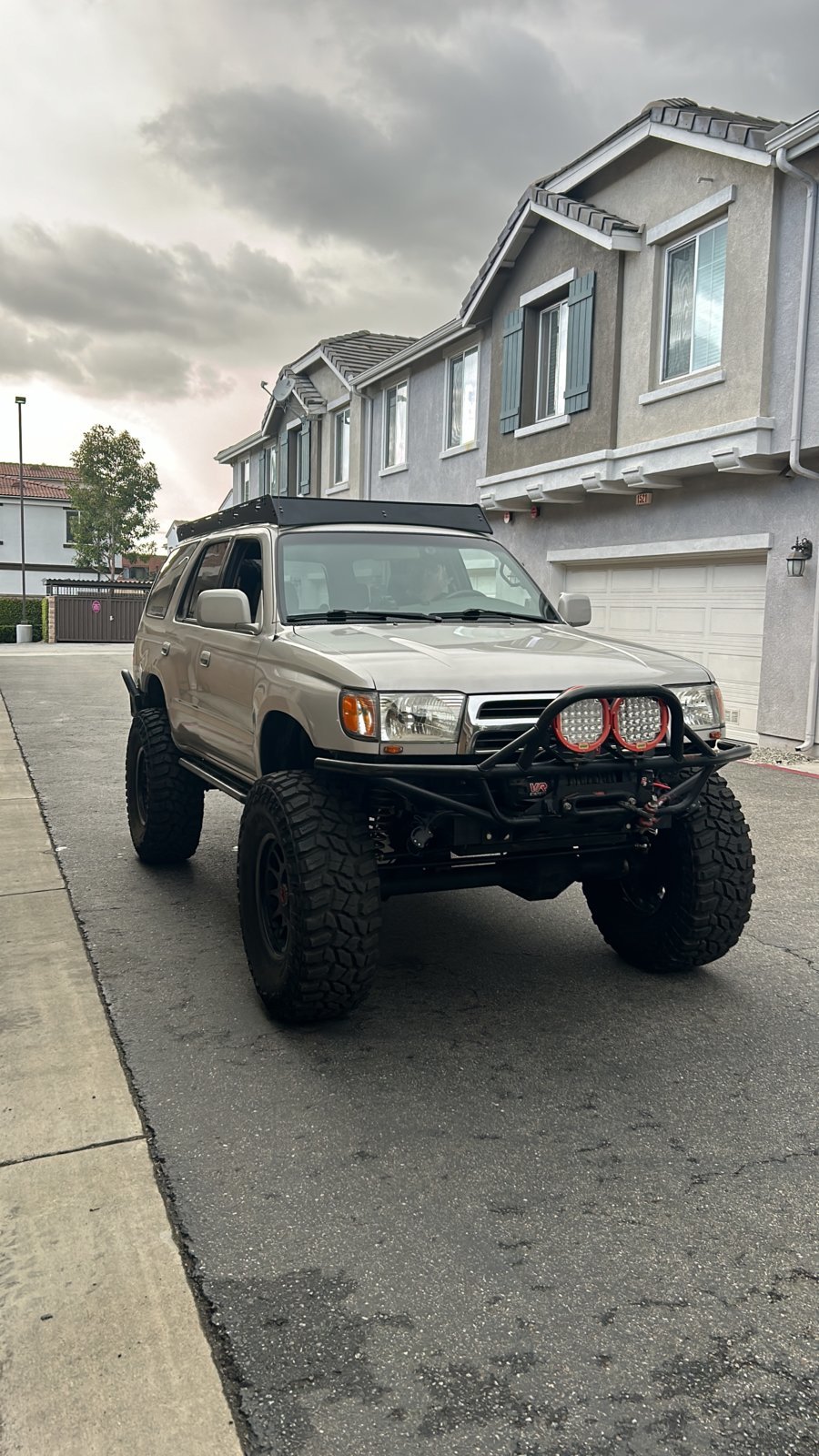

    Hey what up man! The truck belongs to my homie @campygilmore on instagram. He will be heading this upcoming weekend to KOH so the lights will help out at the dust bowl. He mentioned he has some trips up in NorCal and Utah.
    as always, @Baja Designs are way to go. Keep those amazing products rolling!

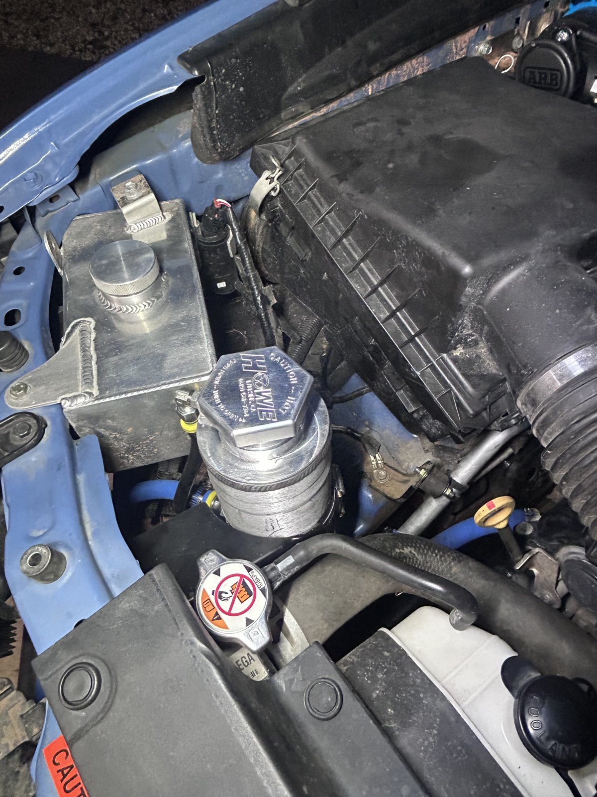

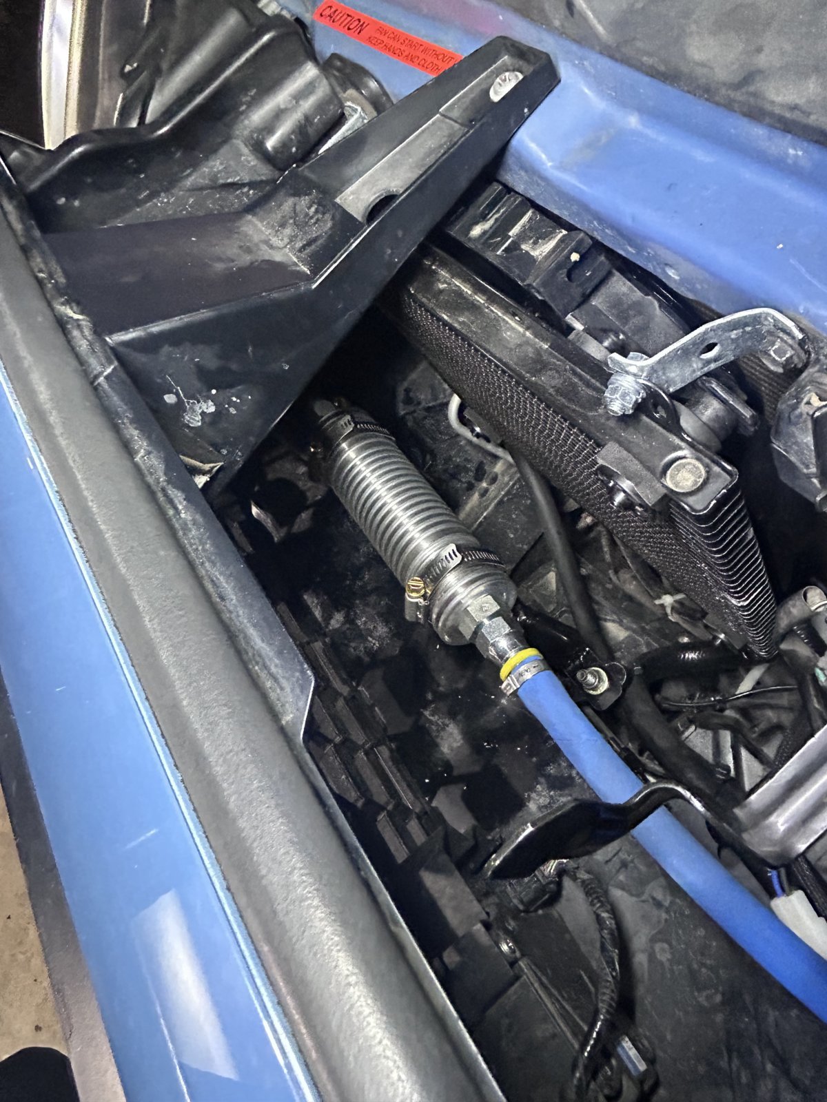

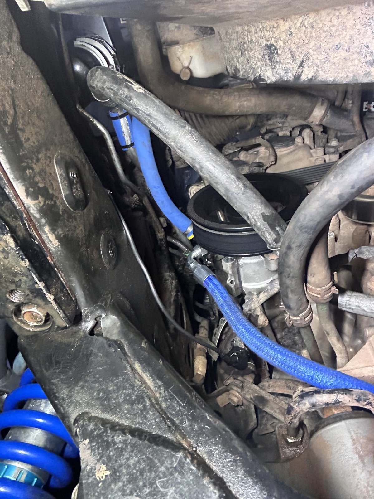

    Big brother @lit_taco4x4 dropped off his truck to get the JD Fabrication upgraded Howe steering pump kit. Be mindful kit comes with everything needed to include the re route coolant lines but the AC Delco fluid. truck moves those 39”s like the stock Tacoma on 30”s.

    it’s a must with chonky tires. Now moving like butter and those pesky steering wheel feedback from the smallest bumps are completely gone. Got that Porsche steering feel! Thanks Ricardo!!!

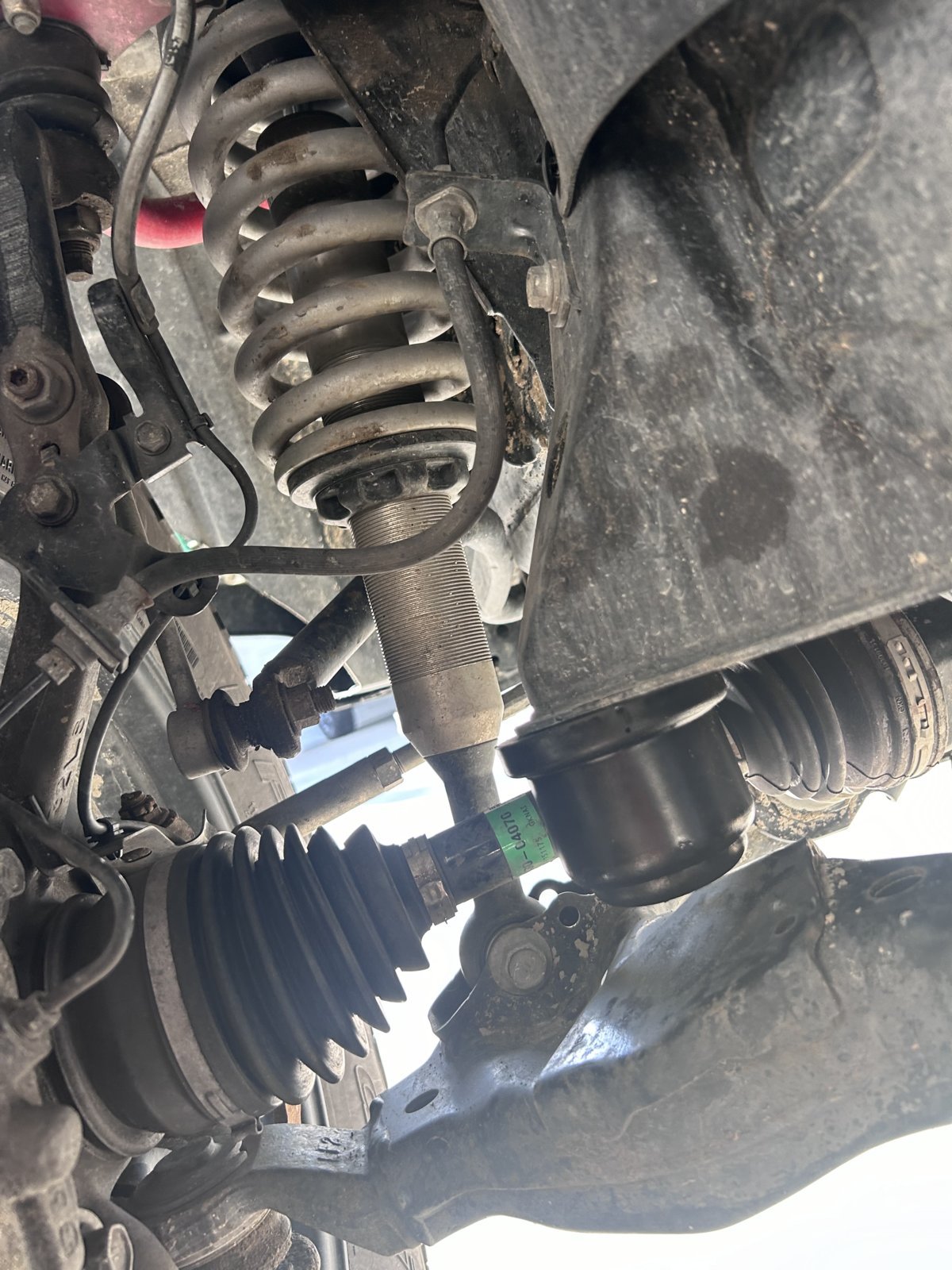

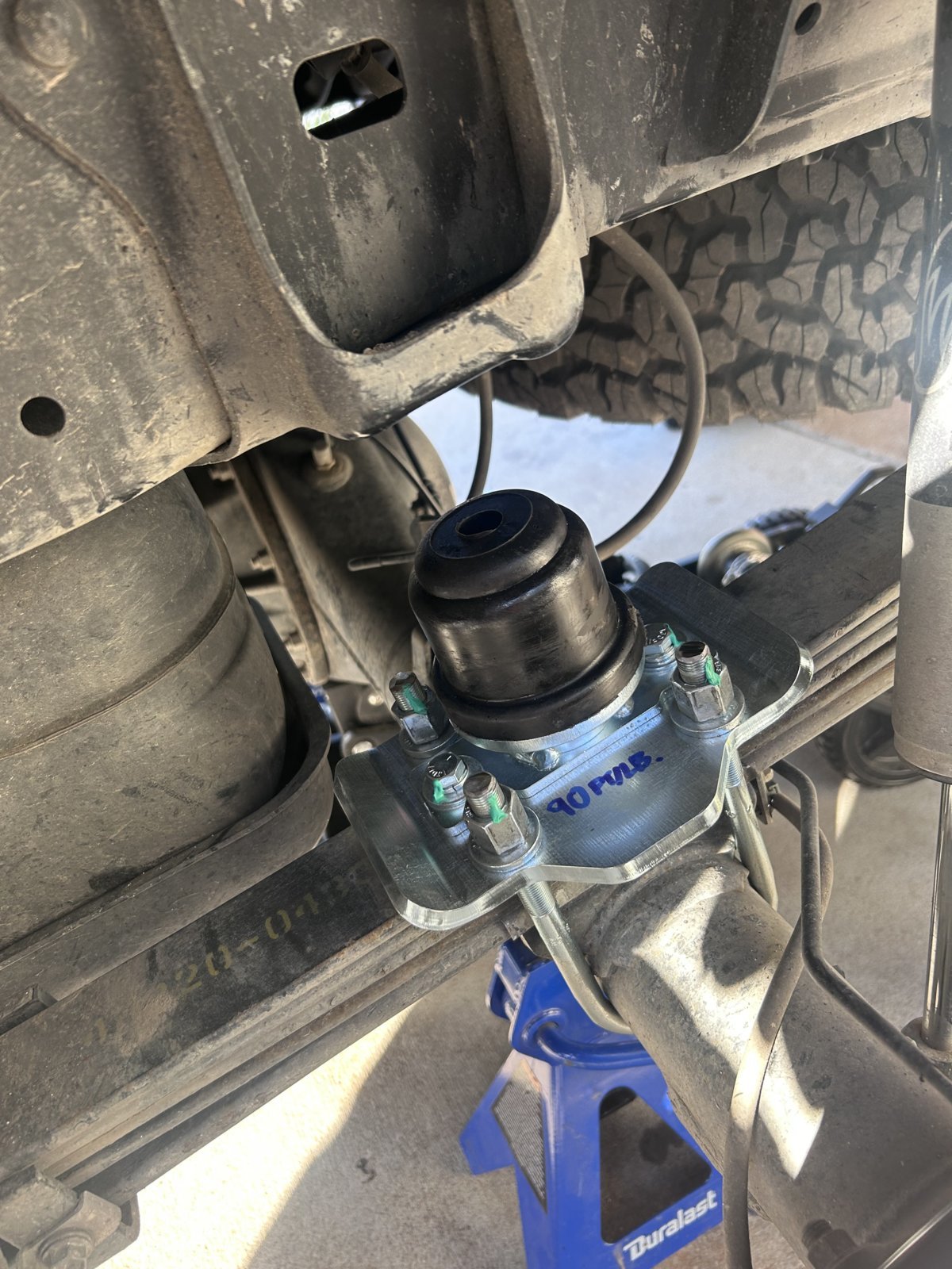

    Homie Jason stopped by to get his super bump by wheelers/trail gear installed on his truck, he realized the importance of bump stops after some harsh miles down at KOH. We spotted some bent tabs and we’ll be addressing that with some cam tab reinforcements and while we are there we’ll be doing some Whiteline LCA bushings and JD fabrication spindle gussets.IMG_3136.jpg IMG_3137.jpg IMG_3138.jpg

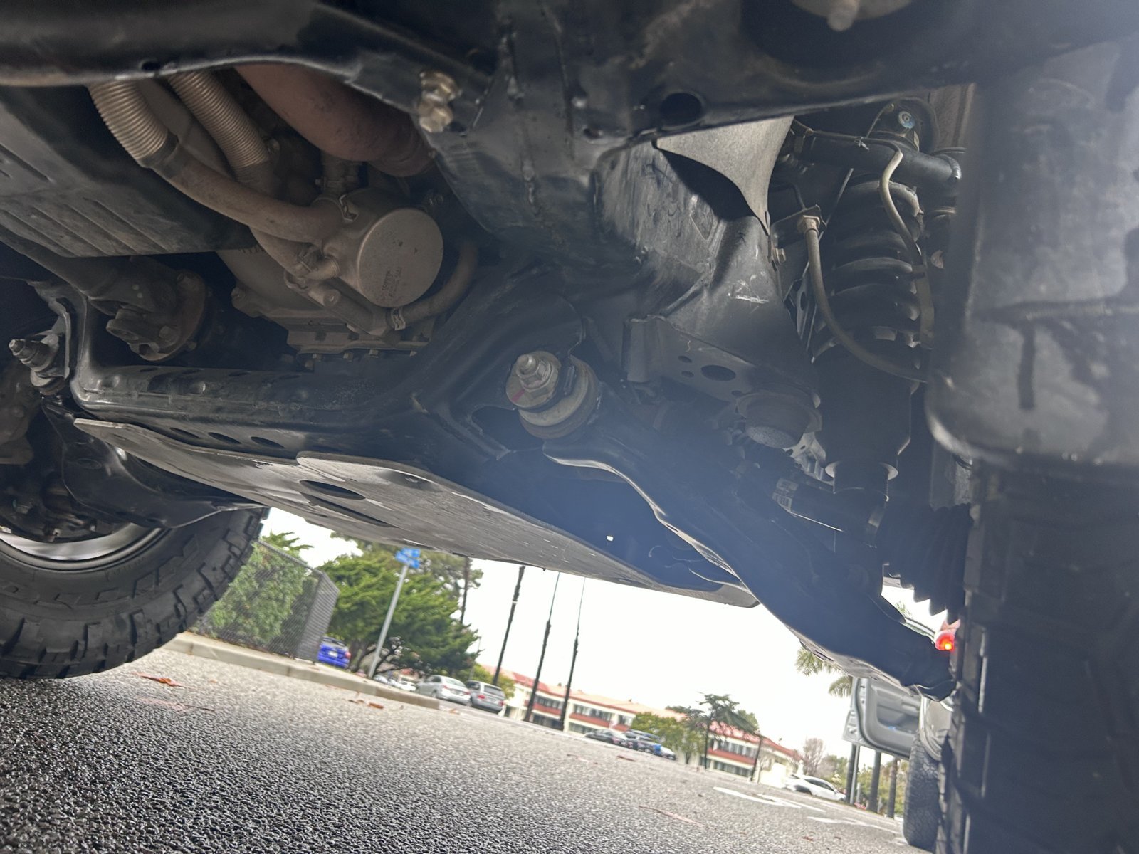

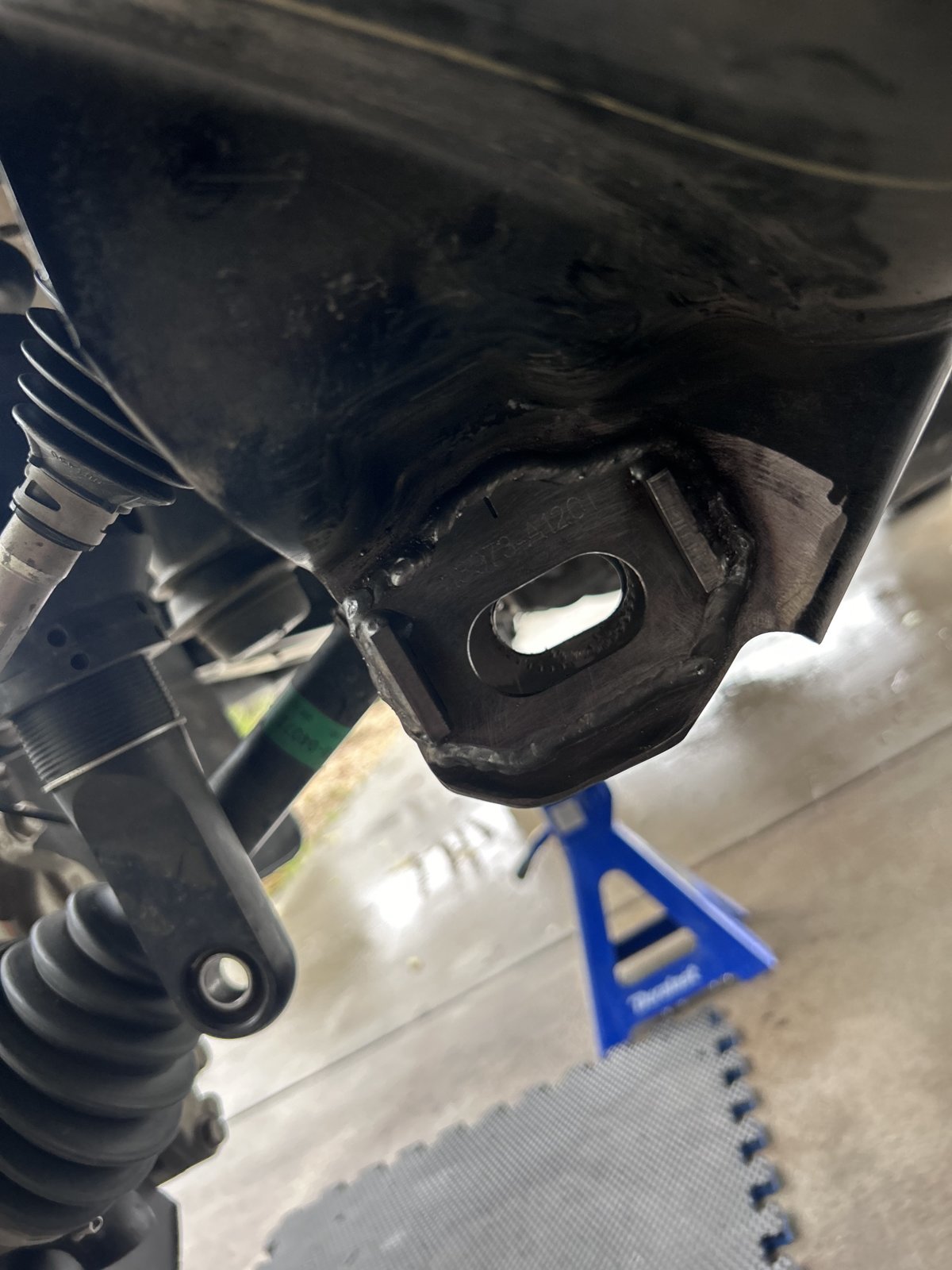

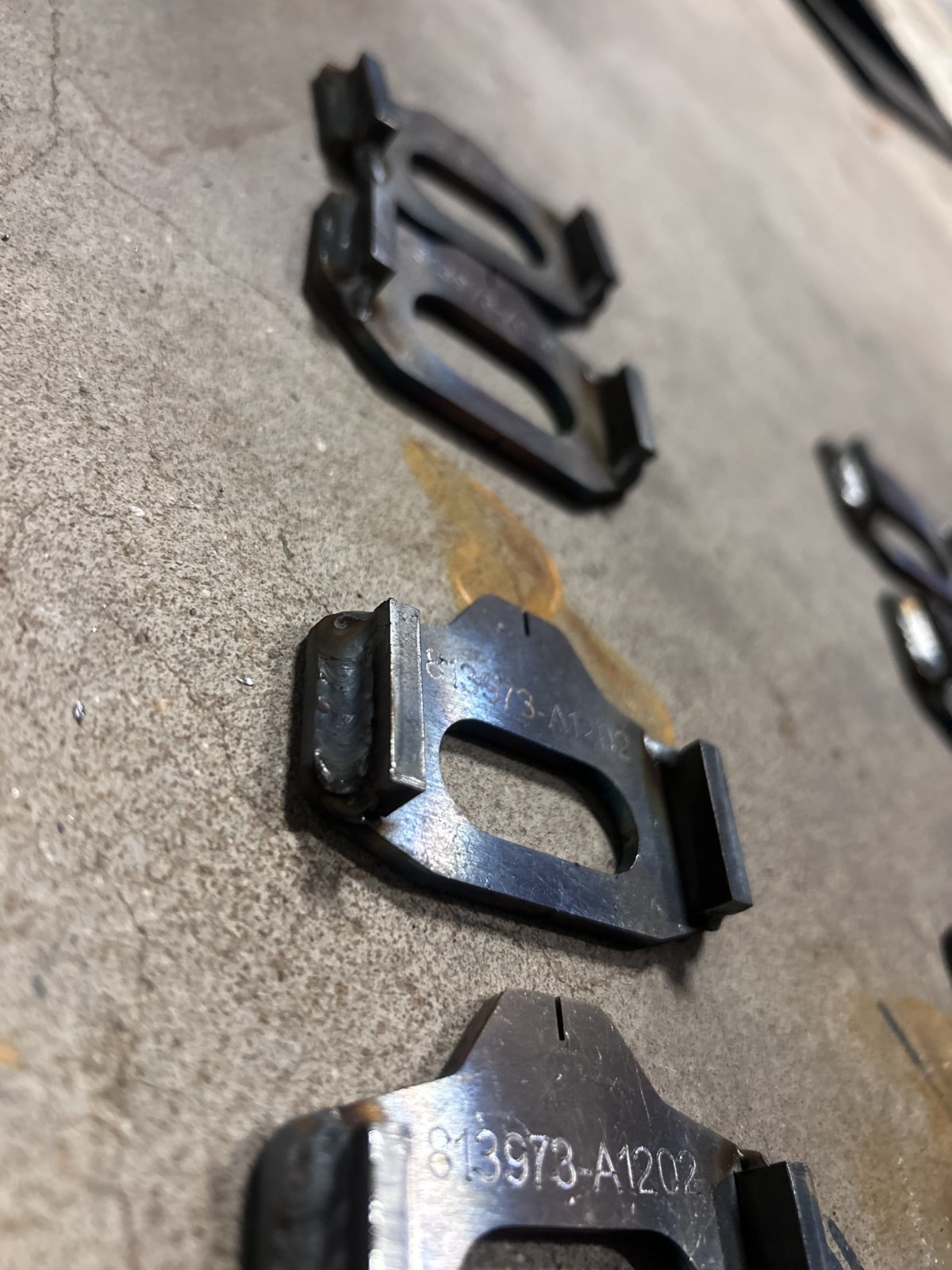

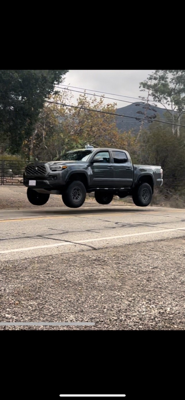

    Brandon stopped by to get his cam tabs addressed due to some issues upon landing mixed with a shop leaving everything on the suspension hand tight.
    truck is solid now.

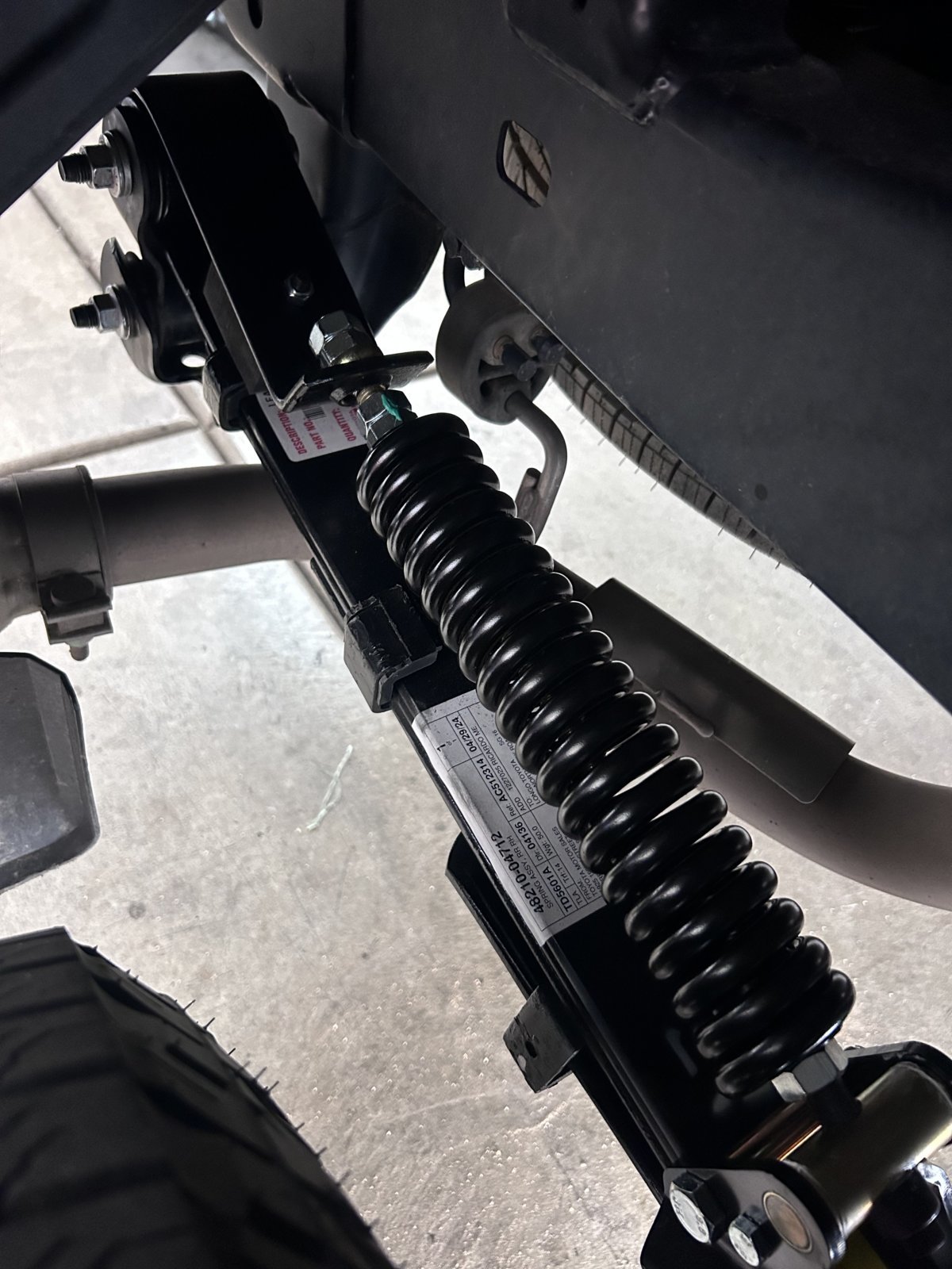

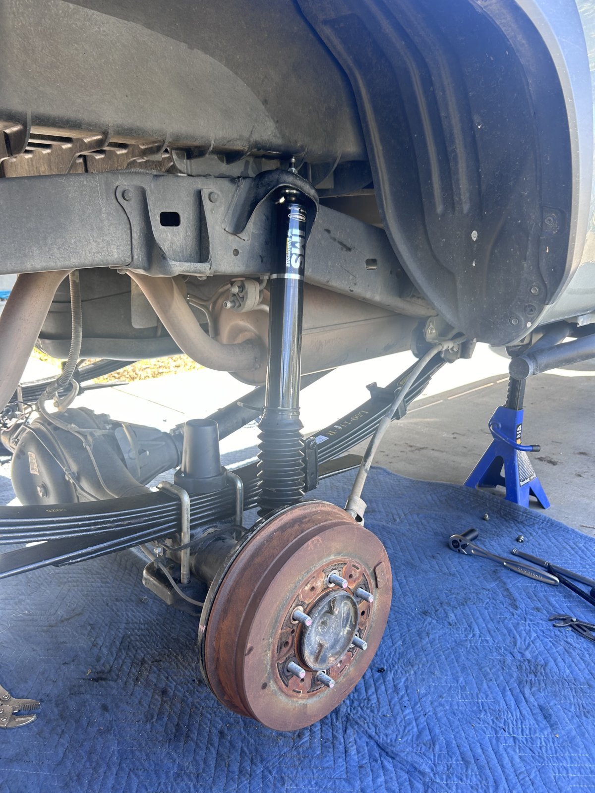

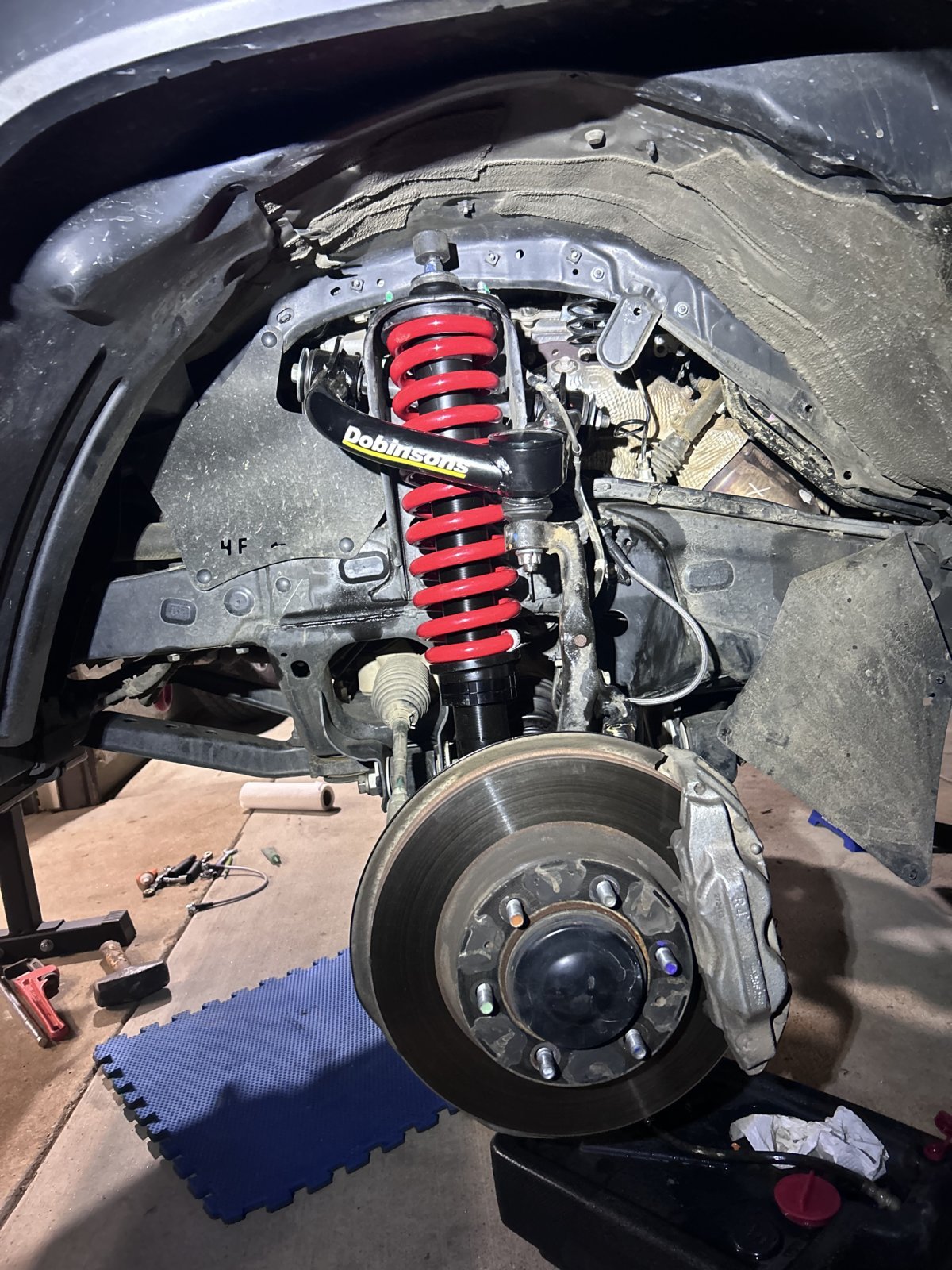

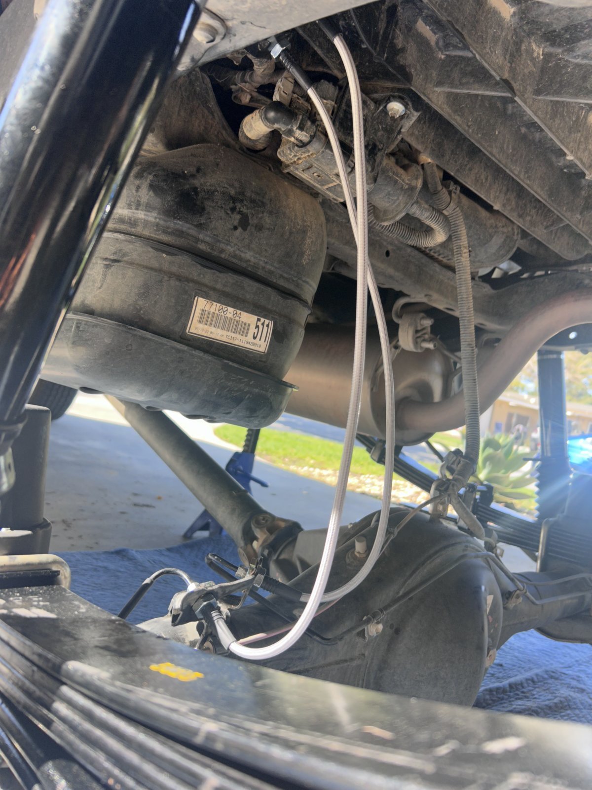

    Bethany stopped by to get her @dobinsons IMS suspension, paire with some @durobump bumpstops and @Apache off road extended braided brake lines installed to include a set of @Kwikvette stiffies with 8 grade Hardware. Truck is ready for the fat tires and some harsh miles :fistbump:

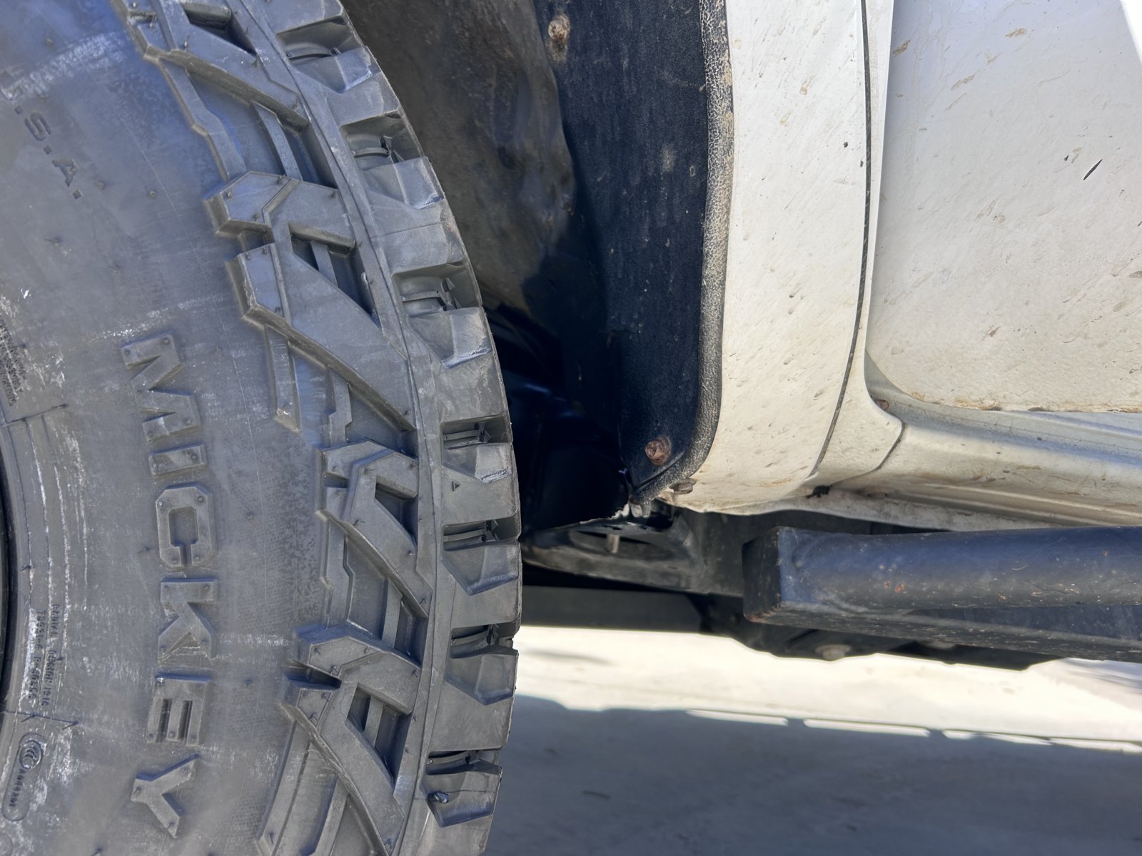

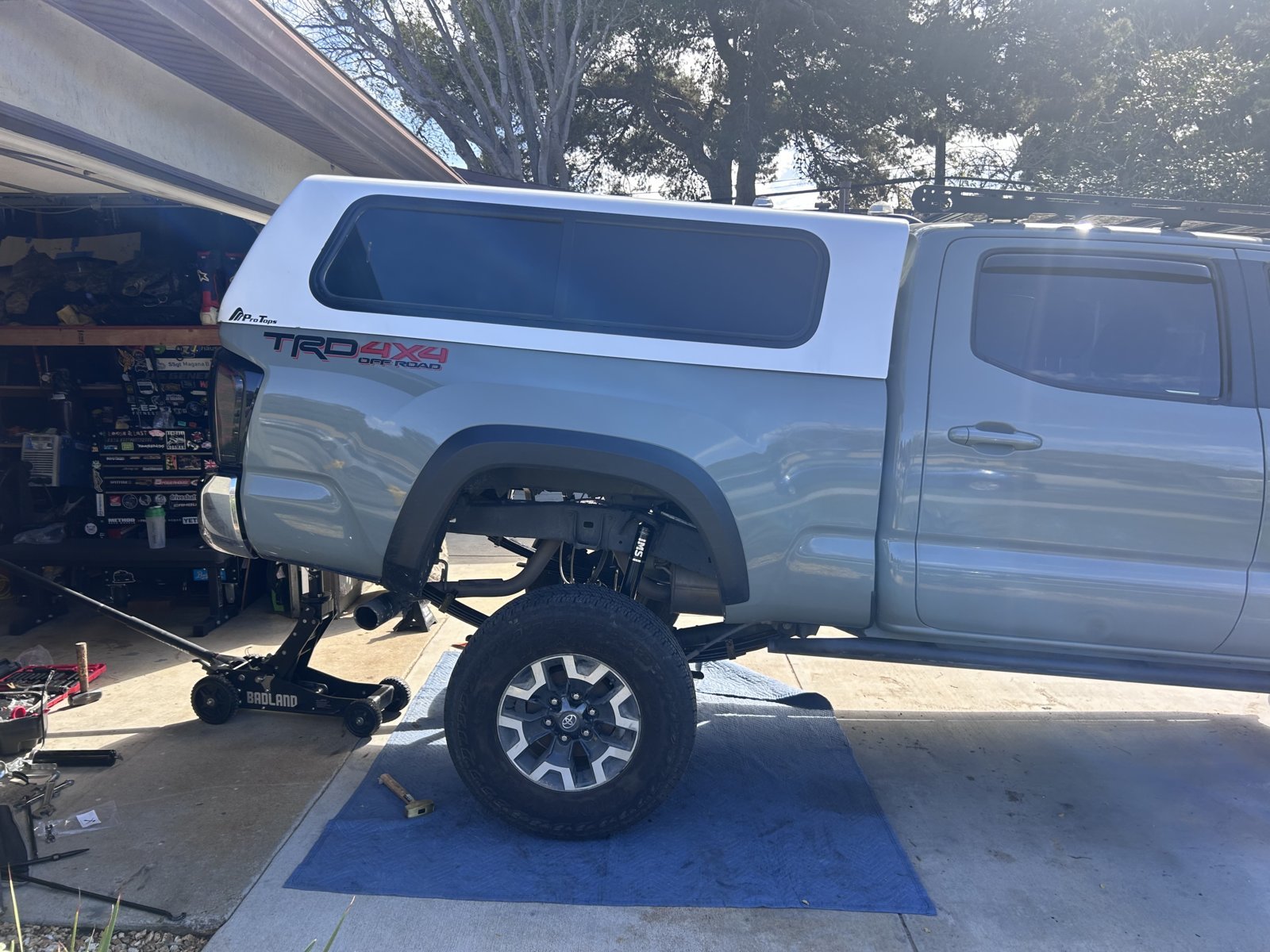

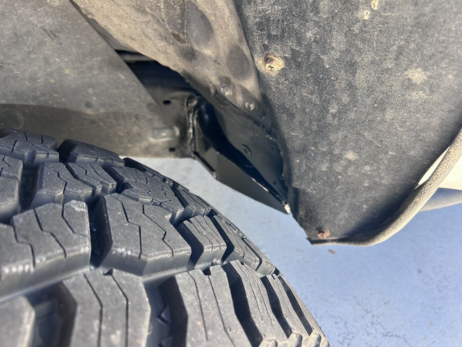

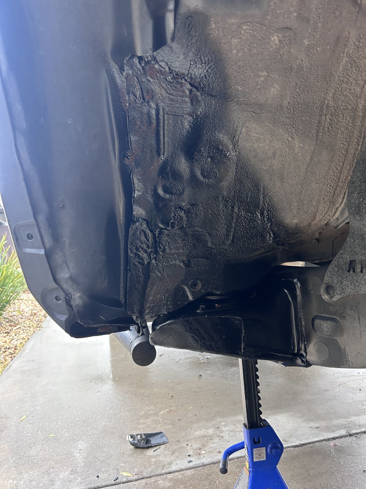

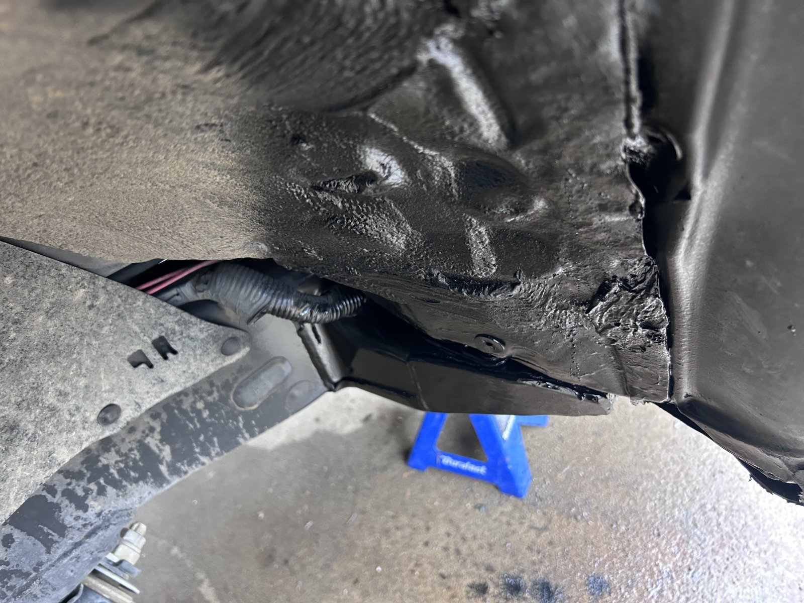

    @powder1134 stopped by to get his BMC just in time after he installed his badass Mickey Thompson tires that were having constant meetings with the body.
    That truck is on point my dude :fistbump:

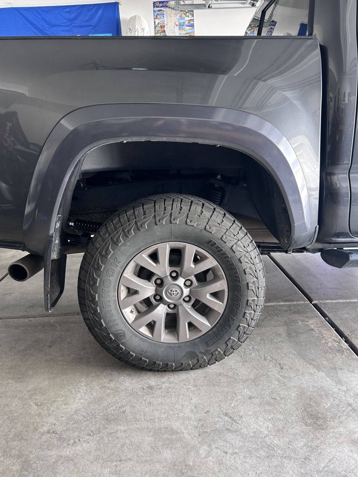

    Toy.coma on IG stopped by to get his BMC prior to install his 35”s. Tips were given and we’ll see how his journey goes.

    Thanks again man! Really happy with the end result. Those spindles will be up next.

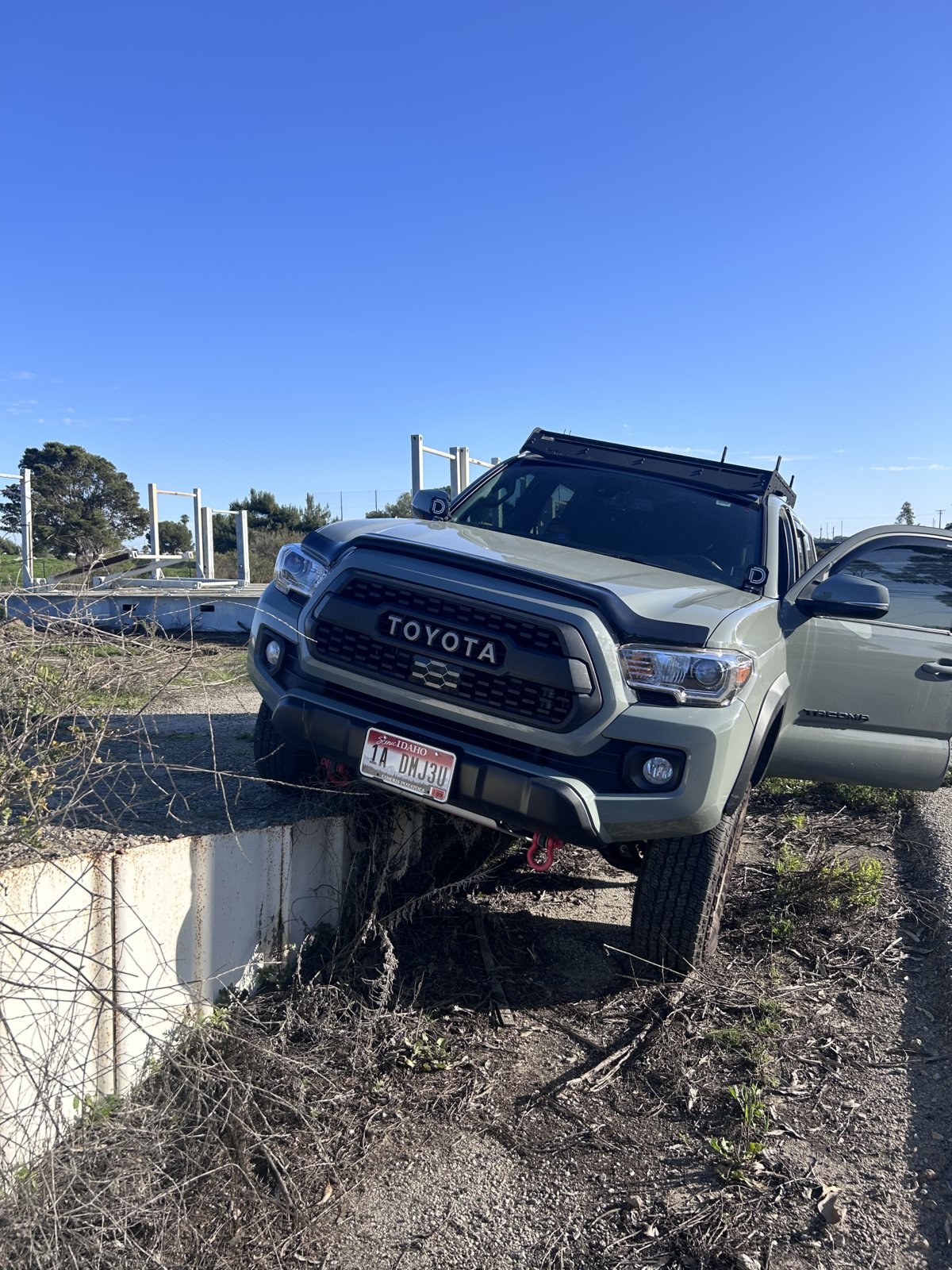

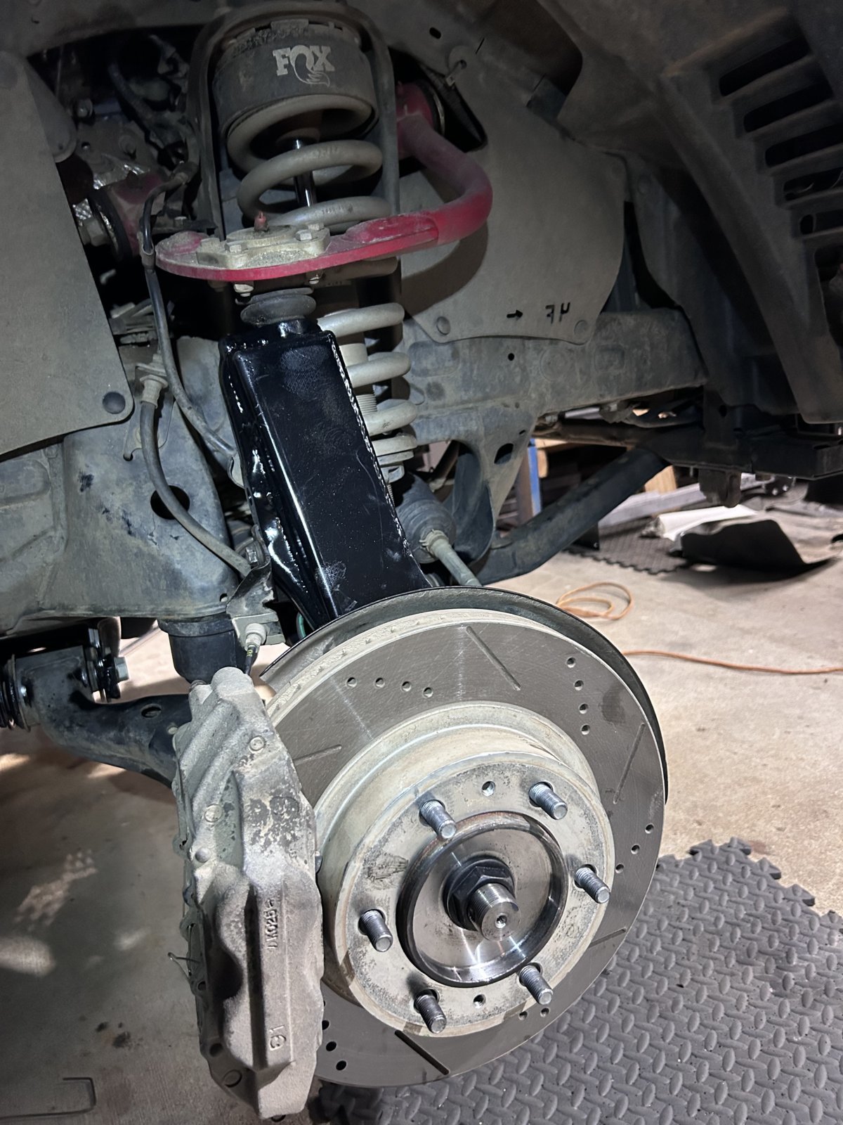

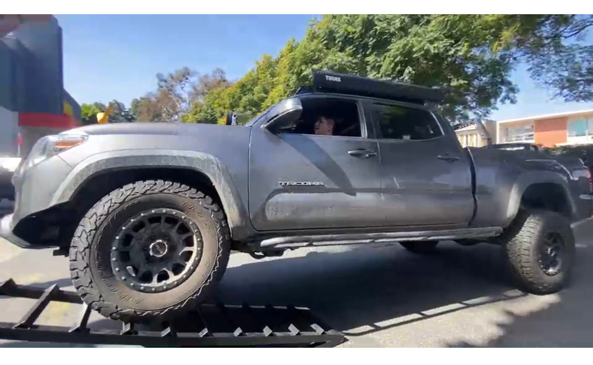

    Jason returned to get his JD fabrication spindle gussets fused in and some weld beads behind his OEM cam tabs. And mandatory sway bar delete mod. Took the truck for alignment and flexed his suspension for the gram. Truck is ready for some bashing.

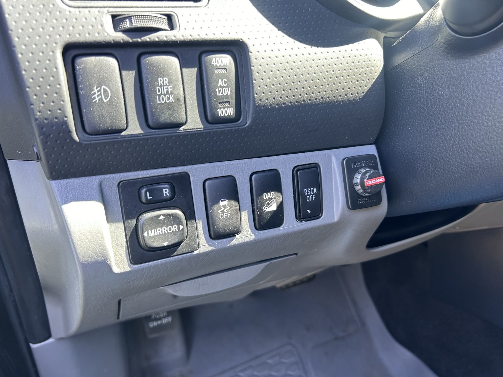

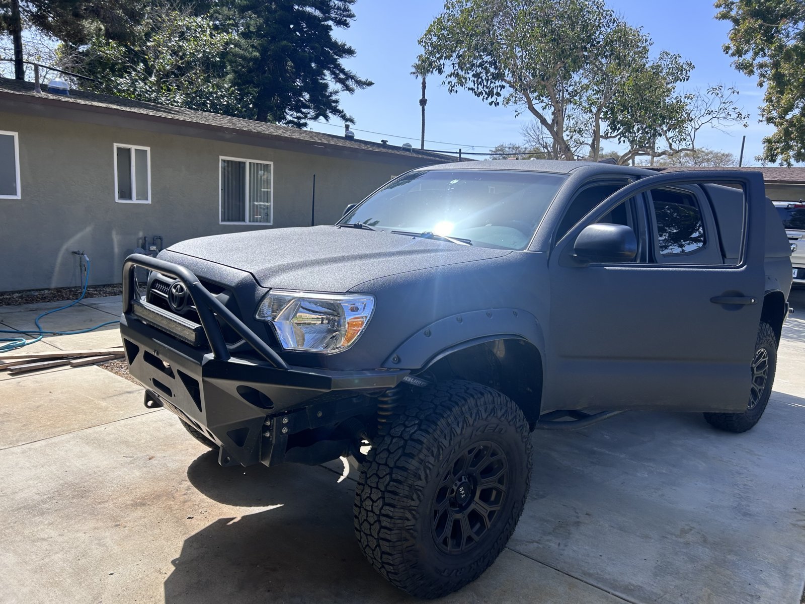

    @bhova stopped by with his badass to the bone truck! We installed a top of the line REDARC trailer brake system and completed the anytime fog lights mod to control those @Baja Designs as he wishes.

    Master mechanic/Tacoma enthusiast. Thank you Ricardo. All the evidence in this post that lead me your way was accurate. I’ll be scheming bigger projects for the future and know I’ll be reaching out to ya!

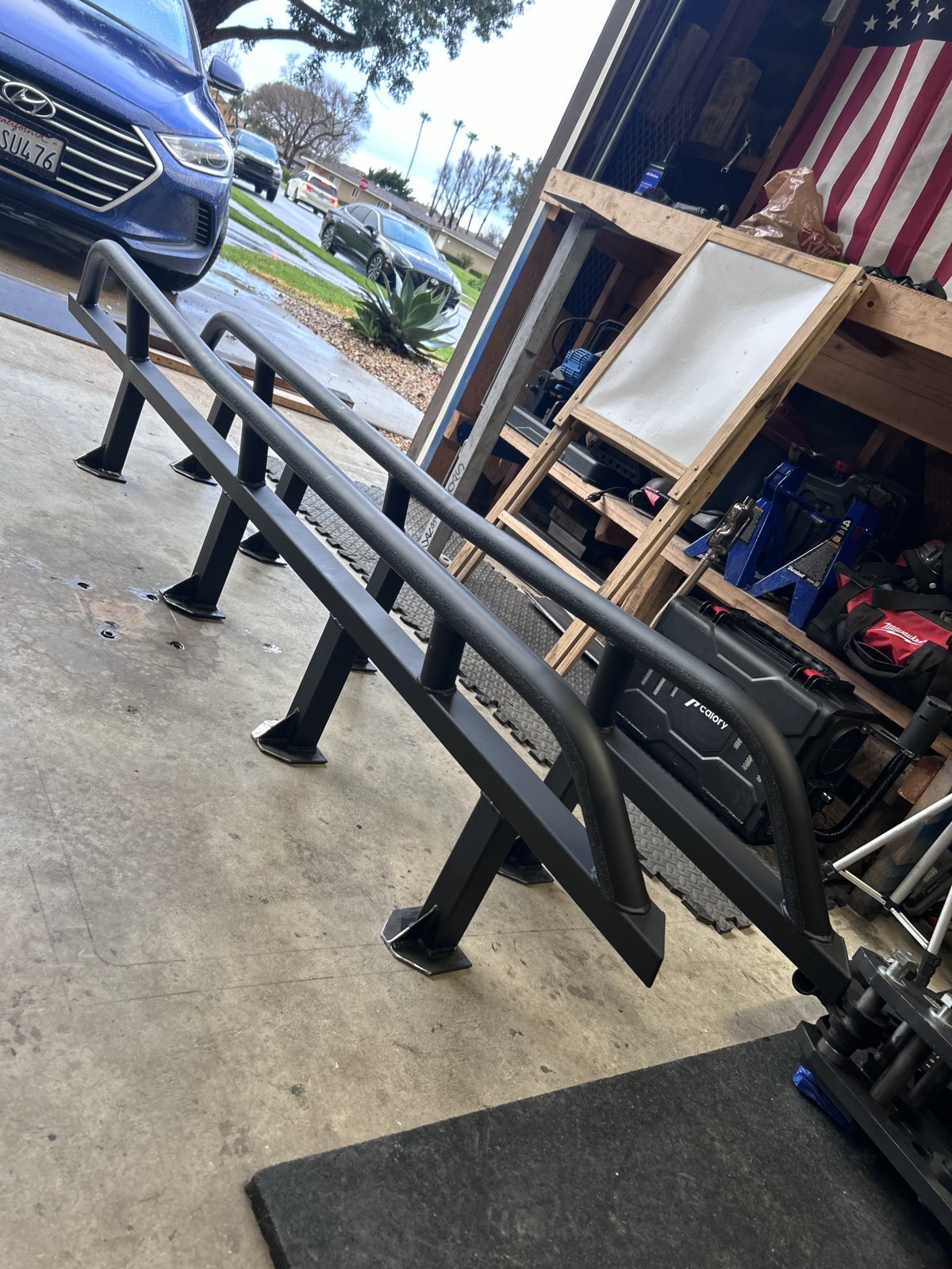

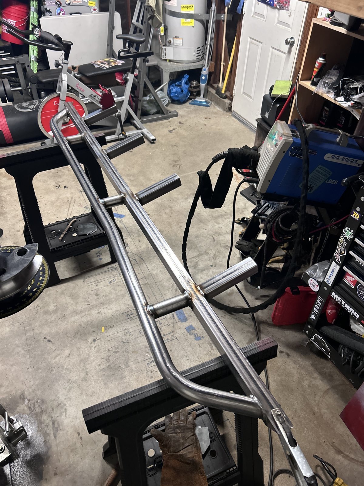

    Local homie Edgar snatched the last set of sliders I built for the Ventura county community. 2nd gen TRD Pro’s MT are always a sight to see.

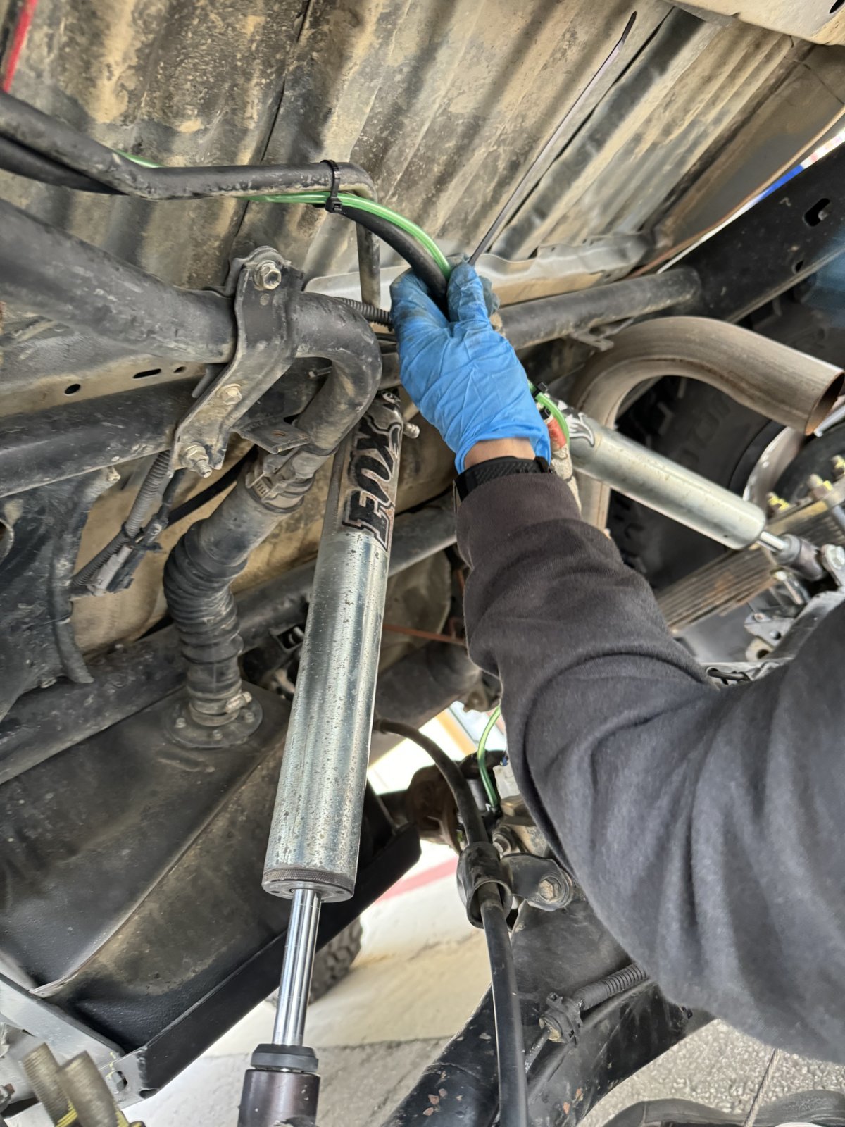

    1st. Surgery at my new place. My space/mission capabilities might be a little hindered but DM your enquiries and we’ll go from there. Fixed @lit_taco4x4 rear e-locker. One place, said it was wiring issues, one place said it was a mechanical issue within the locking mechanism inside the diff and the other did not touch and just lied about it. Anyway, serviced the motor, timed it and everything works as a charm now. Installed e-locker motor extended vent and front and rear diff extended vents. That SAS leaf sprung 3G4R is a beast!!!!

    thanks for squaring me away @Ricardo13x always with the solutions and recommendations.

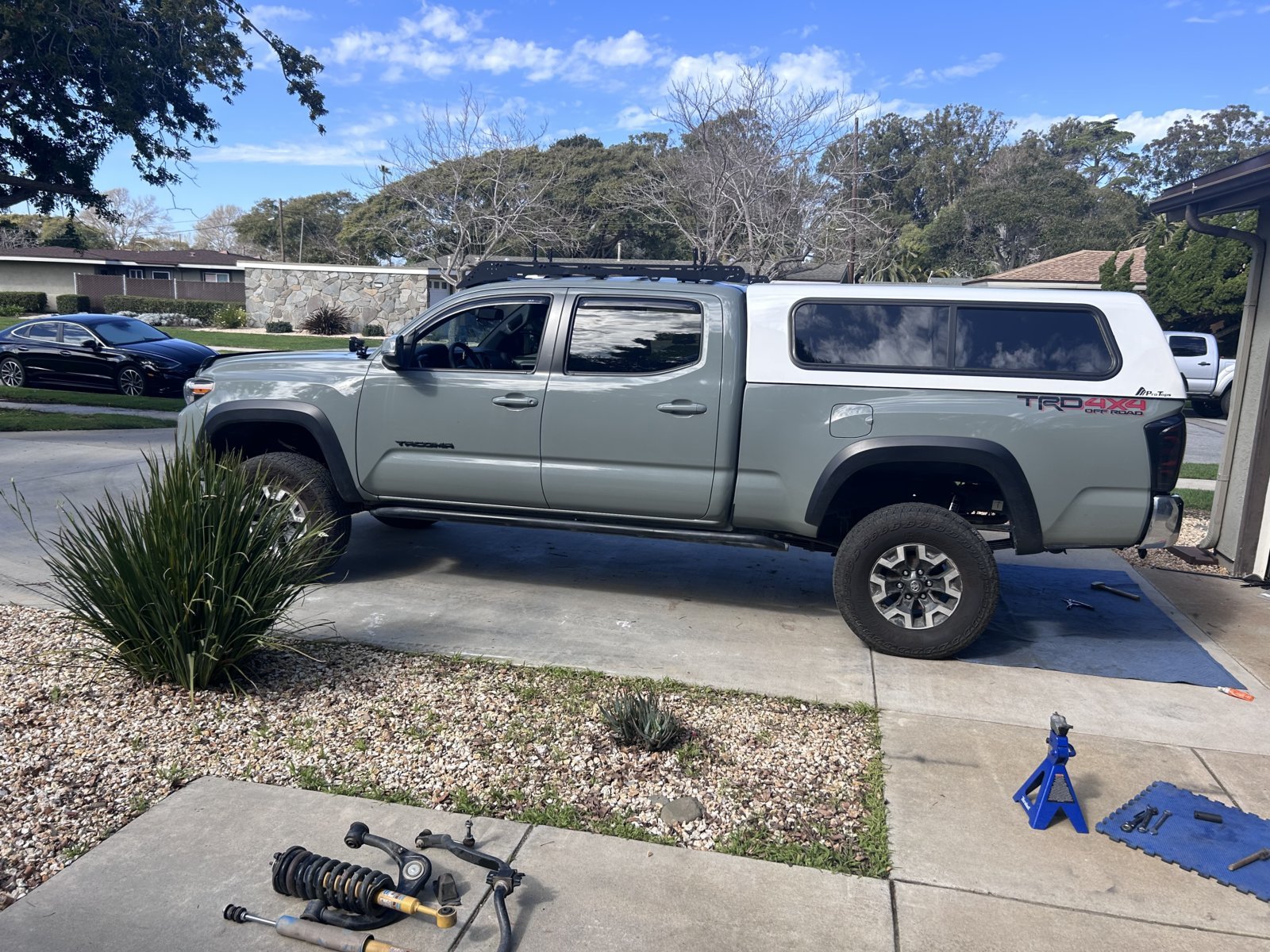

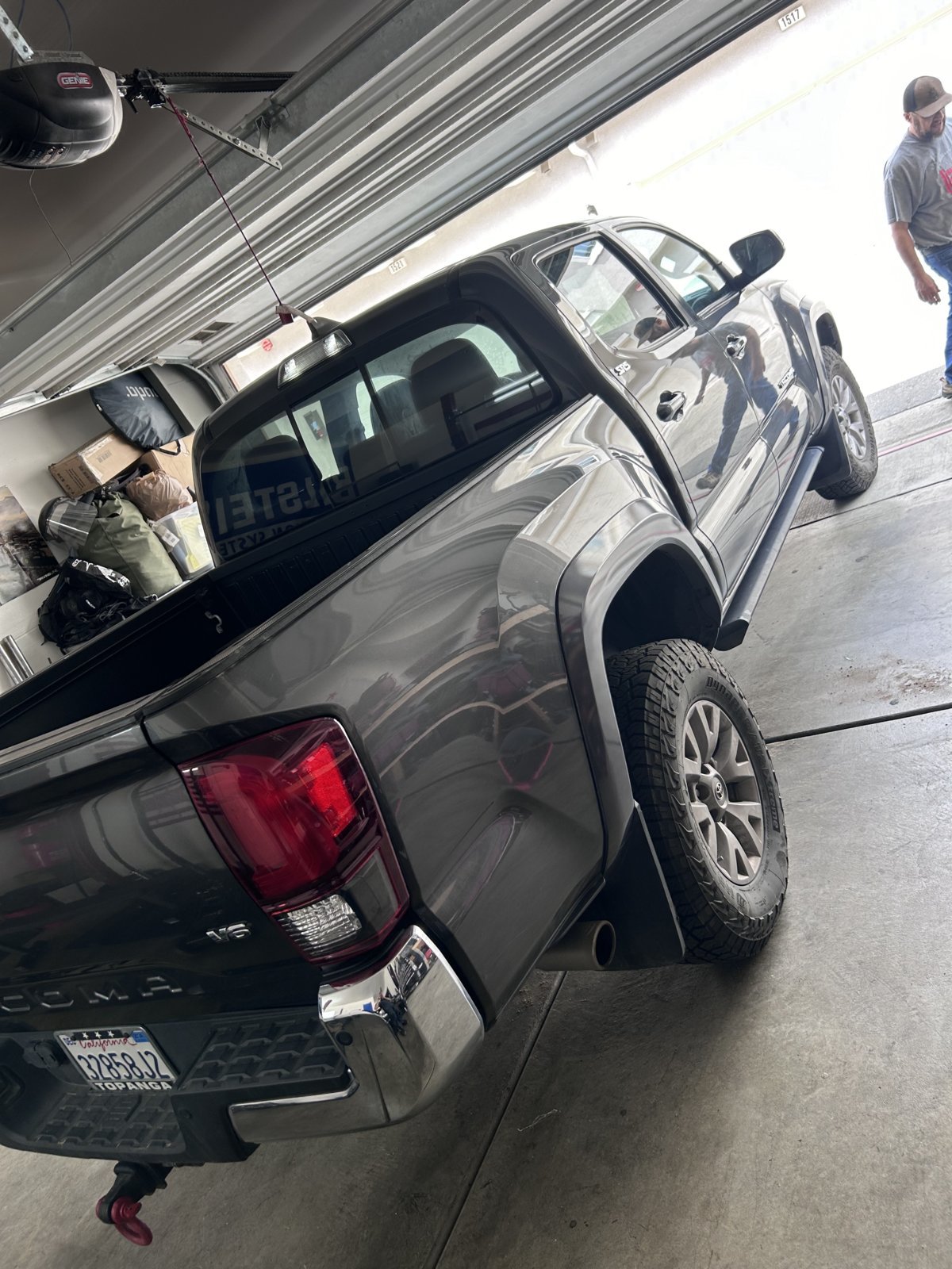

    Bossman @Topanga Taco stopped by to get his new OEM pack and RAS suspension set up squared away. Nice truck man, time for those skinny 33”s and sway bar delete kit :fistbump:
