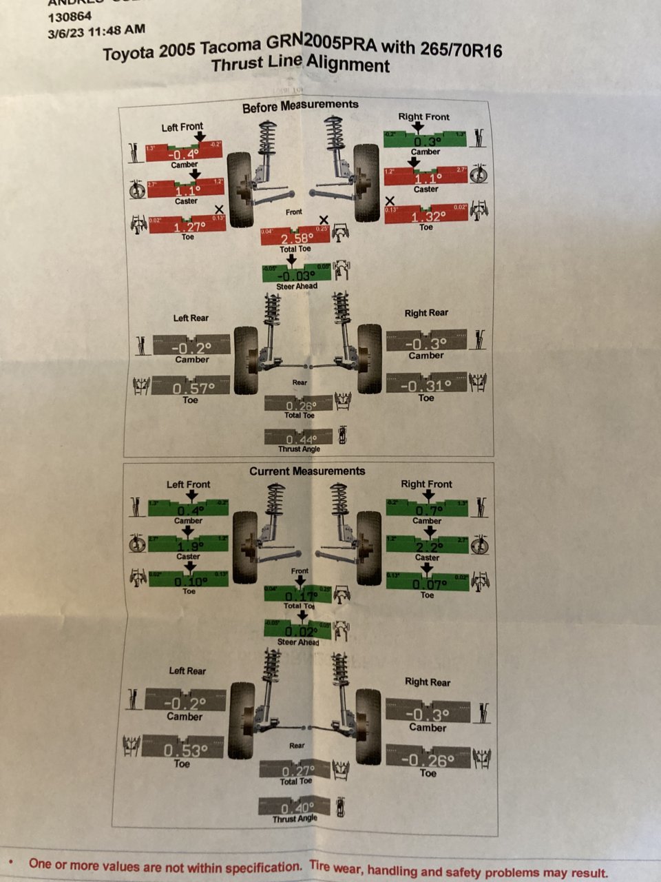

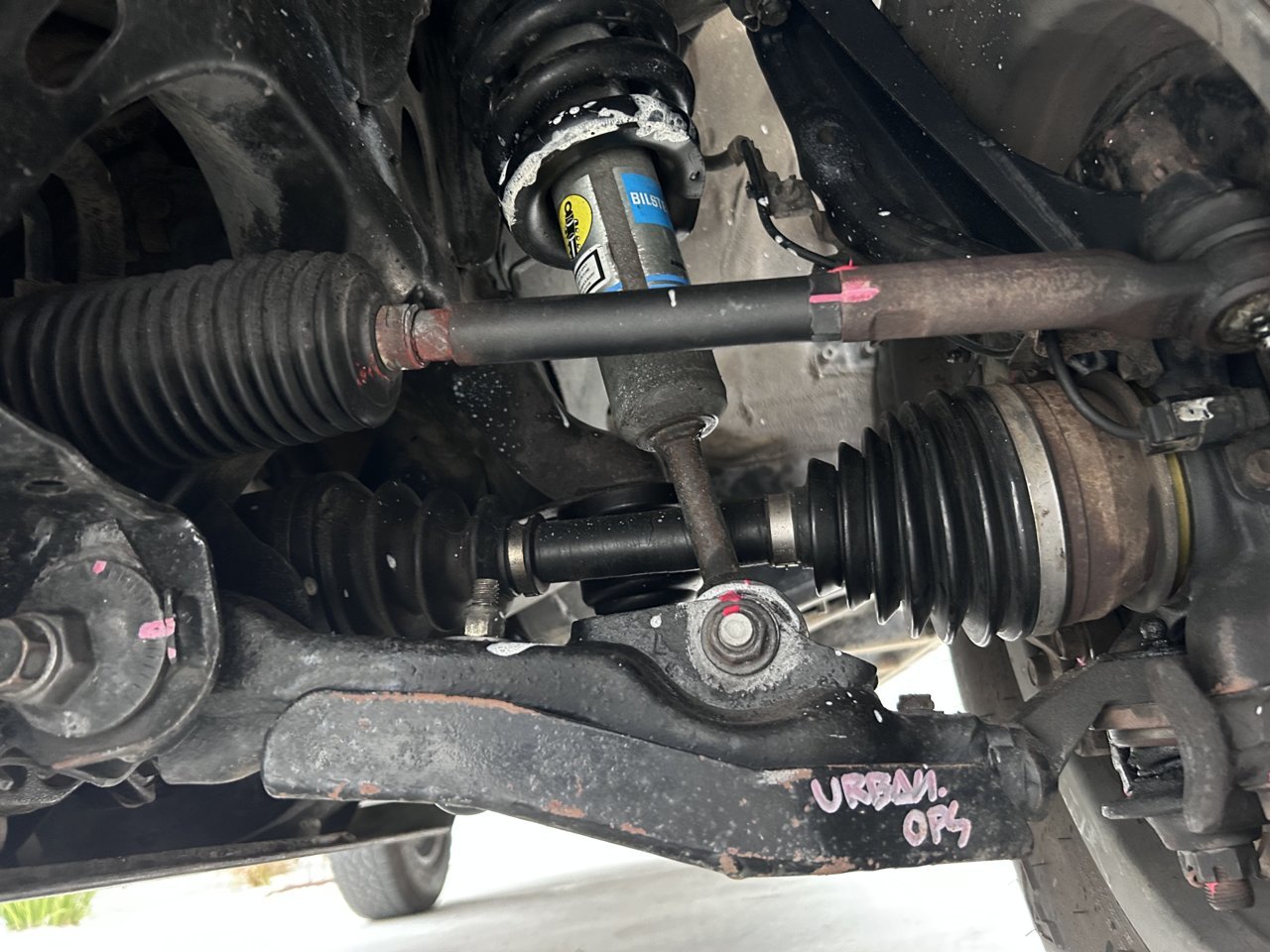

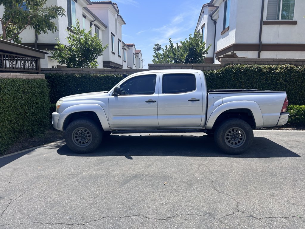

    Will be going off to alignment tomorrow.

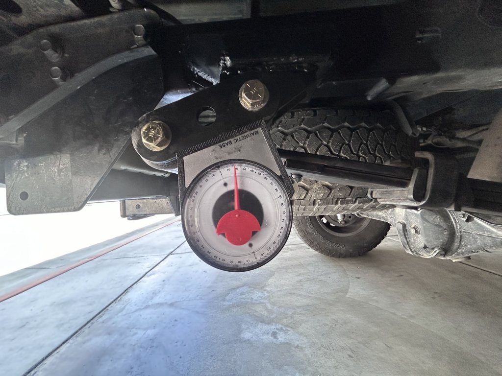

    All went smooth and truck drives tight with not a single complain, steering was a bit off to the right, he adjusted, tested and got it centered within 5 min. By the way, nothing rubs.
    UCA : stock
    LCA: stock with whiteline bushings and problem solver ball joint.
    Suspension: bilstein 5100 with OME 885X springs at bottom clip.
    Sway bar: LOL.

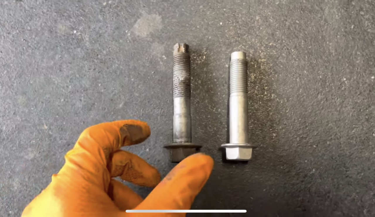

    Re torqued all front suspension hardware and replaced the lower shock bolts with the ones from the 4runner(5/6gen) perfect fitment, you can re use the washer and nut and provides a tapperless fitment. Seems to prevent bushing twist, which is a know source for those annoying cliks. Again, a video guide and explain action in español.

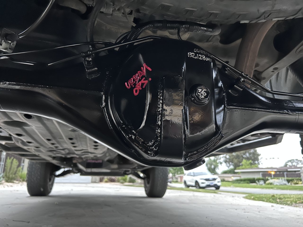

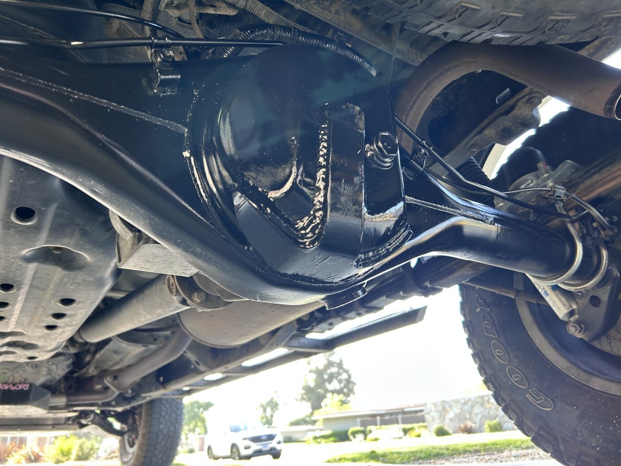

    Alright, just finish the installation of my rear diff armor. You know, the one that doesn’t steal a bunch of clearance and it’s affordable. Made by RuffStuff part R1772 aka the 3/8” bash plate.. It’s intended for the toyota solid axle pick ups. Shape doesn’t fully match so heat, and physical force is needed to get it to match your rear 8” cover.
    here’s the link to the product:https://www.ruffstuffspecialties.co...3etOCWaGbIJpbcO7txJ-tFncOYrbKxfBoCSbwQAvD_BwE
    here’s a picture:
    I’m editing the video in español as y’all already know.

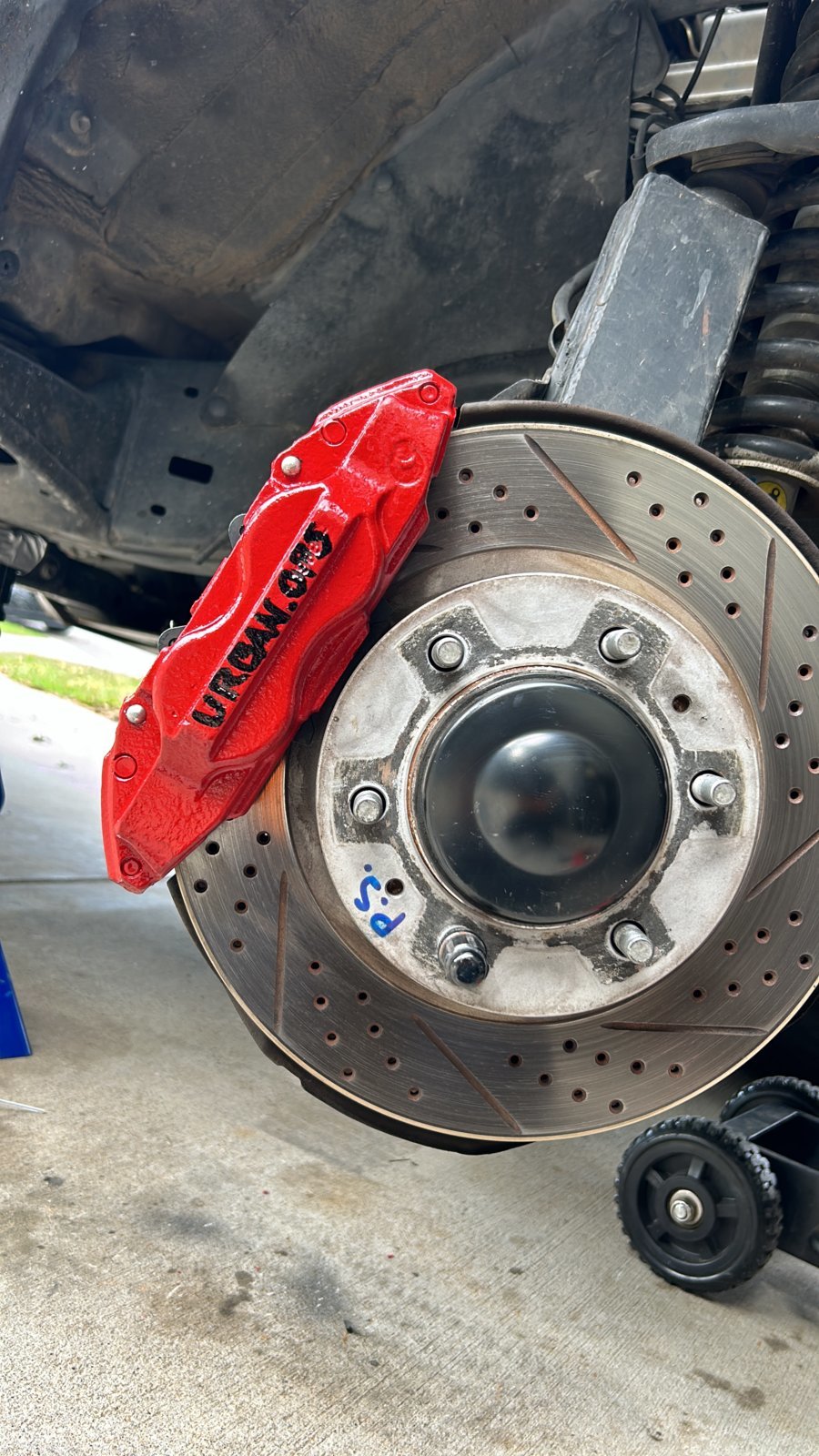

    Replaced the front brakes with some R1 concepts Super Heavy pads and resurfaced OEM discs. They are at 27.8mm

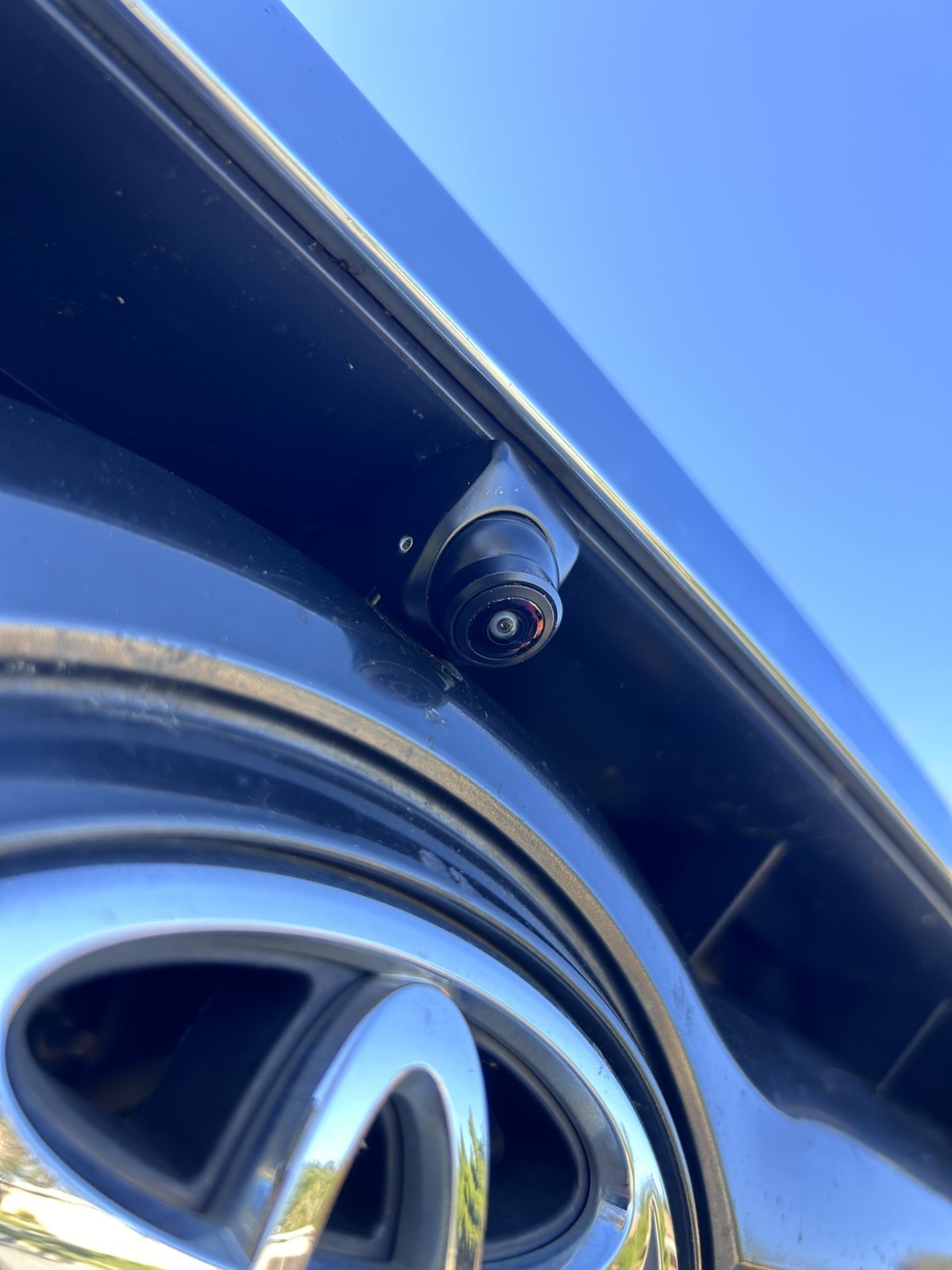

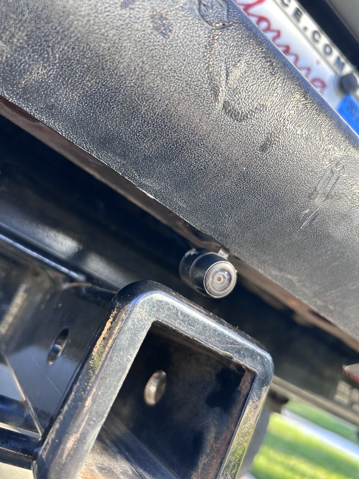

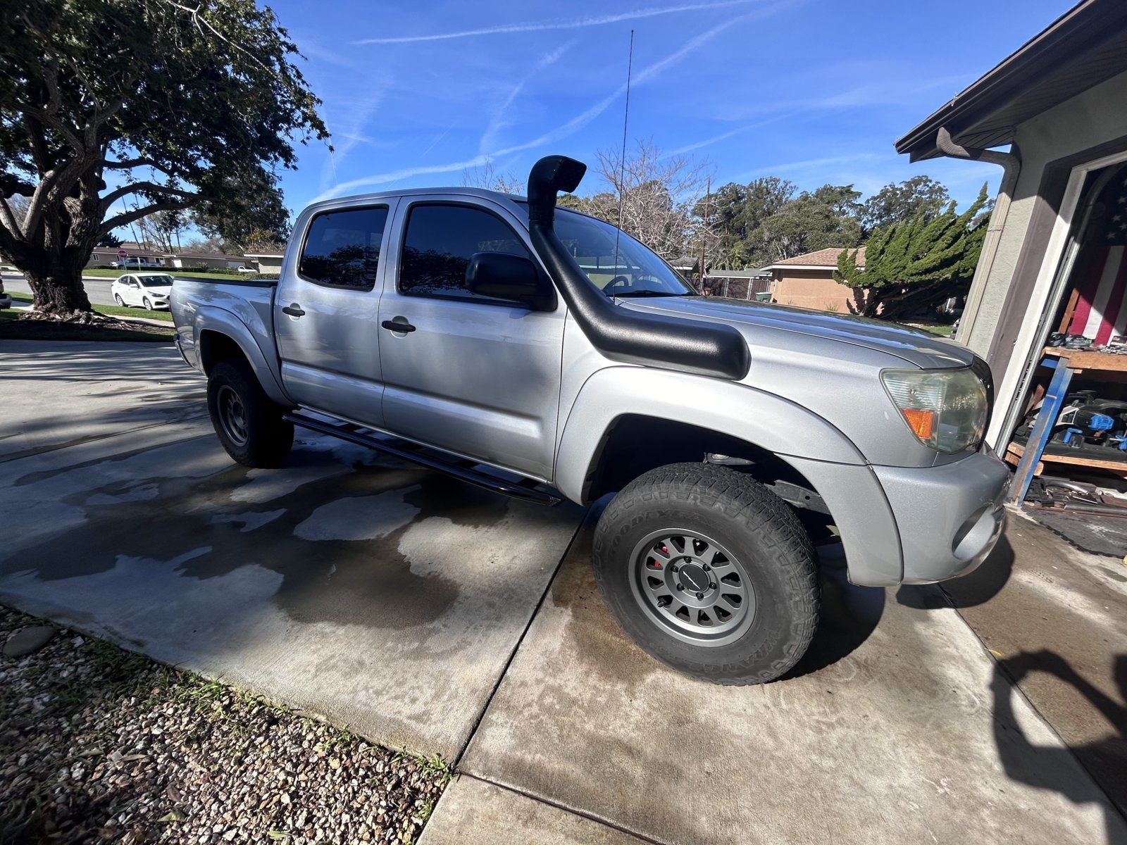

    Man, I haven’t update this thing in quite some time.

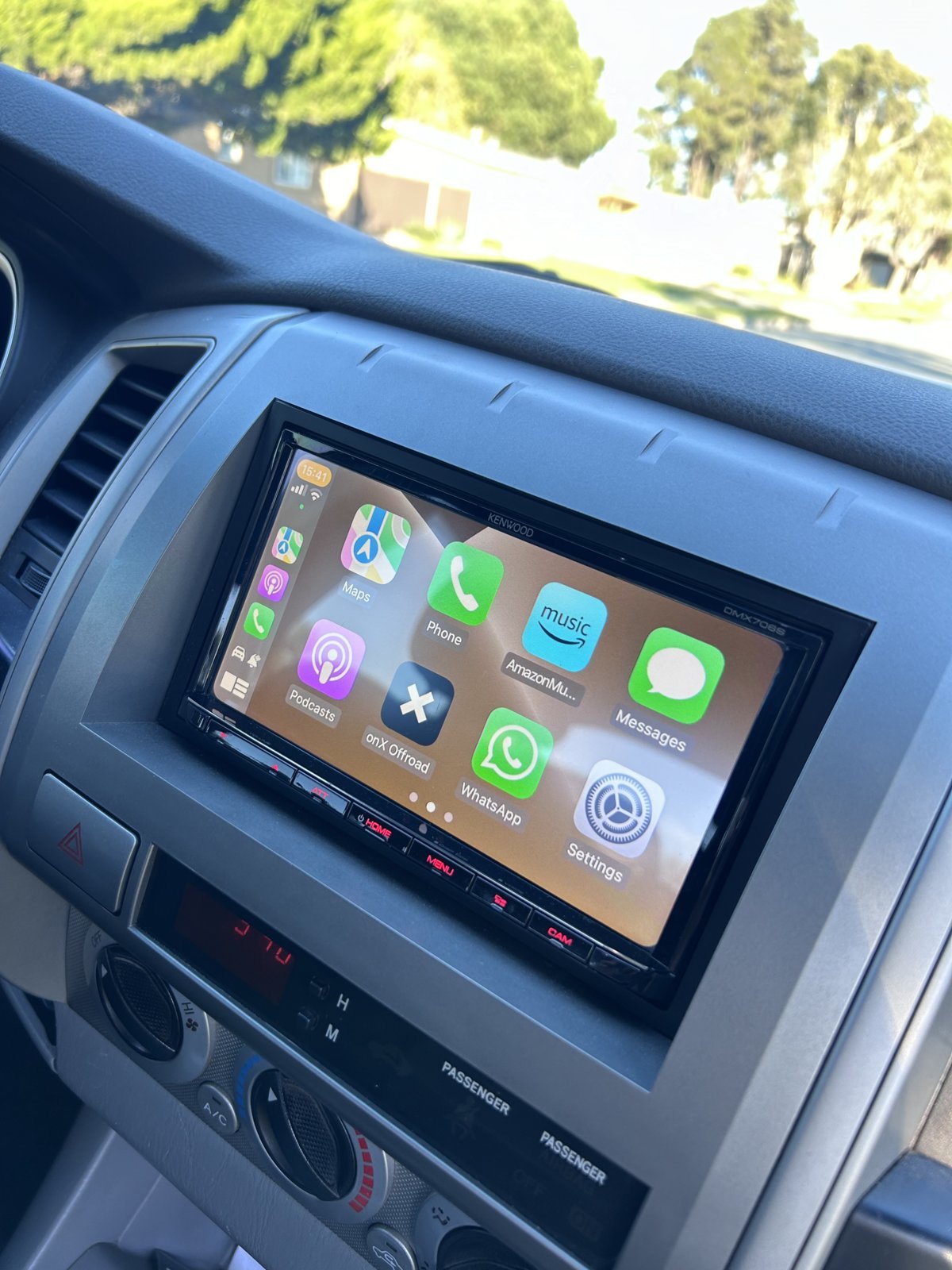

    added a hand down by @lit_taco4x4 Kenwood excelon 706ds and added the front and rear cameras.
    lit_taco4x4 likes this.

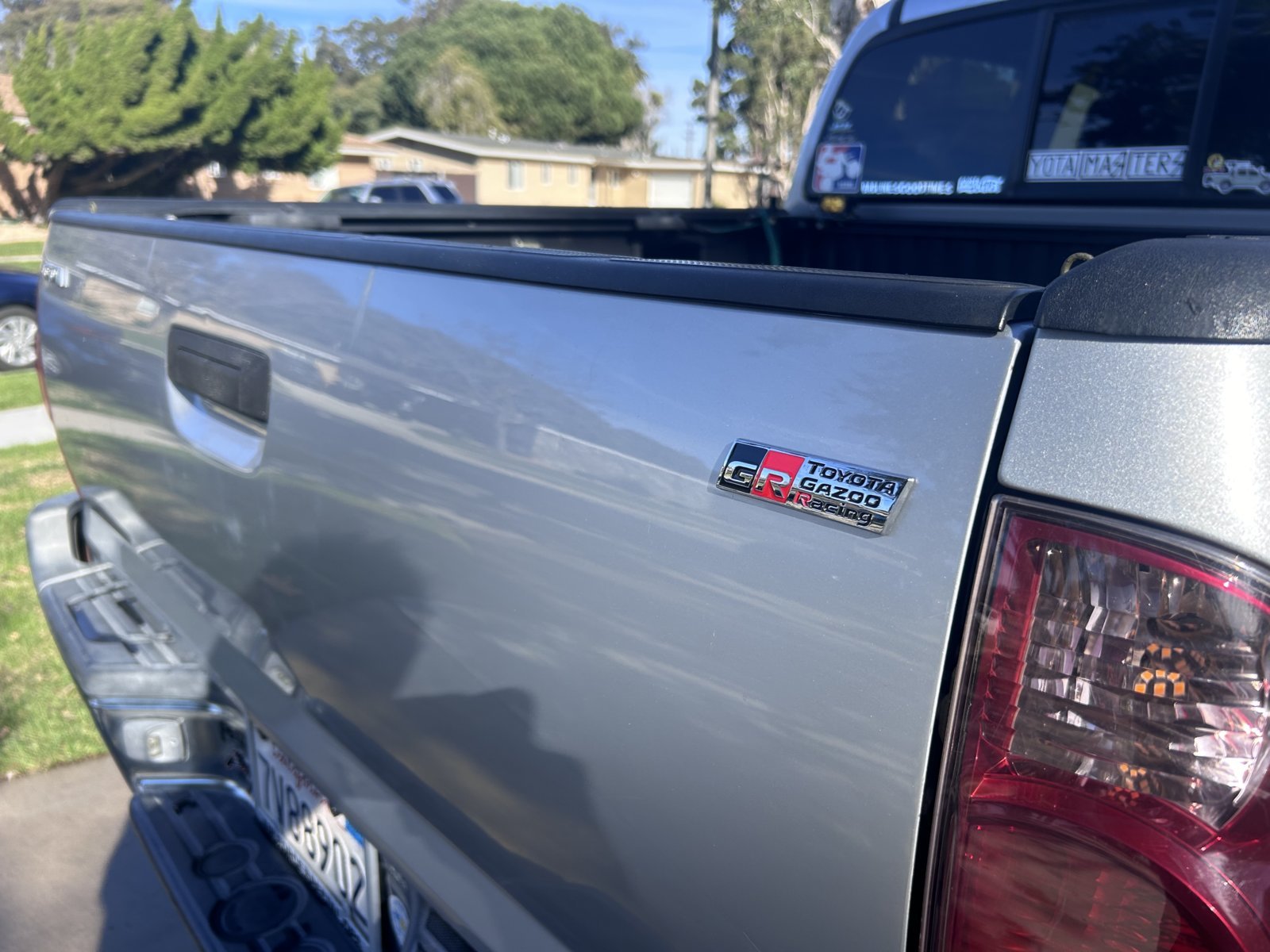

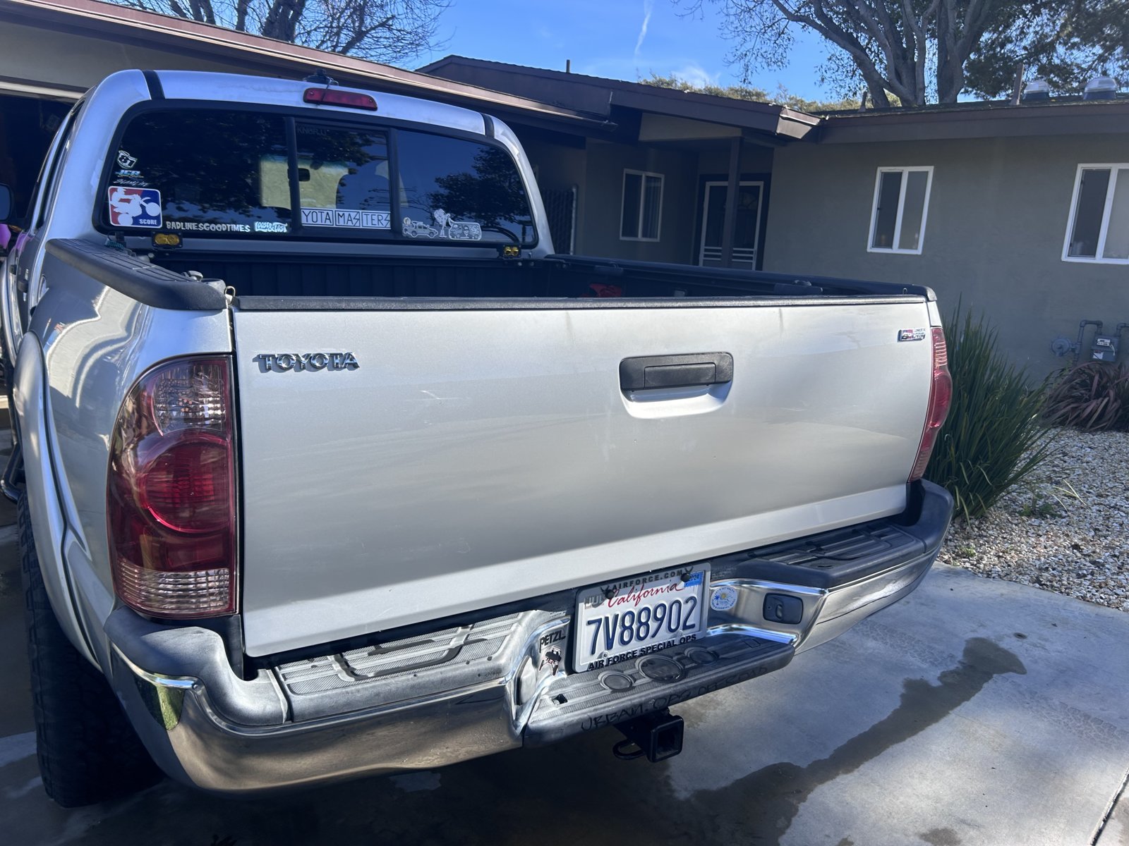

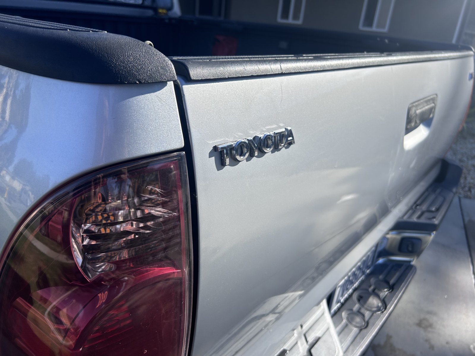

    Removed all badges and re arranged some stuff on the tailgate.

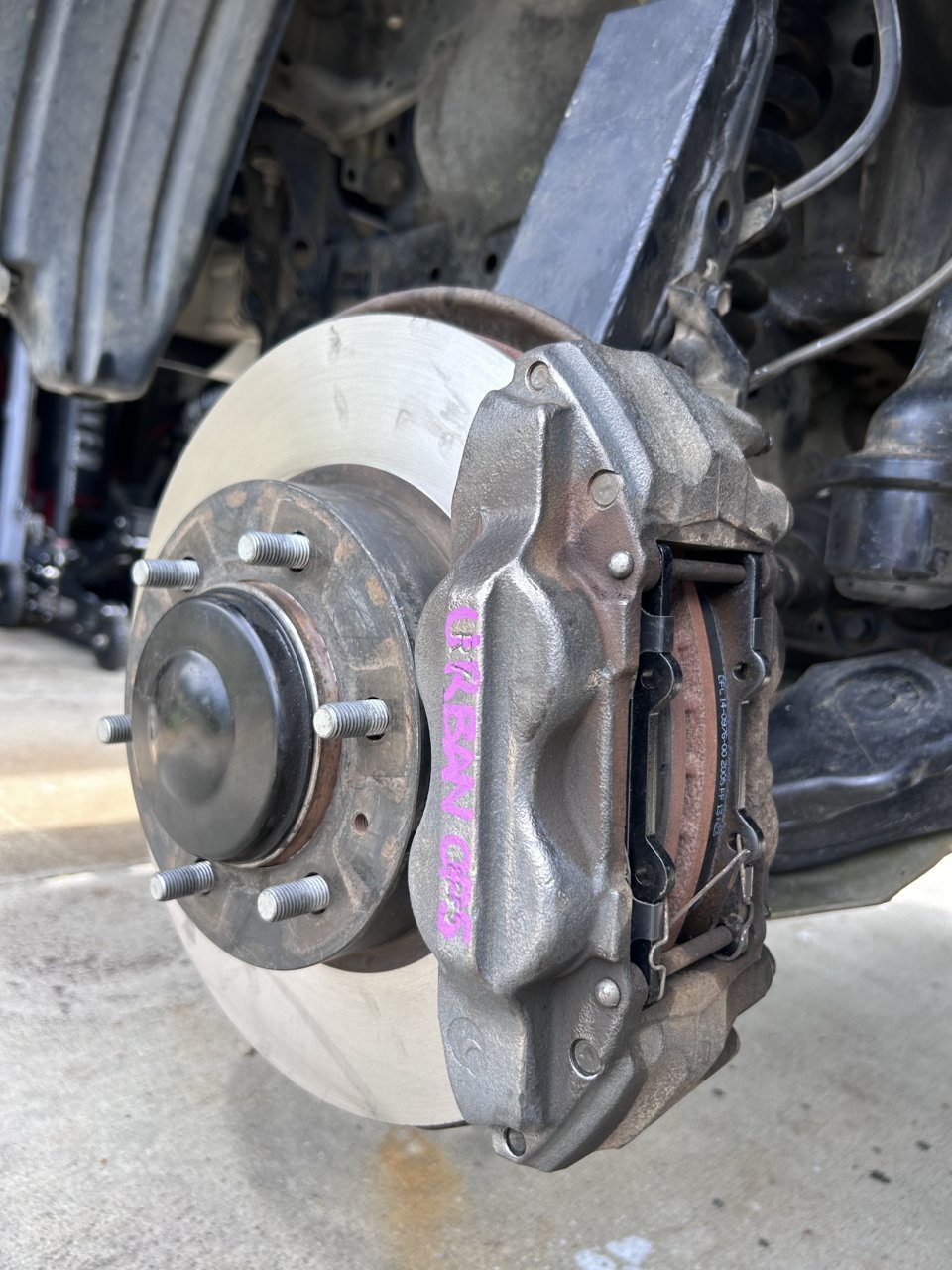

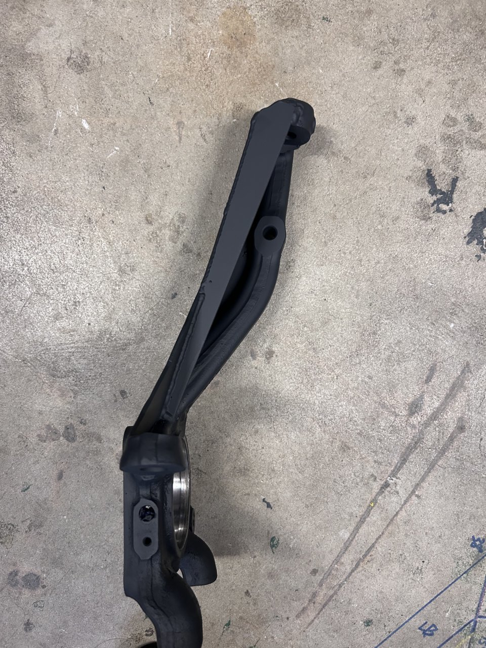

    Got some hand down test fitted discs from @lit_taco4x4 and calipers removed from his 3g and decided to service, paint and install on my yonke.

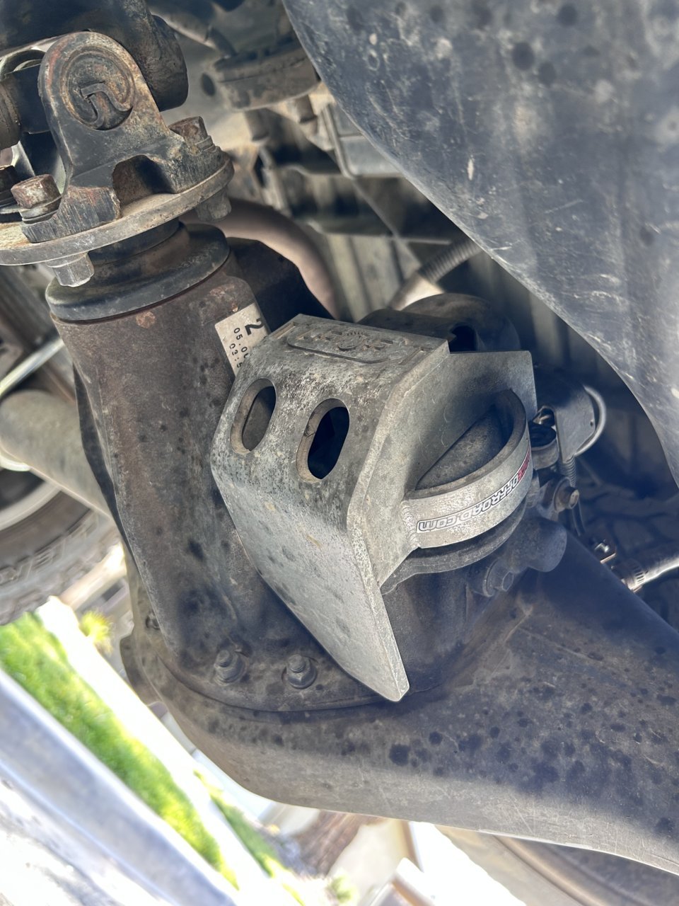

    Last thing I did to the truck when I was in Ventura was the BMR by Alpine designs.
    Kit is solid, hardware and bushings are up to specs a bunch of clearance.IMG_4614.jpg

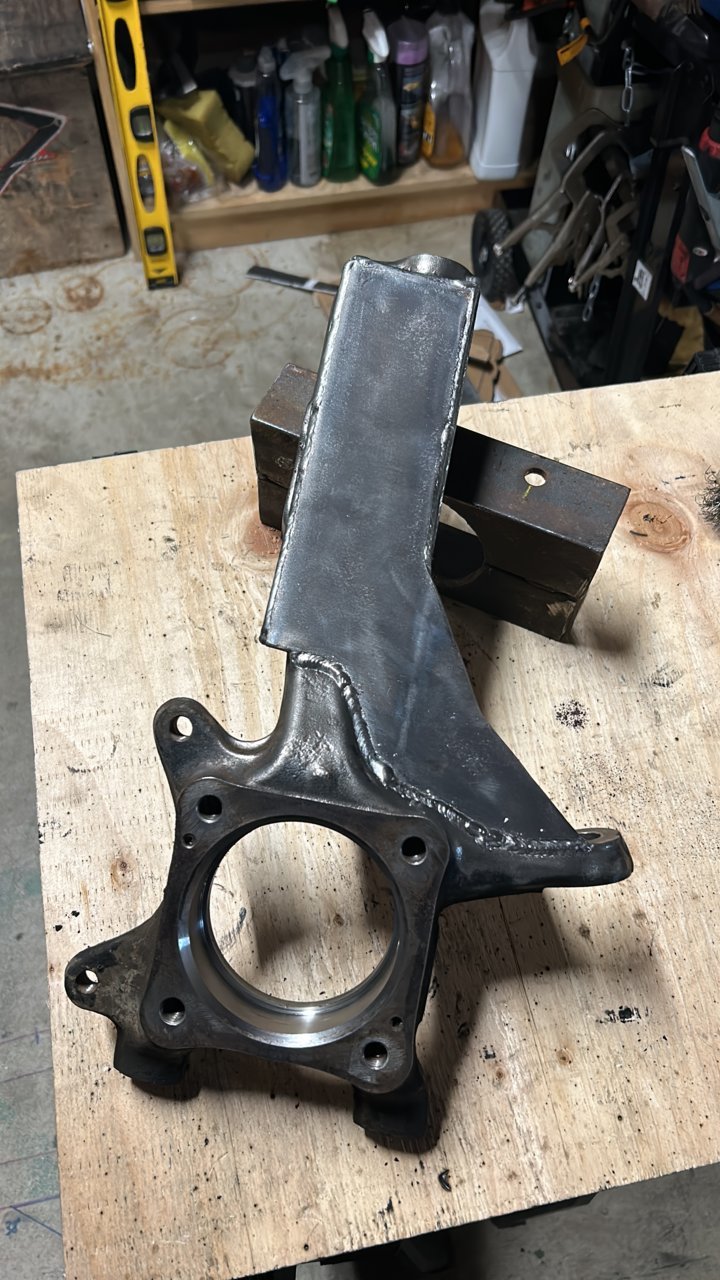

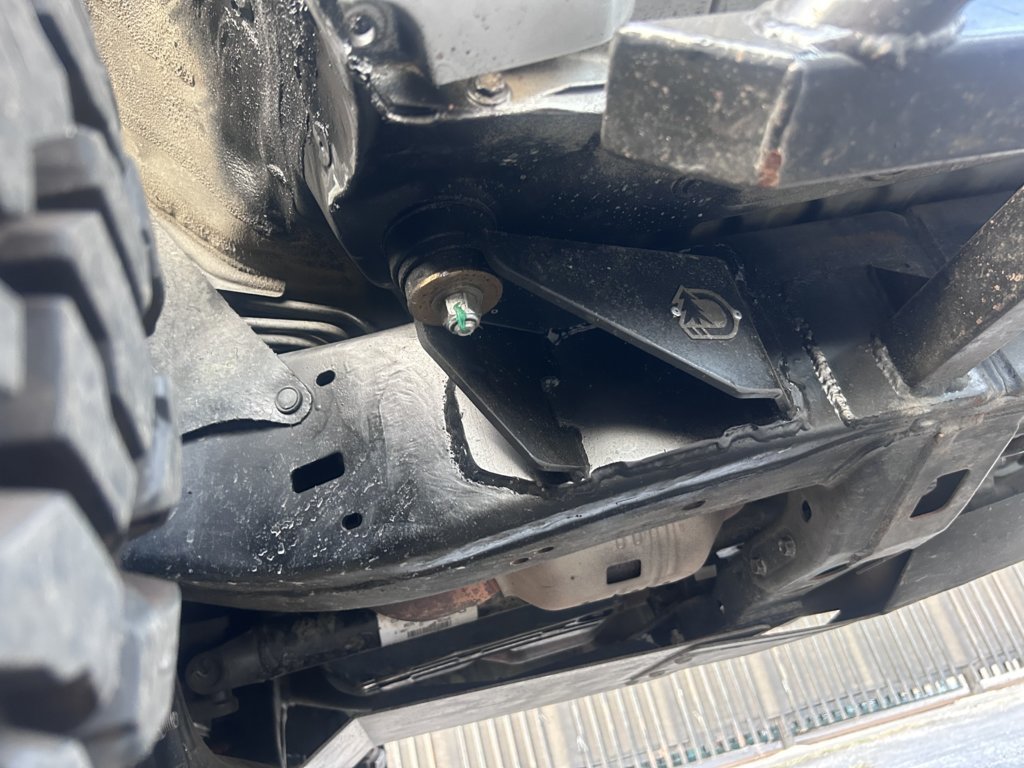

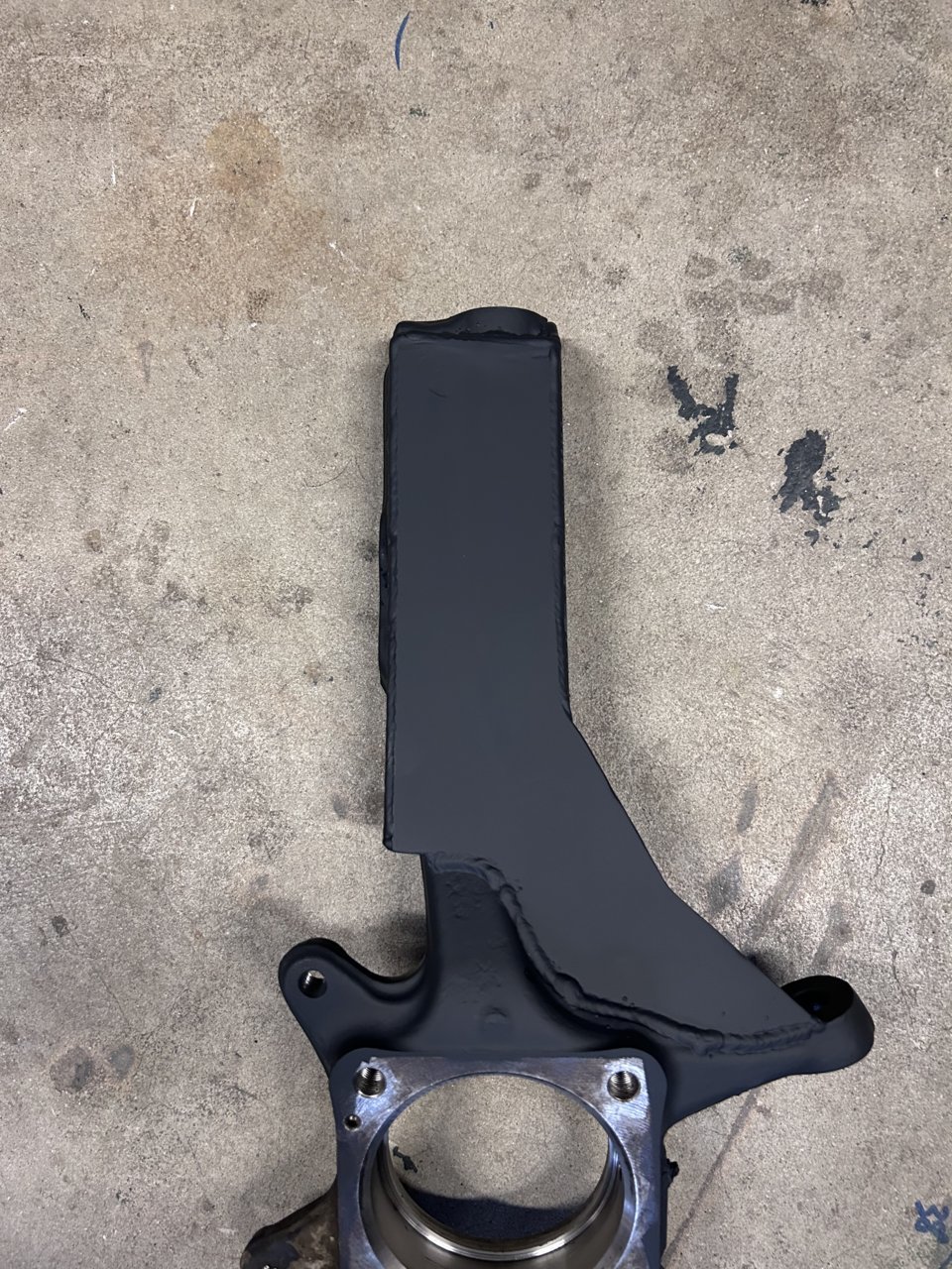

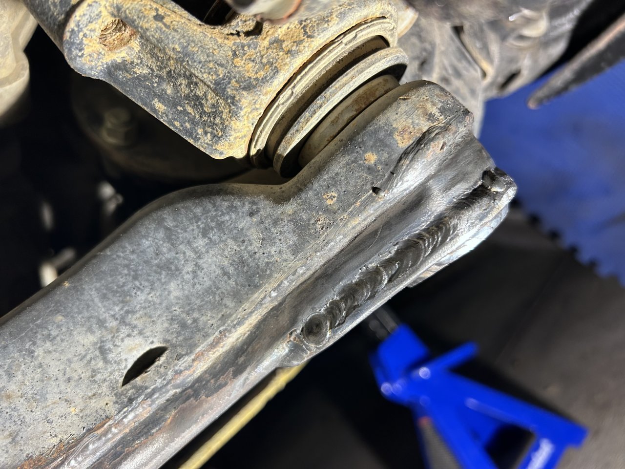

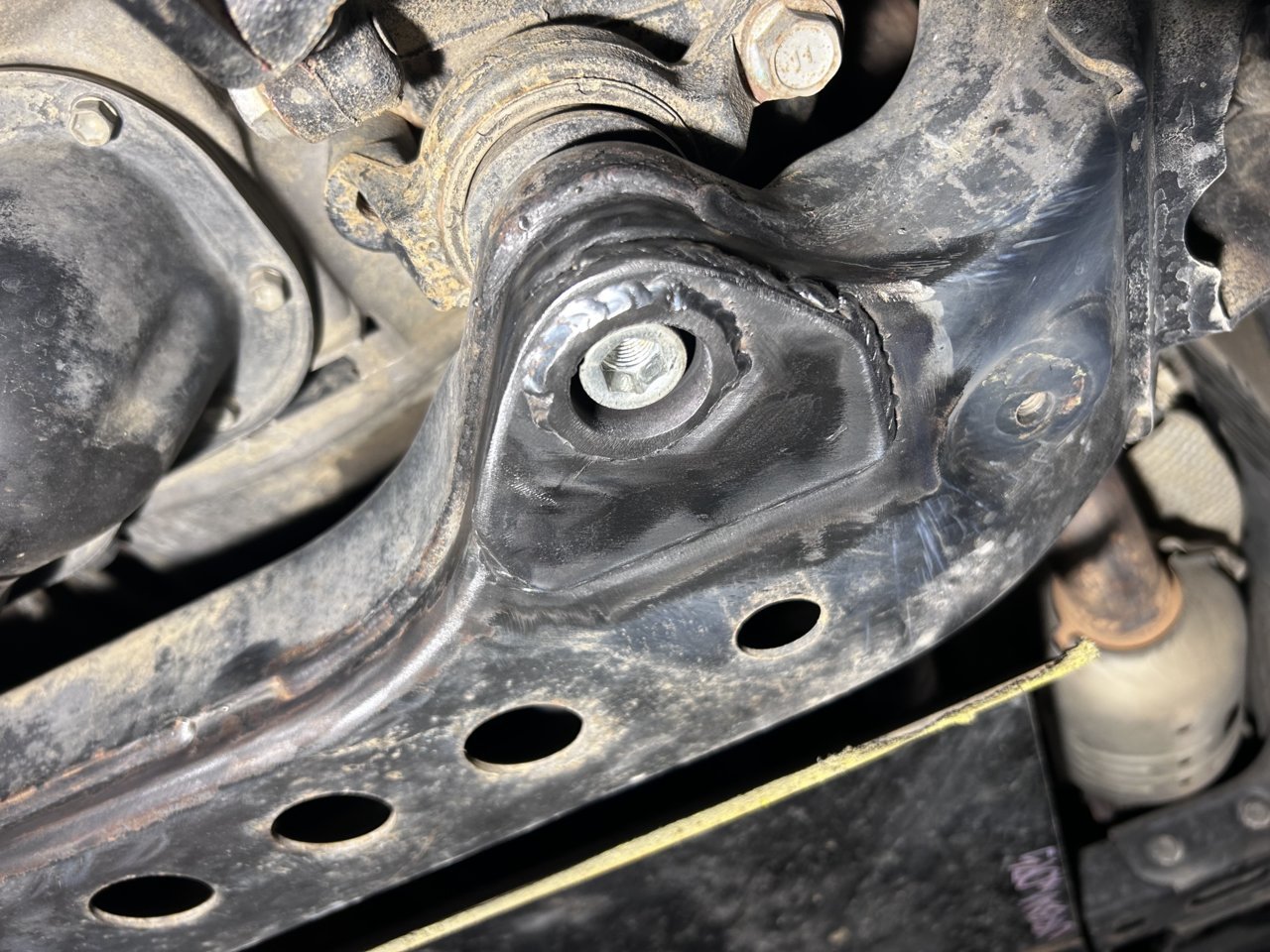

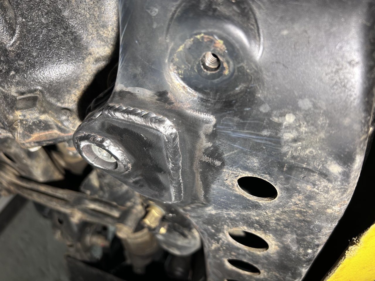

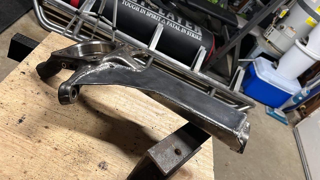

    Once I got to Upland I was busy with a bunch of BMC’s, CMR’s, spindle gussets, suspension installs, etc.
    once I had a weekend off I tackled the Chevy 63” conversions. Used the kit from ruffstuff and their outriggers. Kit is solid. At the beginning I went with 4” shackles and ended up ordering the 5”. Ill probably will modify for a 4.5” we’ll see.

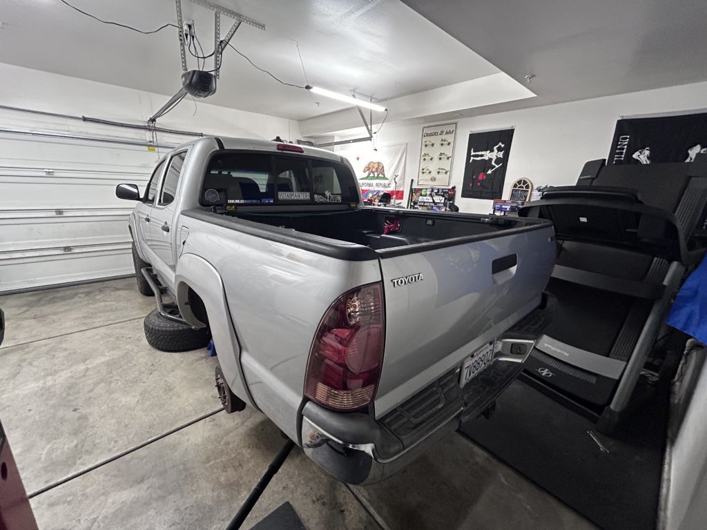

    Some bling showed up. Guys at NWF contacted me to inform they’ll be sending a new pin since other customers informed that it was coming undone under some crazy conditions. That’s what customer service it’s all about. New pin is received and just making some room to tackle the eco-crawler.
  20. Sep 19, 2024 at 9:29 PM
    #40
    Ricardo13x
    Ricardo13x [OP] YT: @UrbanOpsOffRoad IG: @urban.ops.offroad
    Feb 9, 2020
    #318785
    2,936
    Upland, CA.
    05 OR DCSB ProRunner(4x4 conv.), Chevy 63”s, NWF EcoCrawler, 35”s
    Random stuff. Oh! and converted to non ADD 4x4.

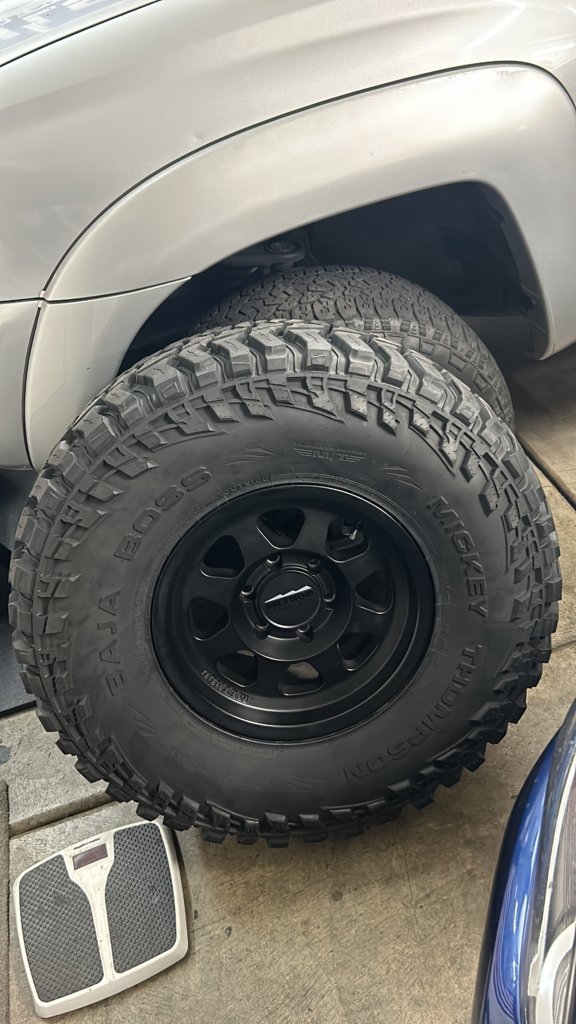

    Got my tires. Opted for Mickey Thompson Baja Boss M/T in 315/75R16. Solid, aggressive traction, proven under shit show conditions. Mounted one on my spare wheel(Method 701 16”) that I picked up for 120$ to figure out the amount I needed to remove from the fender and flares.IMG_9335.jpg 2572E6B4-B3F5-49E7-9136-954D90DE6AF1.jpg IMG_4290.jpg
