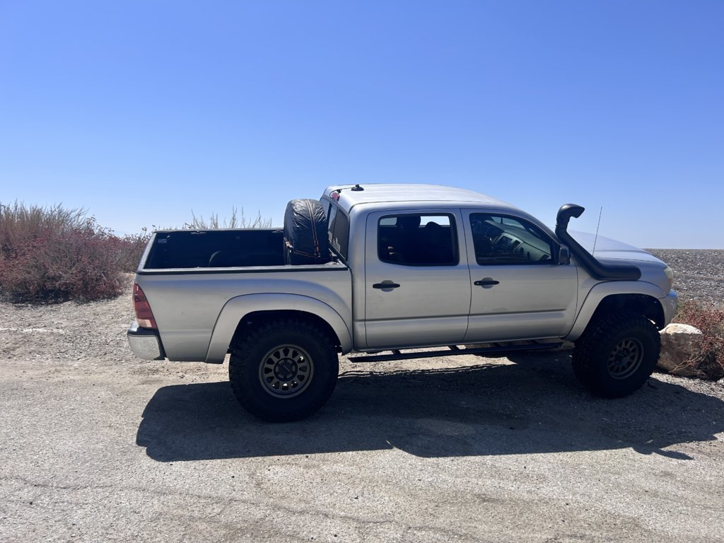

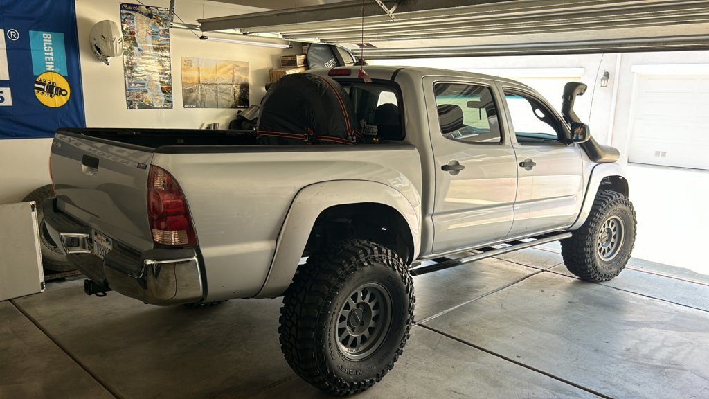

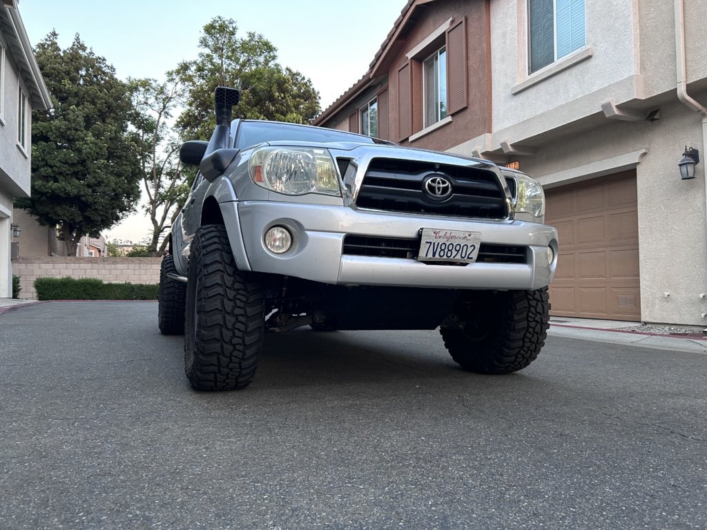

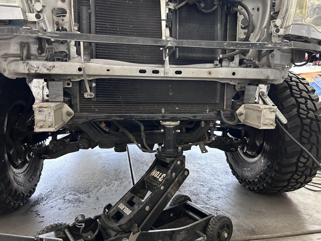

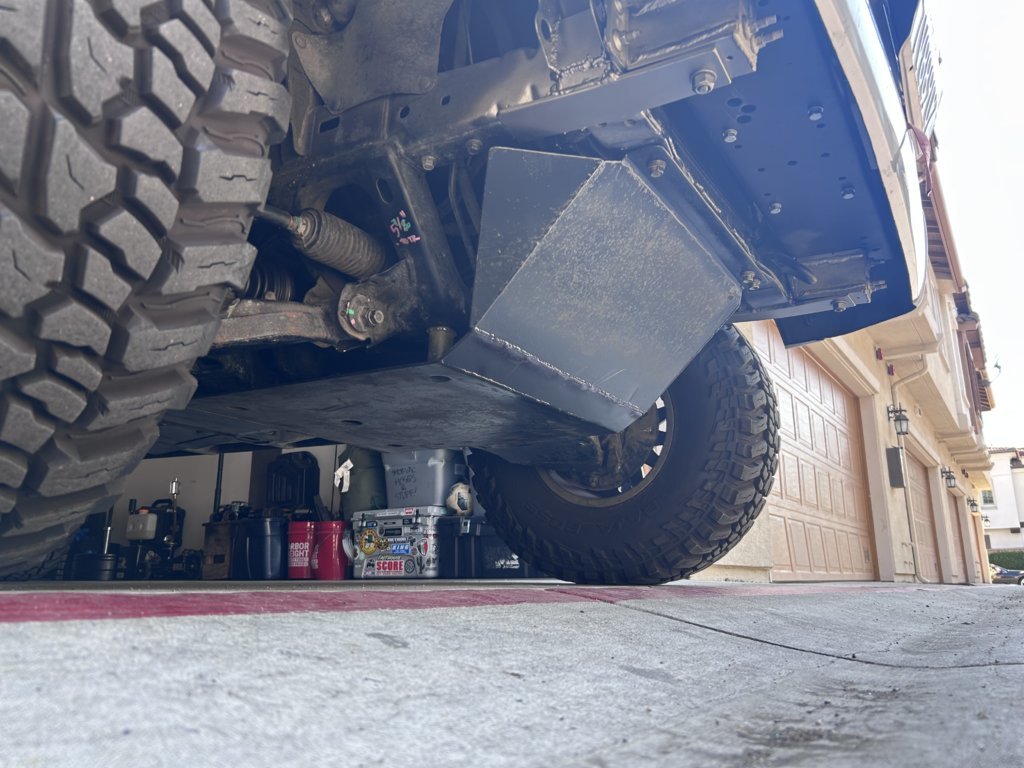

    Cycled front(removed the spring of the shock) and rear suspension(left main leaf only with spacer underneath) and ended up removing 1.75” from the fender and 1.5” from the flare.

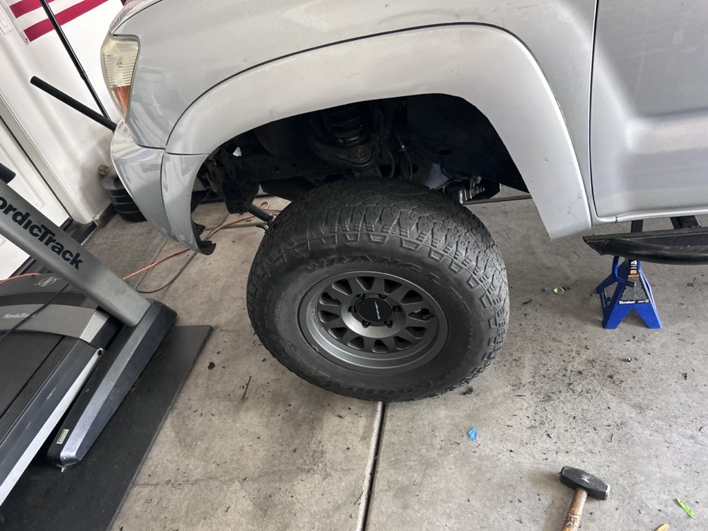

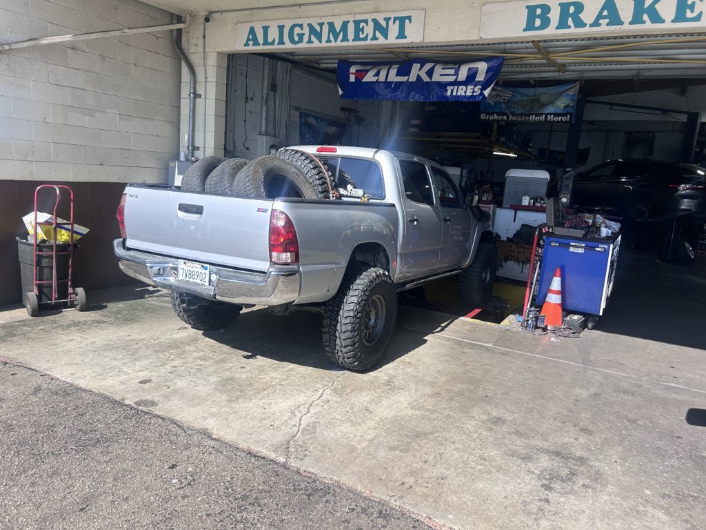

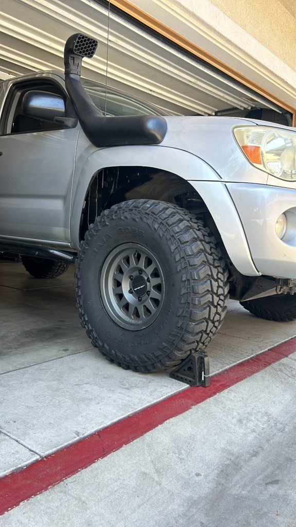

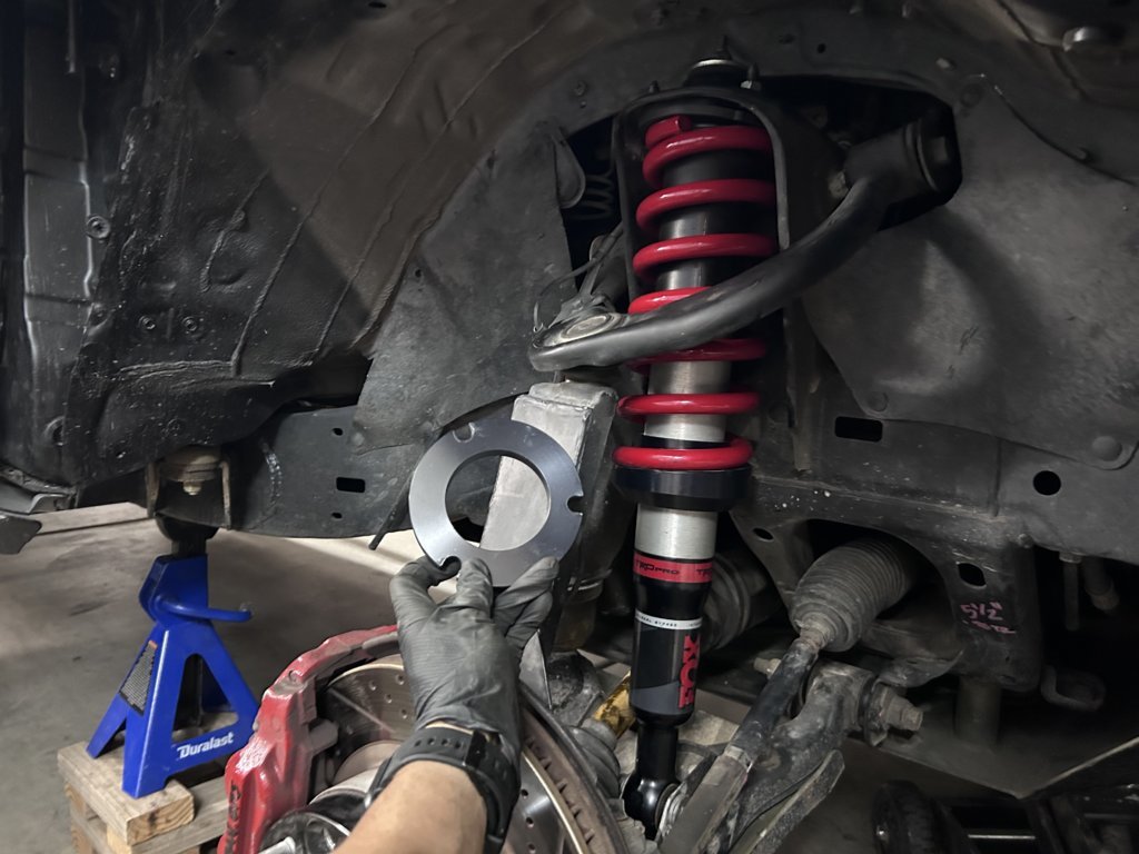

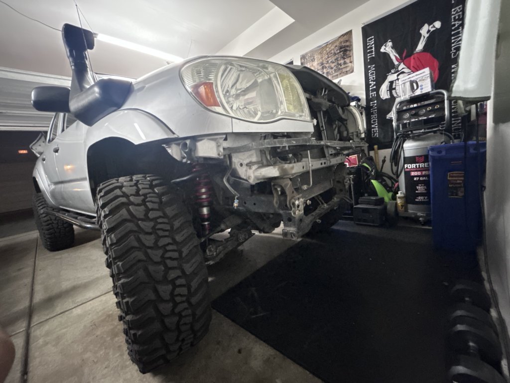

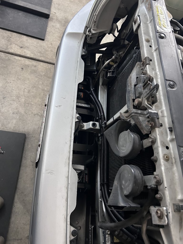

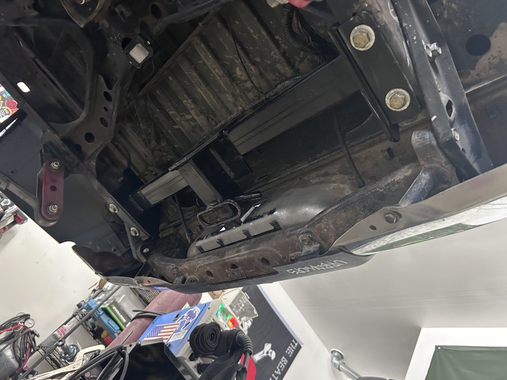

    Installed 1.25” spidertrax spacer since I’m running OEM uca on purpose and the tires rub on front portion of uca and slightly on the frame by the bumpstop area. After that I went to my Aligment spot for rest of the tires installation and Aligment. Old school dudes that have machine but obviously don’t use on modified suspension due to the machine wanting to run factory numbers and me having already a crazy set up in the rear. These MF’rs have my business for life. County brake and Aligment in Montclair ftw. They know their stuff.IMG_4395.jpg 2CDB4FF0-E661-4176-A055-783B023C80C1.jpg 35084D87-201C-4FB7-ACF8-B6586C4B2028.jpg

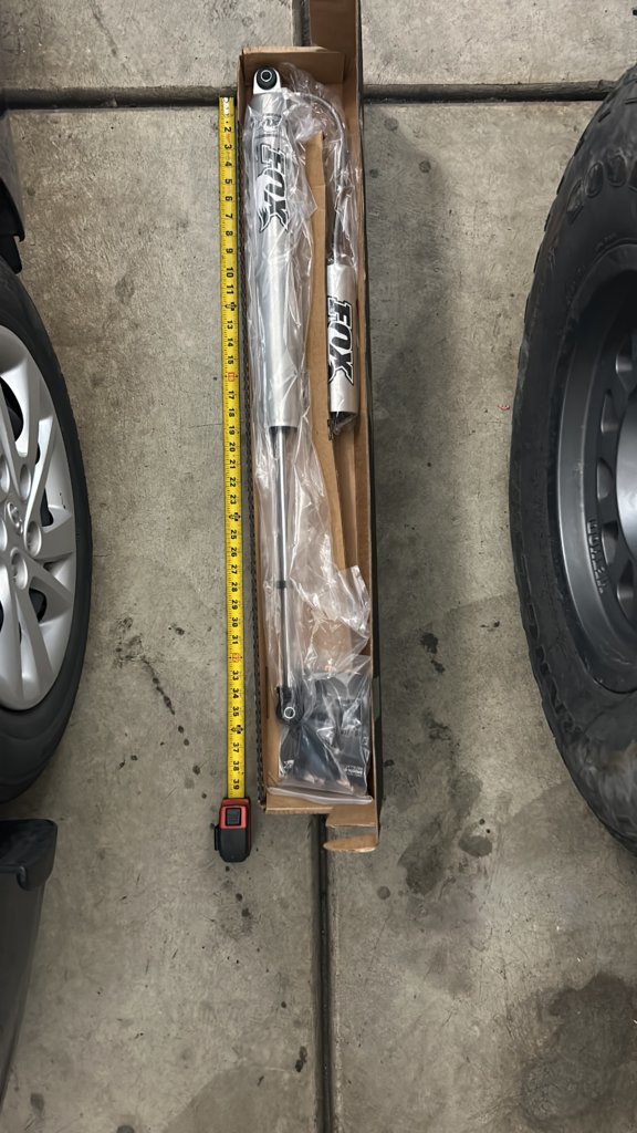

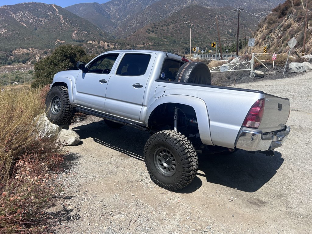

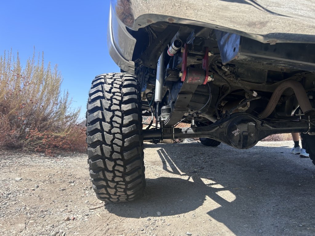

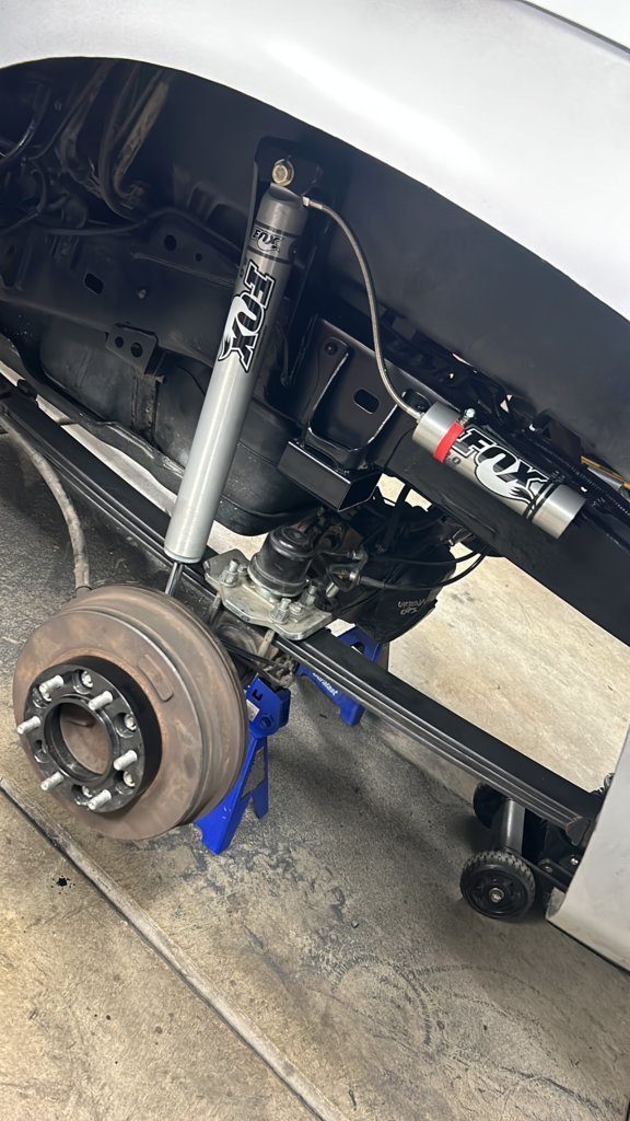

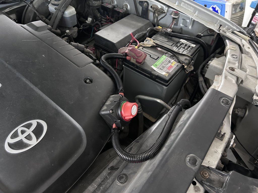

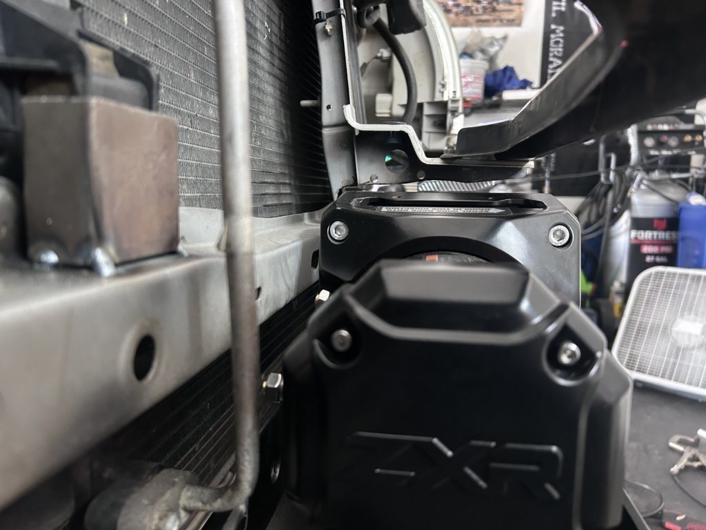

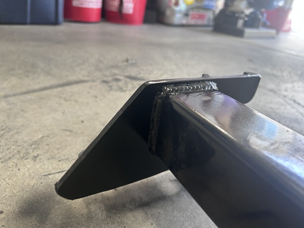

    I was waiting for the bilstein 7100 to restock with my provider and never did so I opted for Fox 14” paired with BAMF(@JLee ) shock towers to finish up my rear squishy combo. Bummed that there were no BAMF stickers in the package, Boooh!
    in those pictures I have about 2.75 inches of droop and about 2” of tuck. Nothing makes contact. Extended my bumpstop area about 1.8”E581CFC1-611B-4DE5-8B20-0C7A28F69A81.jpg FCFA5BCF-218E-43B2-BE4C-04C2FBEB83FA.jpg IMG_4549.jpg IMG_4550.jpg IMG_4552.jpg
