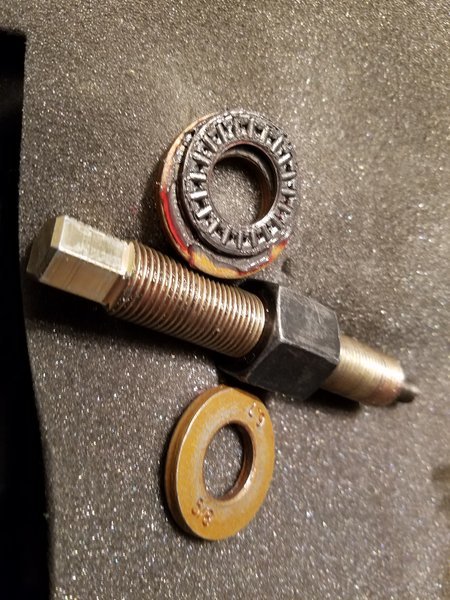

    crashnburn80
    crashnburn80 [OP] Vehicle Design Engineer
    Jun 6, 2015
    #156893
    14,771
    Kirkland, WA
    2003 DCSB TRD OR
    Left foot becomes so much more tempting after the pulley install it is difficult to draw an even comparison.
    For what it is worth, it gets the job done sufficiently at a reasonable cost. I would use it again. Just be sure the threads are threaded evenly into both the supercharger and tool on the install so you avoid the disaster that I had.

    crashnburn80
    Jun 6, 2015
    #156893
    14,771
    Kirkland, WA
    2003 DCSB TRD OR
    I like to make things extra challenging for myself. I figured the install was too easy, that is why I grenaded my install tool into the engine bay mid install, just to make it more challenging.
