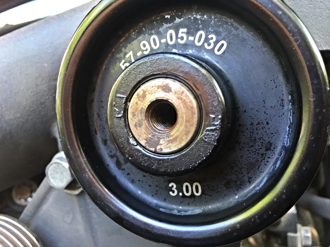

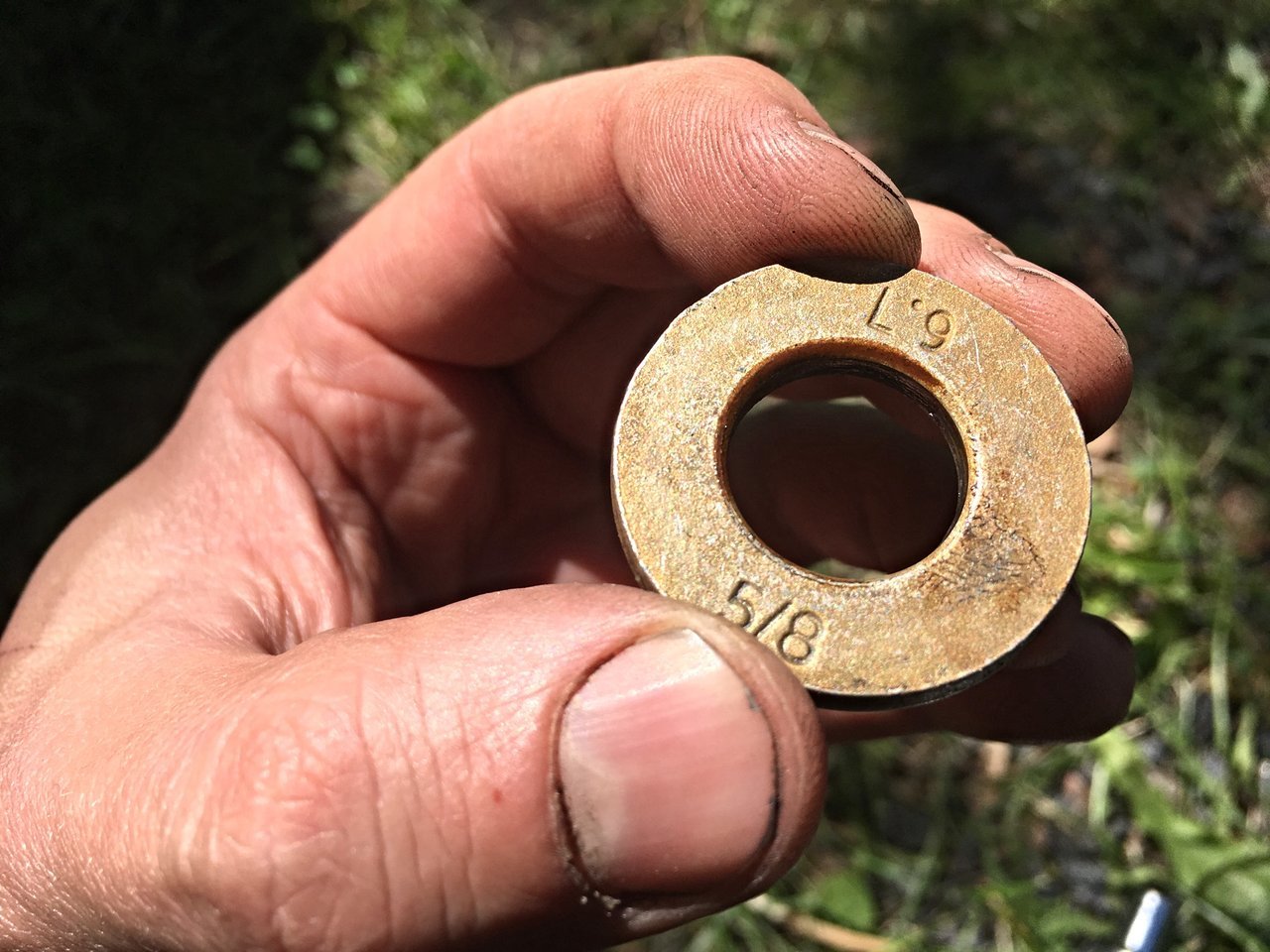

    Tried and managed to install it. I boiled the pulley first and freezed the shaft. Went easily first 2/3, until stopped completely like it's all there. Started to remove the tool, but noticed it wasn't! Hurry to turn it more, luckily it went quite easily, just needed more torque.
    The paint of the pulley is very soft after boiling, there is now "stamp" of the washer and the original glossy paint is now something stealth too, looks old.o_OIMG_3070.jpg

    Encountered the same issue with the paint, while helping a friend install his pulley.
