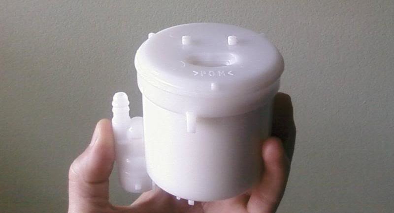

    No, it’s the main filter after the upgrading. The OEM pump includes two filter too.

    Am I missing something? I haven’t completed the upgraded pump install yet, but it appears no OEM filters are removed and this one is added. @12TRDTacoma

    The pump is housed inside the filter:
    Pump suck up through the strainer/filter and pumps fuel through this = the filter media.
    This part is not there after the upgrade, the external aftermarket filter replaces this filter.

    What's the problem? There is one filter installed in place after installing an aftermarket pump. Whether or not you want to add an external secondary filter after the pump is purely up to you, but on mine I just used a strainer made by Bosch. No external filter.

    I missed that reading over the instructions I guess, it was a while ago. I’ll have to revisit them. Thanks for the clarification.
