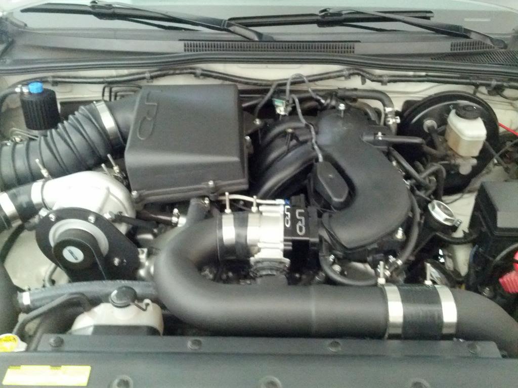

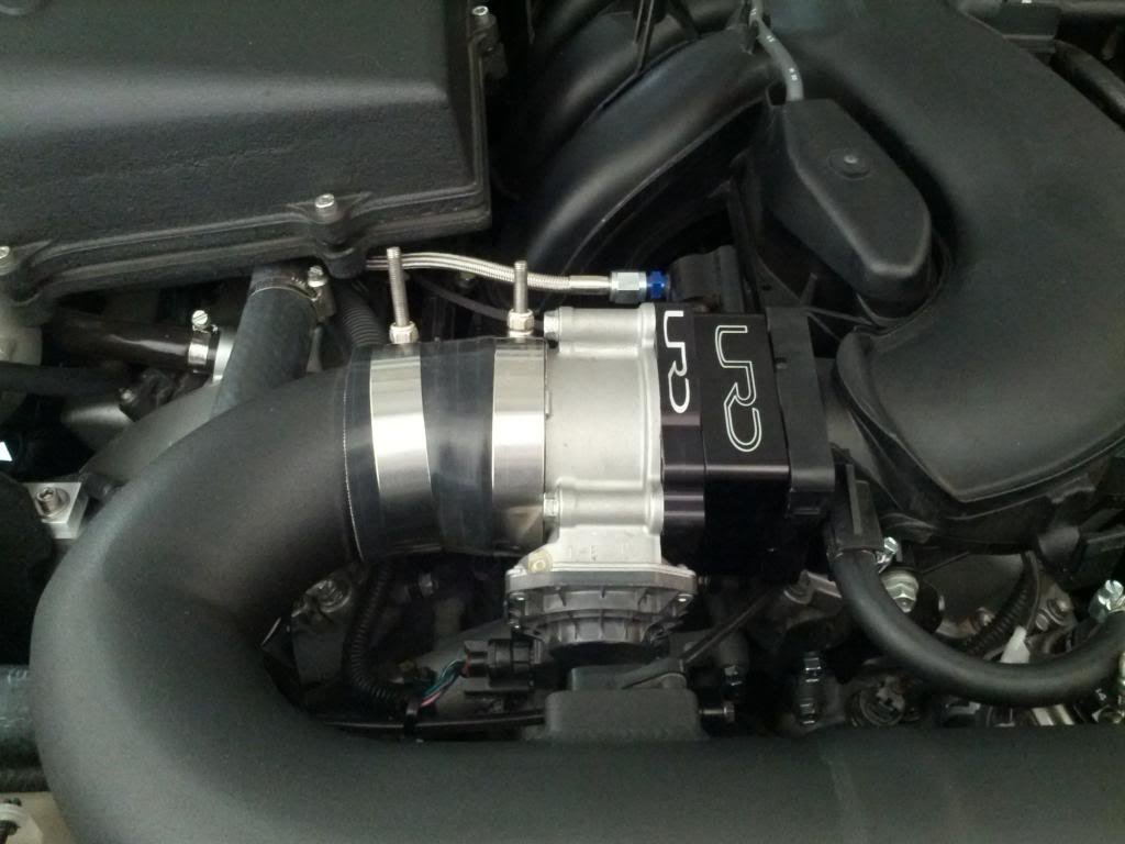

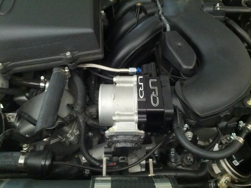

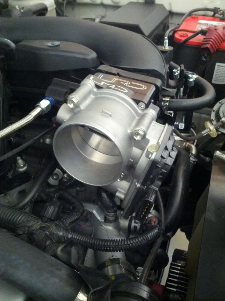

    Well here it is! Like it so far but hard to say if any gains, its 100* outside and im still not really used to the URD blowers power yet.:laugh:
    Feels strong though!

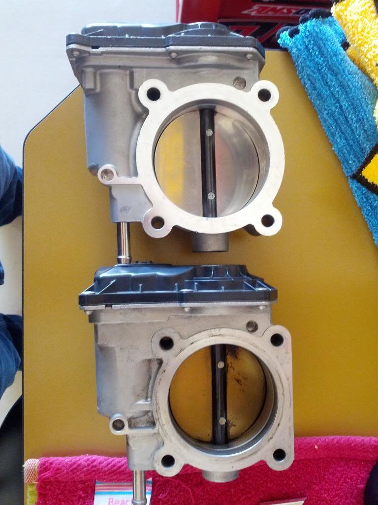

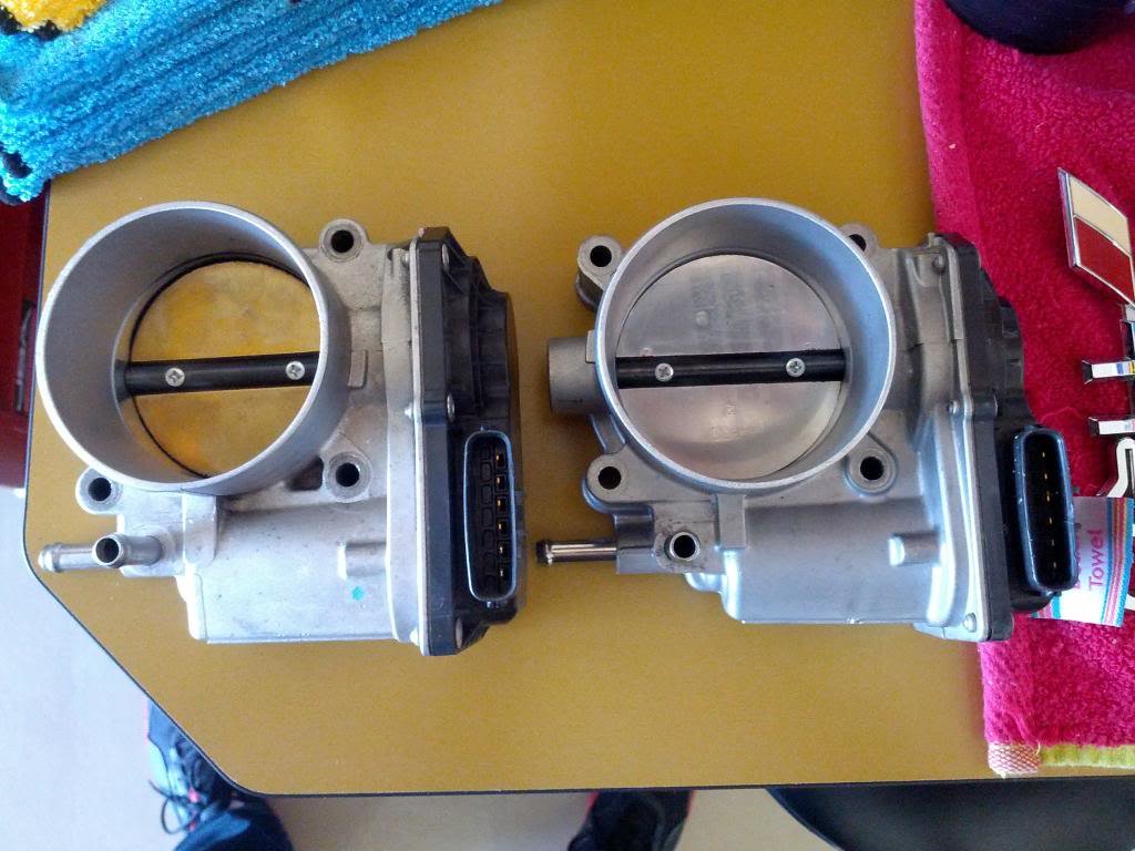

    And if anyone is wondering the URD 7th injector is not 70mm. It's like 69 or maybe 68 mm. So now that is a very slight bottle neck in my set up. I may take the 7th off, as it isnt being turned on yet. Those 800cc primaries are giving it plenty of fuel.:top: And the stock plenum is indeed 70mm ID.
    http://urdusa.com/p1260519161/URD-7....html?osCsid=4a15ea3226821ef9a9dbcc3651e60c96
    Anyways on to the pics!
    The one with the goldish blade is the stock 65mm TB.
    BudFriendguy and steveh_2007 like this.

    and to clarify in case someone asks
    this is an adapter plate made by URD. You need to get a 2010+ FJ or 4runner Throttle body.
