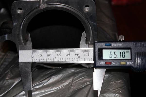

    It has been confirmed thanks to hottacoX on XRU that the TRD S/C inlet is in fact ONLY 65MM. But it does appear to be enough material there to open it up to 70MM. Now only to decide on whether or not to attempt to do this.

    I do need a new base line because I just installed a 2.85. I'm tempted to do this not sure best way to go about it. I was looking at port and polish kits in summit. They are a little higher than I expected. Also, what do you think about doing this with the blower still on the truck?

    definitely not worth it. Youre going to end up porting just the opening of the blower and it will shrink right back down at that first squeeze/bend
