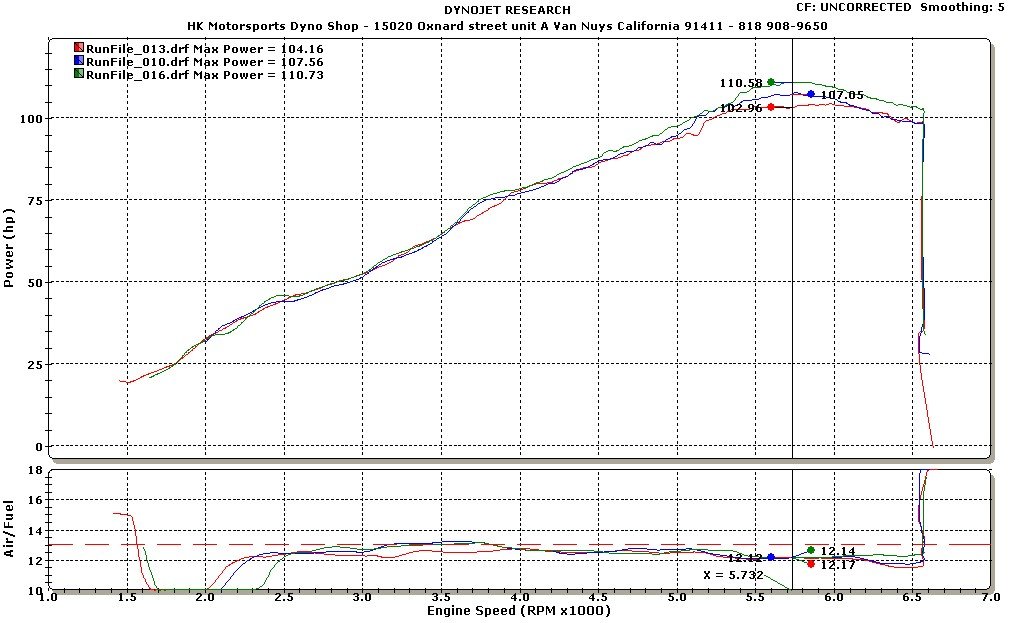

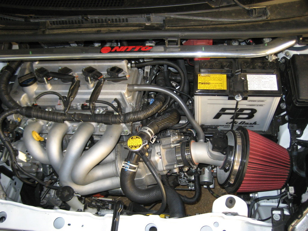

    I can confirm similar minimal normally aspirated gains, as I also did a plug and play larger throttle body swap from a 46mm stock 1NZ to a 55mm Corolla 1ZZ on my Toyota Yaris, and dyno tested before (blue) and after (green).
    In driving, what you do feel is a quicker more responsive throttle as the same incremental movement of the gas pedal is opening a larger butterfly. But it's a deceptive feeling as the actual hp gain is insignificant.
