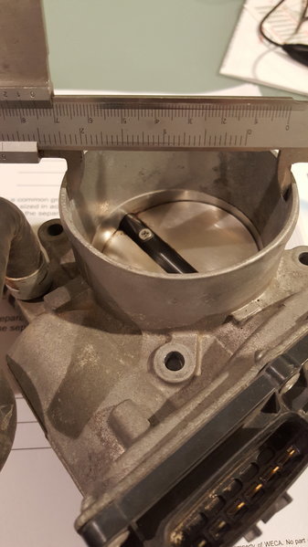

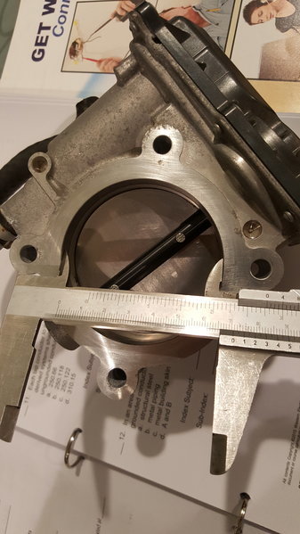

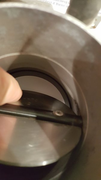

    Hey guys, I need your help since you guys have been working on 70 mm throttle body with urd adapter. I measured the throttle body and it not 70mm! It's 75.5 at the opening and tapered toward the butterfly and almost 71 mm on the backside of the butterfly. The URD adapter is 68.5 mm and is not tapered which seems like a bad design! Any input? Have you guys measured your URD adapter?1460606706470-613854479.jpg 1460606764662-86649927.jpg 1460606887387-362899521.jpg

    Wich TB do you have?
    From the FJ cruiser or the tundra?
    Cause there is 2 adapter, 70mm and 76 mm

    I have the 70mm FJ, the 70 mm must be at the butterfly I'm thinking because it's almost 71 on the backside of the butterfly

    Mine is the 22030-31060

    I found out the adapter from URD is only 68.5mm not 70mm like the throttlebody. Pretty disappointing to see that when there is no disclaimer on the website
    - If you buy one you better every prepared for some port work or pay someone to do it... seems like their customer service is poor
