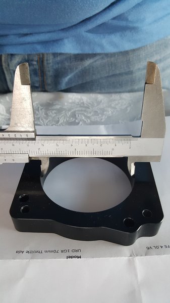

    Yeah and that seems not well made to not be 70mm opening. I don't know if there may be some odd reason for it.
    I would just take a dremel to it maybe, but not the best idea

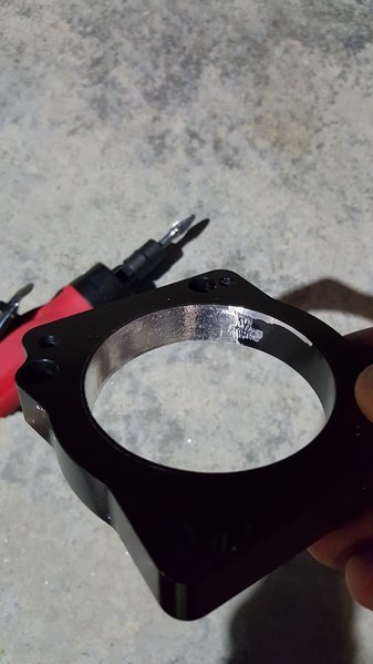

    The worst part of it is their customer service sucks... their response when I told them that it should be listed as a 68.5mm not a 70mm or have a note that it may require modifying which then you are aware! They told me "return it"... short and sweet after I paid almost $300 for a throttle body. 20160415_201240.jpg 20160415_204416.jpg

    So if you say you used a gasket material to make the gasket how was your adapter? You didn't notice it being smaller that the throttlebody? Did you see if there was room or how big the bore is on the intake manifold side?

    Ah, I see, to match the 70mm? How did you open up the bore on the adapter, sandpaper? If I don't get to it(busy week ahead for me), checking the stock bore would be relatively quick.

    The air router tool that you can see in this picture is what I used... it takes for ever! To get a even circle and take away material.
    Edit: yes, to match the 70mm

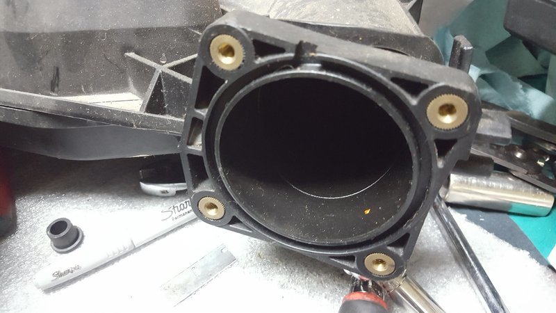

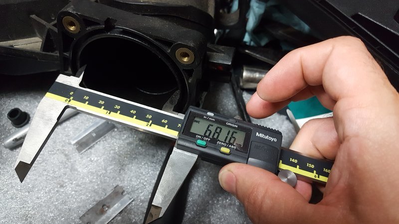

    I have a spare plenum laying around. I can measure it.

    68.16mm is the largest reading that I could achieve.

    Could you take a picture of the opening? I've been so busy and have no time to install the throttle body even though it seems like it's a pretty simple install

    Thanks for the pic! Looks like it would be hard to port match the plastic manifold much bigger... maybe 1mm at most

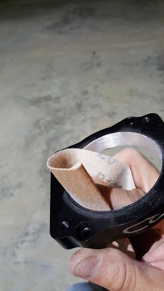

    So I finally installed the 70mm throttlebody, it took about 45 min considering I sanded the imside lip of the plastic intake manifold to match the bore of the spacer 20160430_150421.jpg 20160430_151114.jpg 20160430_151919.jpg 20160430_154556.jpg 20160430_154607.jpg
    The RTV silicon that you can see on the inside I ran my finger with the butterfly open to smooth it out.20160430_155225.jpg
