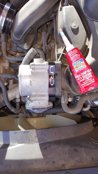

    Looks good, and smart choice with the silicone.

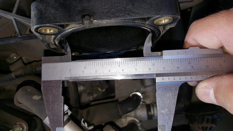

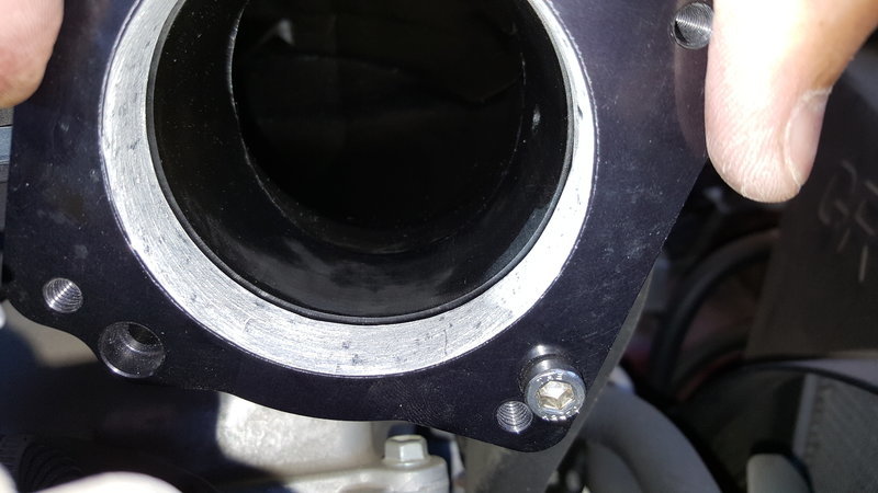

    Anyone have the bore measurement on the TRD SC inlet?

    There is in the URD thread, on XRU, in the vendor section.

    There has been at least one person to port match the spacer and the S/C inlet. On XRU.

    Smaller than 70mm, I think I opened mine up about 2mm all around.

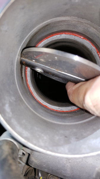

    I might have to try this! Obviously toss a rag inside to prevent chips and such?

    It.drives good, it seems to have a quicker throttle responce... and about the whole rag chat when opening up the intake /sc I made sure to count how many I put in and how many I took out! :) last thing you wanna do is forget one in there :)

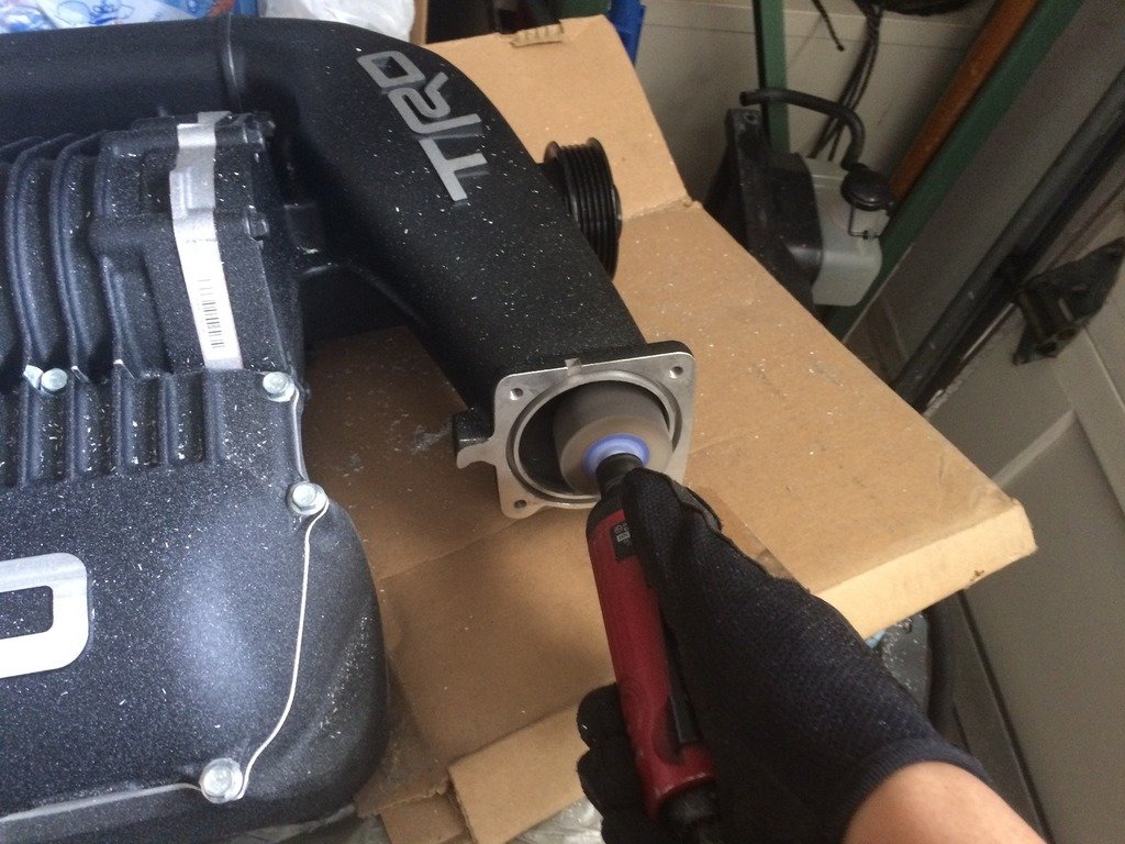

    I might have to try opening the intake manifold and the adapter.

    I feel a mod day coming up.

    What attachment is this for the dremel? Nothing I've got unless thats an air tool attachment?
