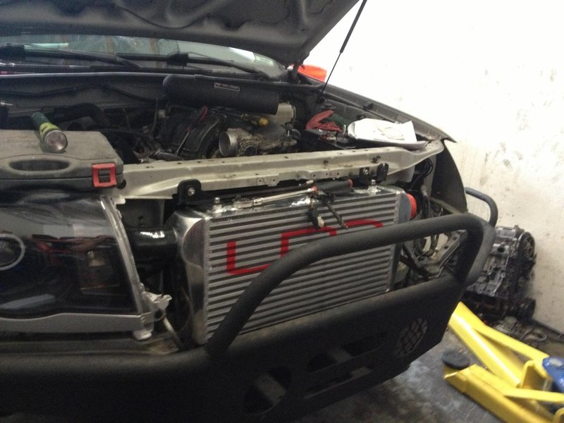

    Now its starting to look sexy.
    So cam gears went fairly easy, thermostat is a PITA (knuckle killers). The oil cooler didn't fit with the bumper so the mounting plate had to be modified. Im worried about the intercooler now not leaving enough room for the winch, guess i will find that out when i get a winch.

    well almost done, tried to start it and something is off. Done for the night. So tomorrow double chech the spark plug wires and if not that FML, gotta check the timing meaning its all gotta come off again.....yay, third time is the charm and with it being the third time i should have it down to 1 hour lol

    first start up... and it started right up. Need to finish the grill, and engine cover. I am scheduled for a tune and dyno next week so....we should see how it goes.

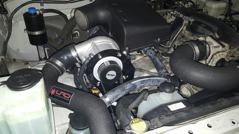

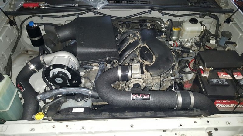

    Okay Guys so what do you want to know? I have had the SC now for 2 weeks, with a couple problems but nothing major.
    I installed a stage 1 kit, stock exhaust, 6spd, 33"
    I do throw a code 0300 every once in a while but it is not effecting the driving at all. The blow off valve is loud and can be obnoxious but if you have the recirculating hose attached( i don't) then its silent. The power is different then a TRD sc as it slow and builds with the pedal being floored. I don't hit 7 psi until 5500RPM. What i see nice about that is it helps with fuel consumption.
    The install was very time consuming, 15 hours for 2 of us. The directions arent clear on alot but with the google you can figure it out. Some directions aren't even included so you have to wing it.
    I haven't gone off-roading or towed yet which i will be doing both this upcoming weekend, so i will update this after.
