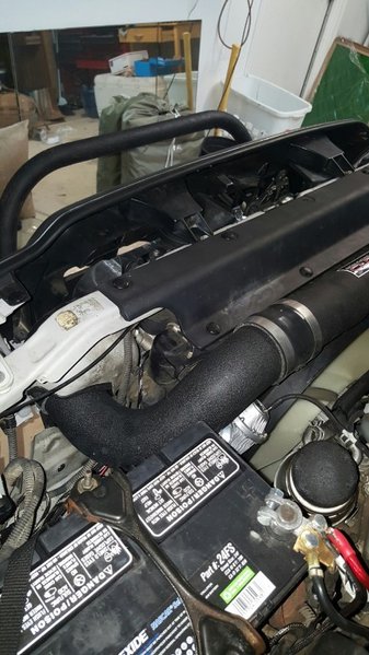

    I should've elaborated if all the metal on top of that battery comes together it will be a hell of a light show. Happy now. I said it because that battery is a very tempting tool tray. I had a friend place a wrench on the terminals of a 24 volt system. The sparks were 3 feet tall. The memory of that keeps me from placing tools on that dam tempting battery

    Turbo'd my VW VR6 and had to make sure it was recirc'd otherwise it ran rich and fouled up the plugs etc etc. Recircing will help reduce the noise of the BOV/diverter valve

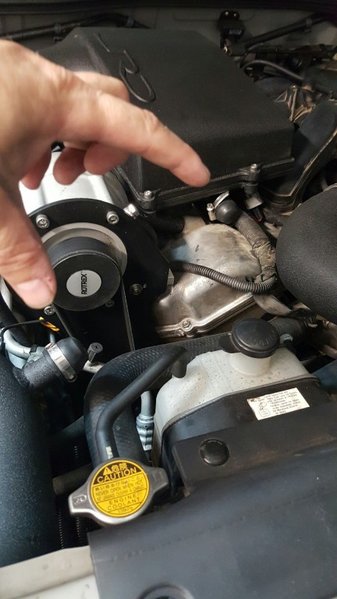

    My fingers are pointing at the hose i remover(and will put back lol)
    Do yuo see the bov Rock Lobster, just above the battery

    That looks to be the crankcase line that's vents back to the intake. Some guys put catch cans inline to keep oil sludge from entering into the intake. Did any of the lines you removed come from the BOV?
