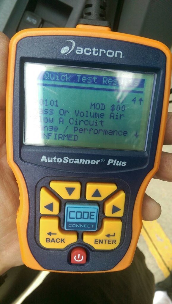

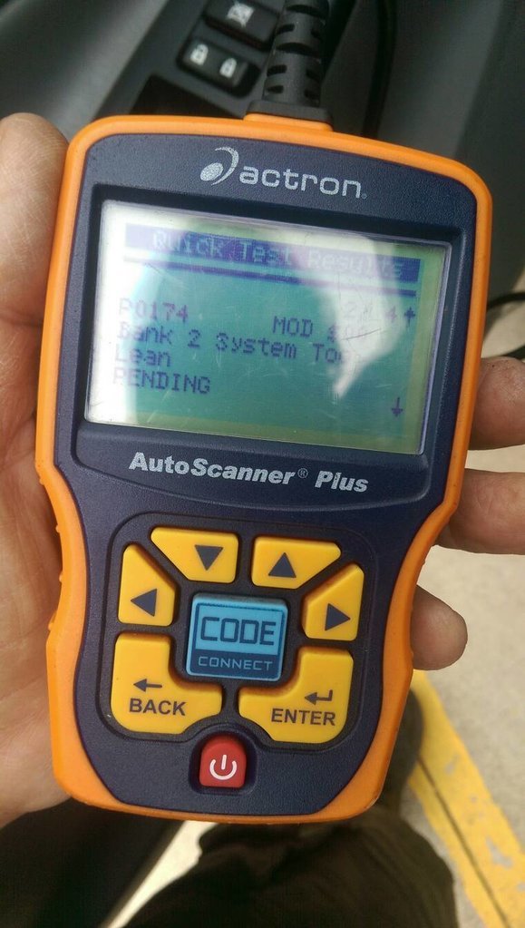

    Got the codes,p0101 and p0174, saying it's running lean

  8. Dec 26, 2014 at 12:54 PM

    The 174 code is pending, so its not turning on the light. Already mentioned to check the maf seal, could also be the sensor itself. I also assume that you have checked all the tubing seals.
